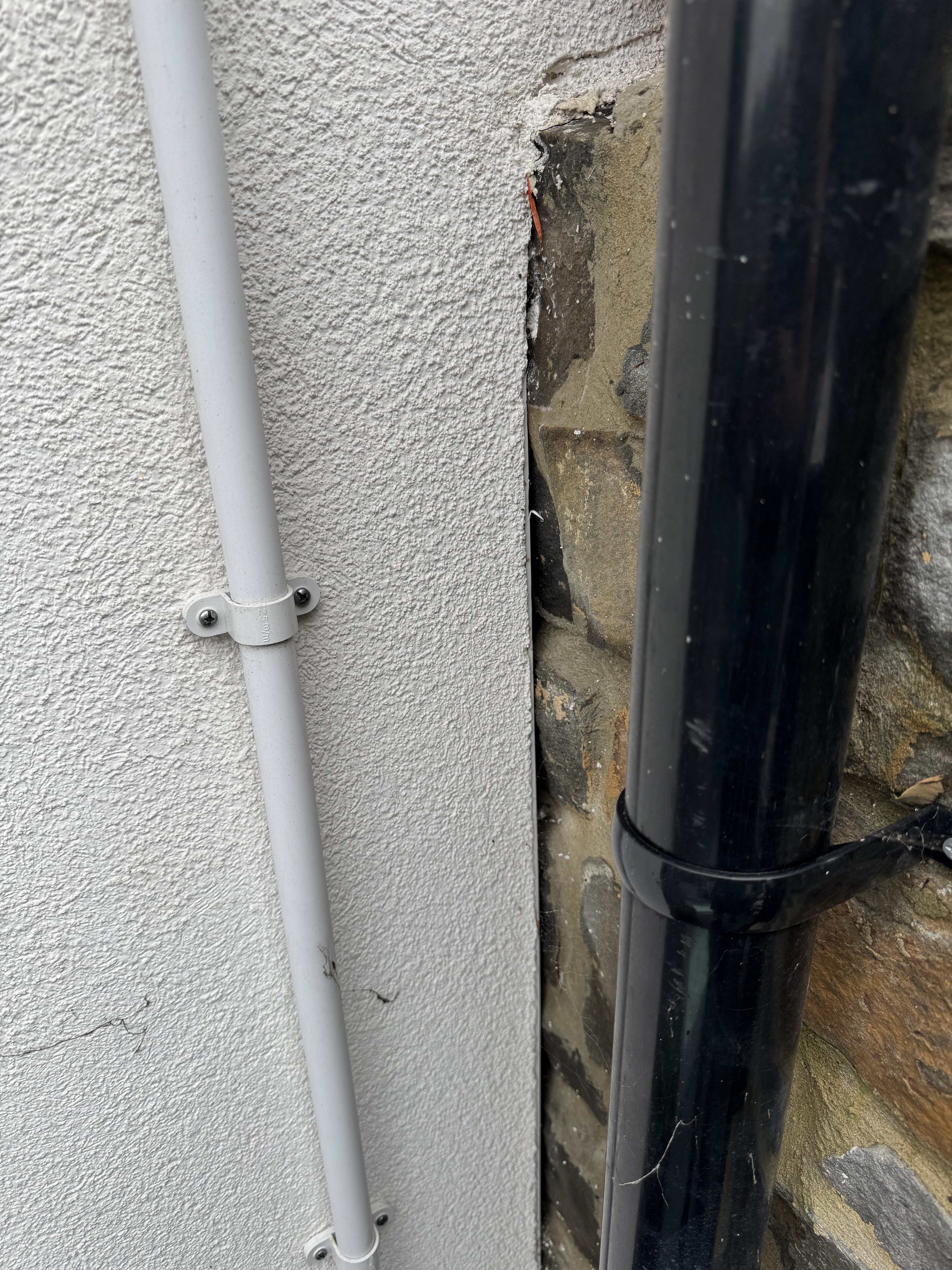

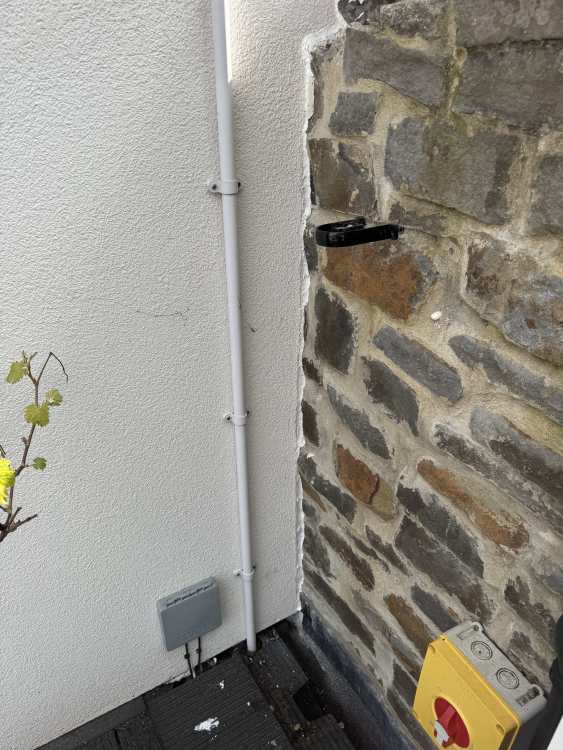

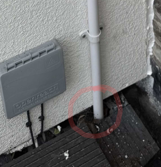

Pocster Posted April 18, 2025 Author Posted April 18, 2025 (edited) Found something ! This gap - between the white render board and the stone . Pissed the hose over this gap and …. It leaked ! Not sure if there’s an issue at the base but certainly on this gap . Fill with what though ? Expanding foam ???? expanding foam tape ? Too wide and deep for ct1 / silicone sealant I think . Edited April 18, 2025 by Pocster
Mr Punter Posted April 18, 2025 Posted April 18, 2025 If the gap is deep, push in some foam backer rod so it is set back about 10mm, then use a joint sealant like Sikaflex EBT+ from a mastic gun. You will need to mask the stonework. It isn't the easiest to finish but does a good job and stays flexible. 1
Pocster Posted April 18, 2025 Author Posted April 18, 2025 43 minutes ago, Mr Punter said: If the gap is deep, push in some foam backer rod so it is set back about 10mm, then use a joint sealant like Sikaflex EBT+ from a mastic gun. You will need to mask the stonework. It isn't the easiest to finish but does a good job and stays flexible. How do I mask the stone ? What tape sticks to it ???
Mr Punter Posted April 18, 2025 Posted April 18, 2025 Anything that sticks will do. Masking tape, gaffa tape. Just to stop getting mastic on the stone as it is difficult to clean off.
Pocster Posted April 18, 2025 Author Posted April 18, 2025 19 minutes ago, Mr Punter said: Anything that sticks will do. Masking tape, gaffa tape. Just to stop getting mastic on the stone as it is difficult to clean off. I always have difficulty sticking to stone . I’ll get ebt + clear so less visual mess 👍
Onoff Posted April 18, 2025 Posted April 18, 2025 You can use grey foam pipe insulation slit lengthways if you don't have any foam backer rod. No Nonsense silicone remover works well if you do get any on the bricks. You could...underfill the gap with Illbrück FM330 then silicone over. 1

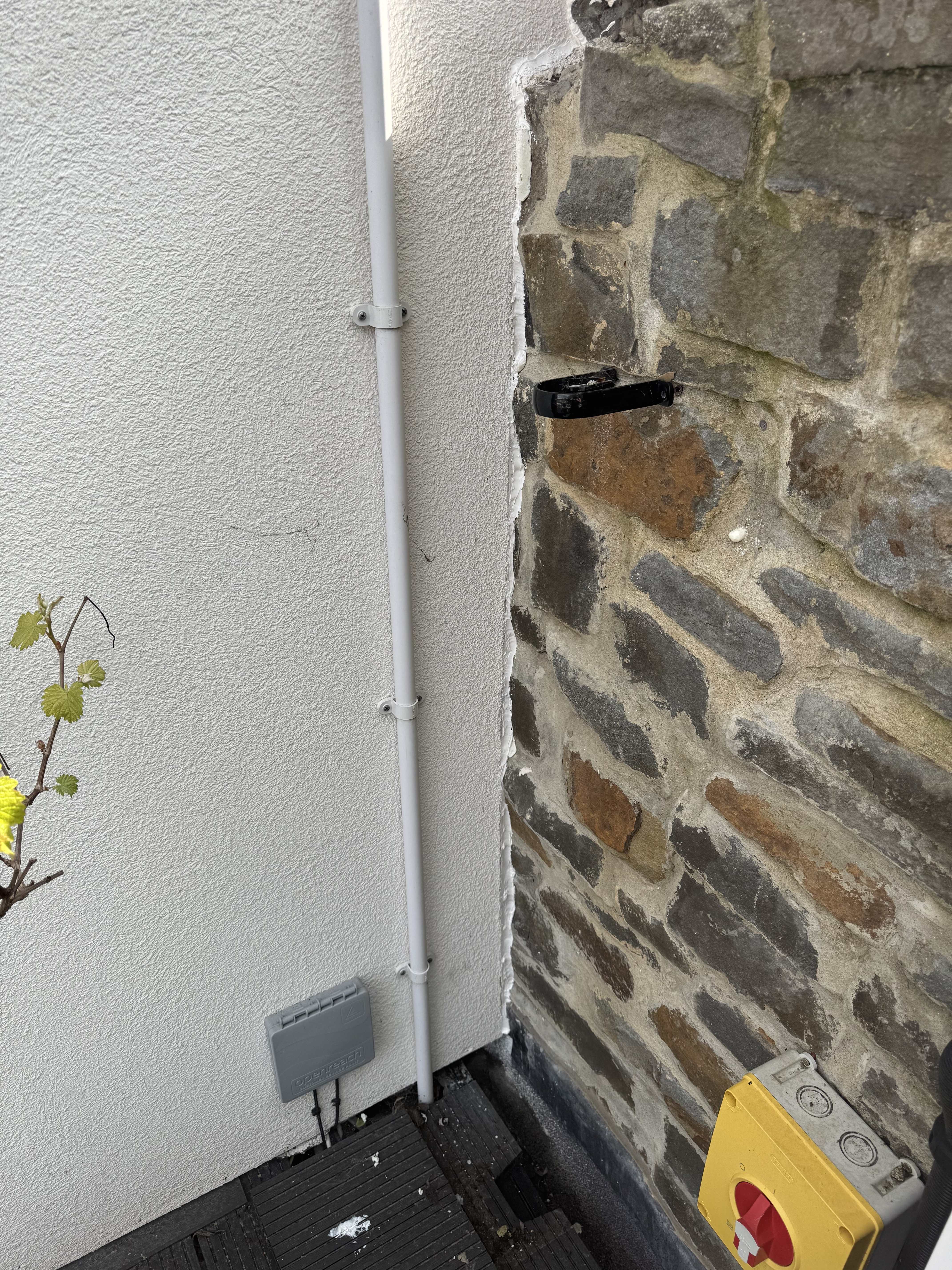

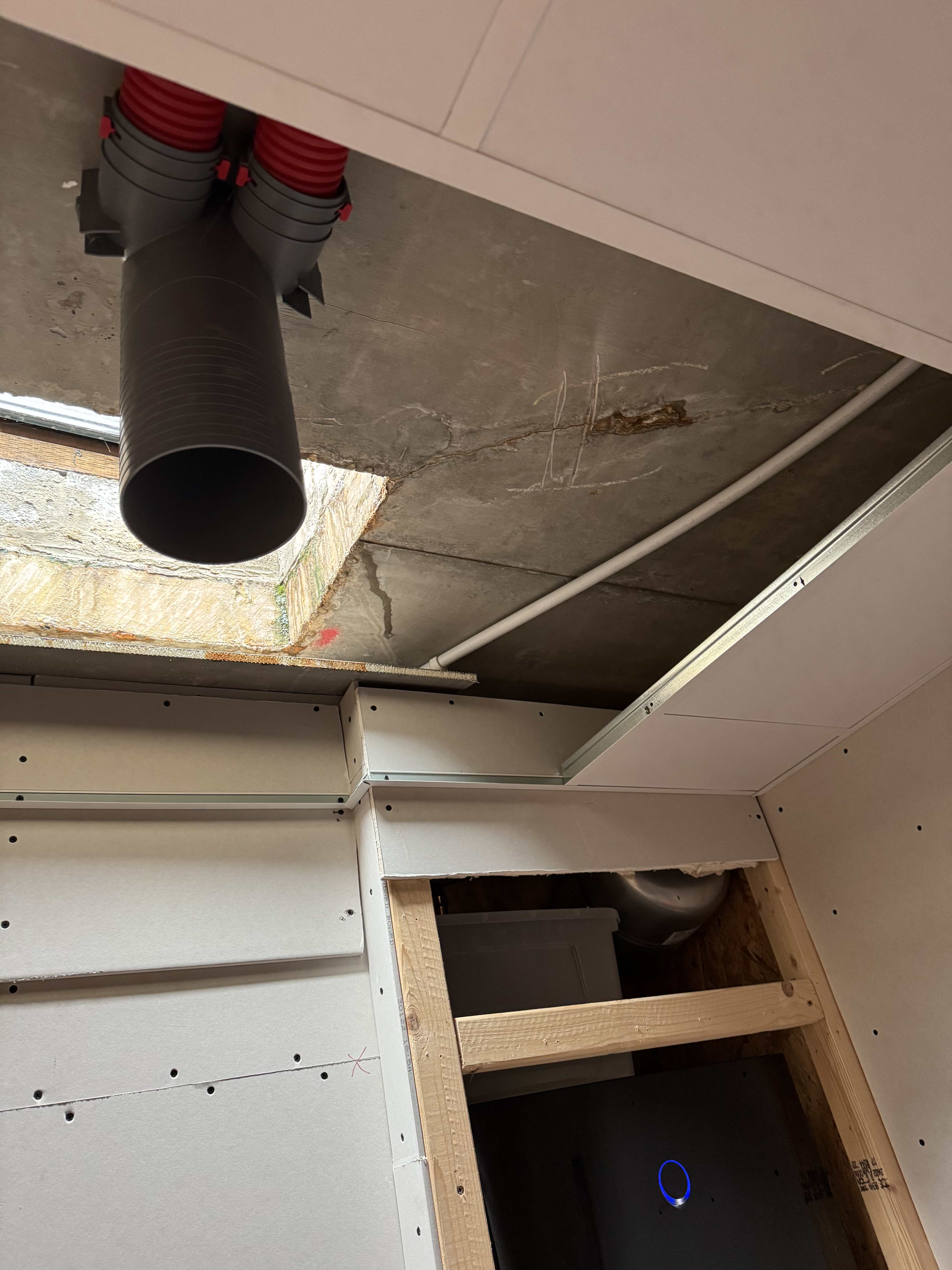

Pocster Posted April 23, 2025 Author Posted April 23, 2025 (edited) I swear water has intelligence. It’s found new paths so it can find nice virgin parts of the kitchen ceiling to spoil . Everything has now arrived to attempt that corner fix outside - just need a dry day . Edited April 23, 2025 by Pocster
Mr Punter Posted April 23, 2025 Posted April 23, 2025 Basements really can be a huge challenge. The more underground, the more problematic. 1
Pocster Posted April 23, 2025 Author Posted April 23, 2025 4 minutes ago, Mr Punter said: Basements really can be a huge challenge. The more underground, the more problematic. Couldn’t agree more ! I’m relatively confident that corner is the source of all my woes . Weather tomorrow looks ok - so might attempt the fix then

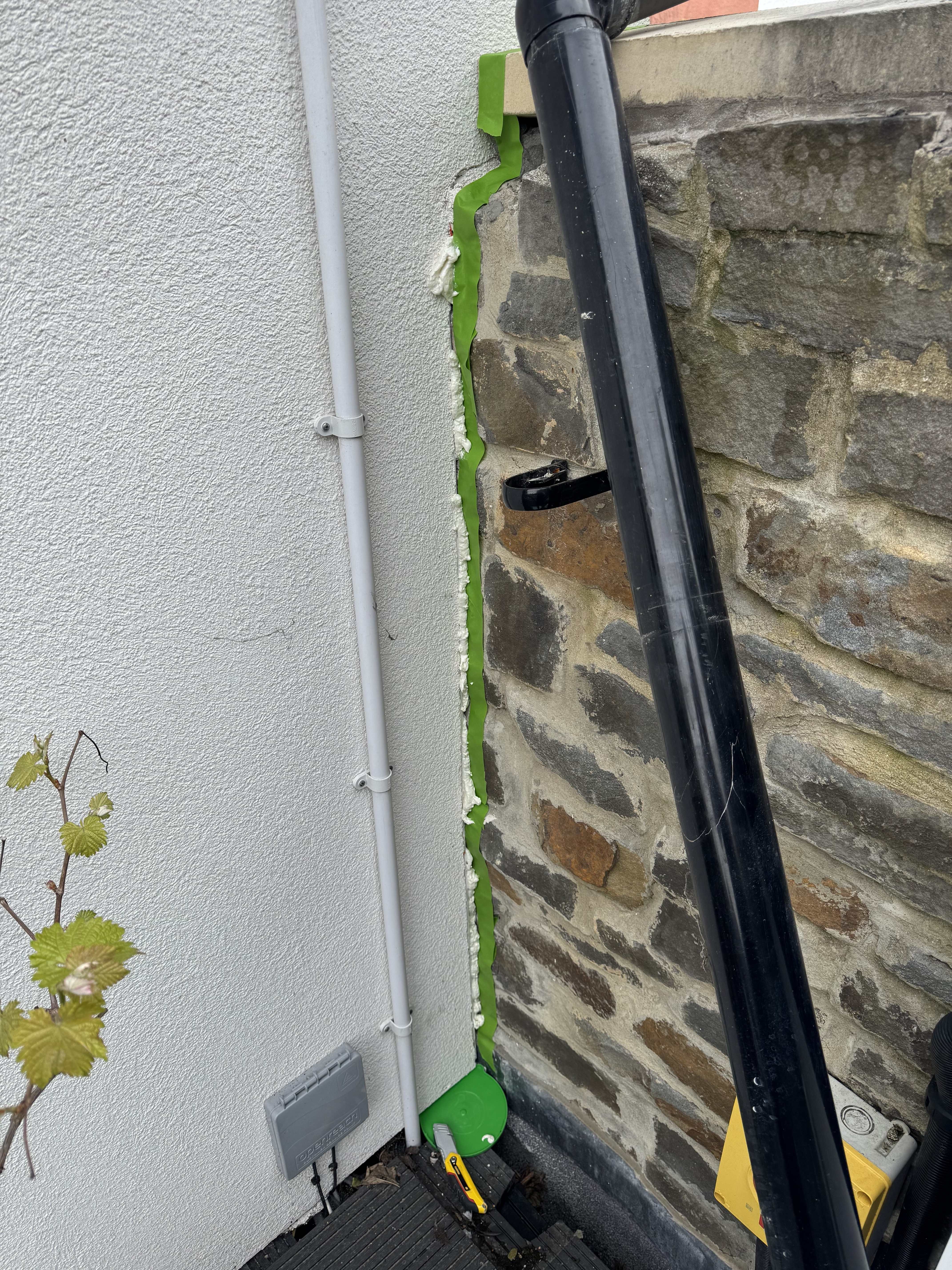

Pocster Posted April 24, 2025 Author Posted April 24, 2025 (edited) Gave up with the gap filler strip - no way it will stay in . So will foam then gouge it back once cured ready to fill properly tomorrow Edited April 24, 2025 by Pocster
Onoff Posted April 24, 2025 Posted April 24, 2025 4 hours ago, Pocster said: no way it will stay in 😉
Pocster Posted April 24, 2025 Author Posted April 24, 2025 Well @Mr Punter you were right ; it won’t exactly form a neat job ! . But if it stops the leak cosmetics can be applied later I.e some trim over it . I’ll leave it until Sunday then will hose the hell out of that corner

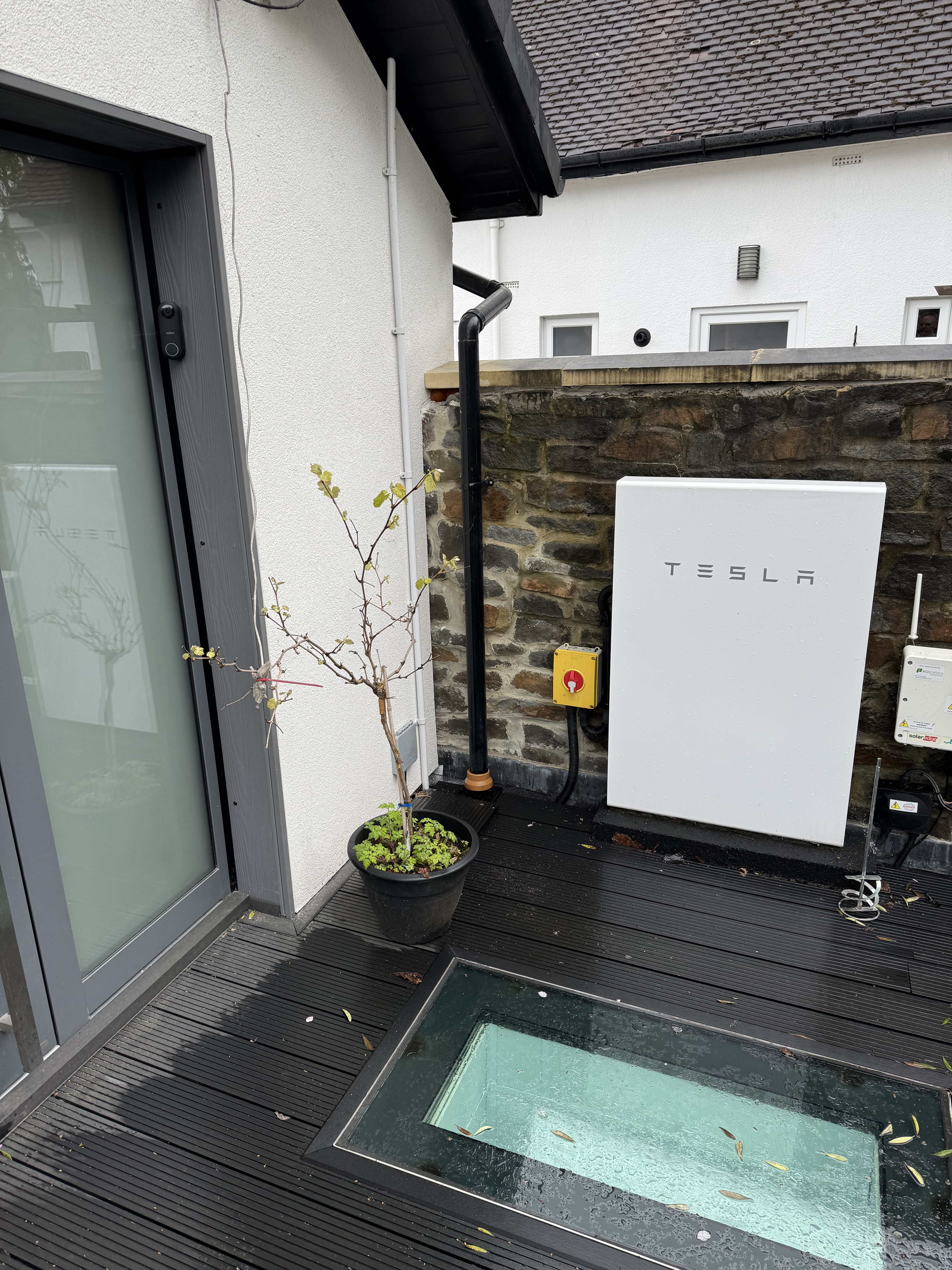

ToughButterCup Posted April 25, 2025 Posted April 25, 2025 @Pocster, Just in case you haven't. ... ? 1
Pocster Posted April 25, 2025 Author Posted April 25, 2025 (edited) 3 hours ago, ToughButterCup said: @Pocster, Just in case you haven't. ... ? lol . That trunking is just the pv cable running down that side . Going a long the roof ( doesn’t penetrate it ) under the decking to the otherside of the build . But appreciate it looks like a potentially water filled pipe or something Edited April 25, 2025 by Pocster 1

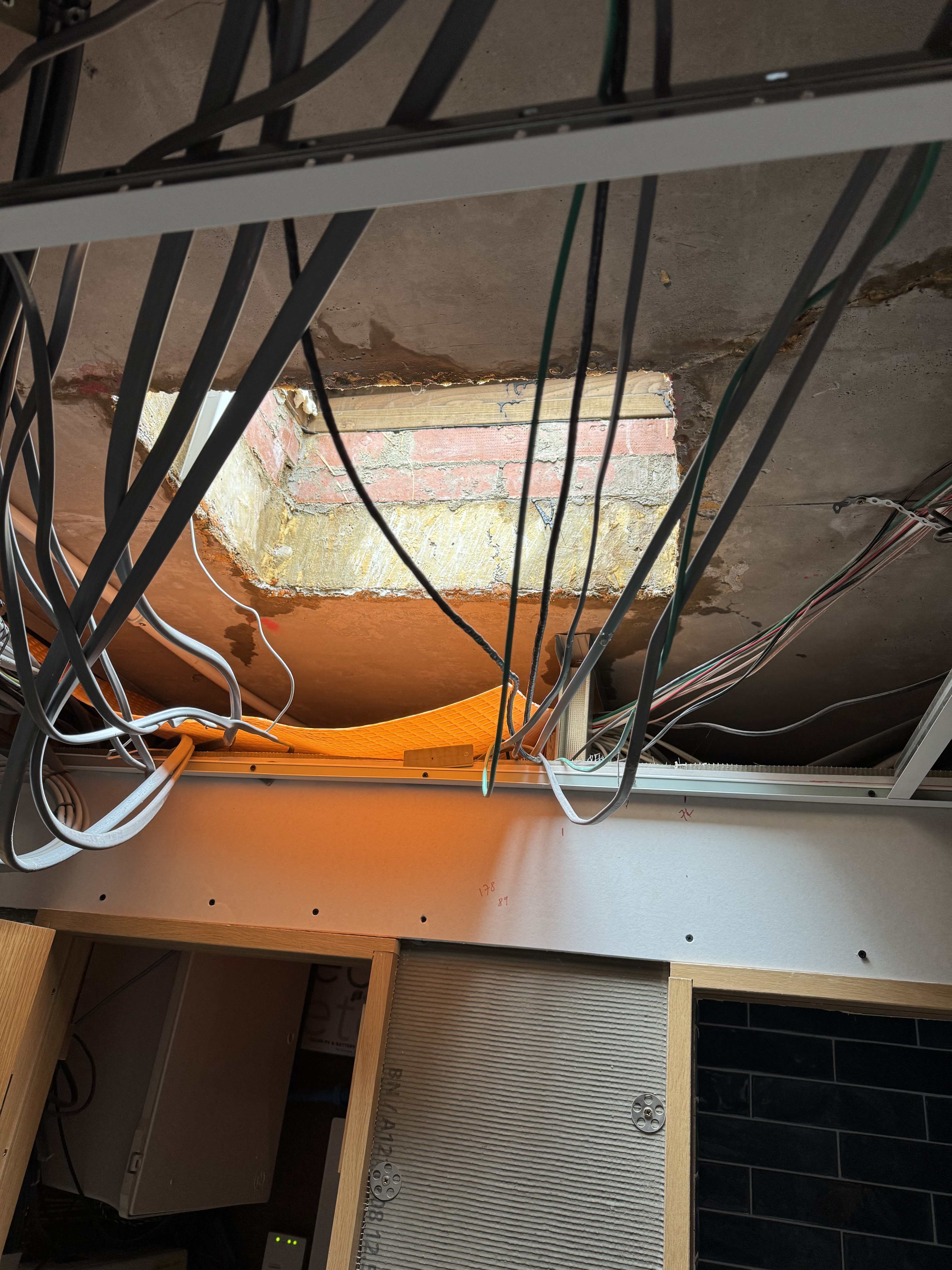

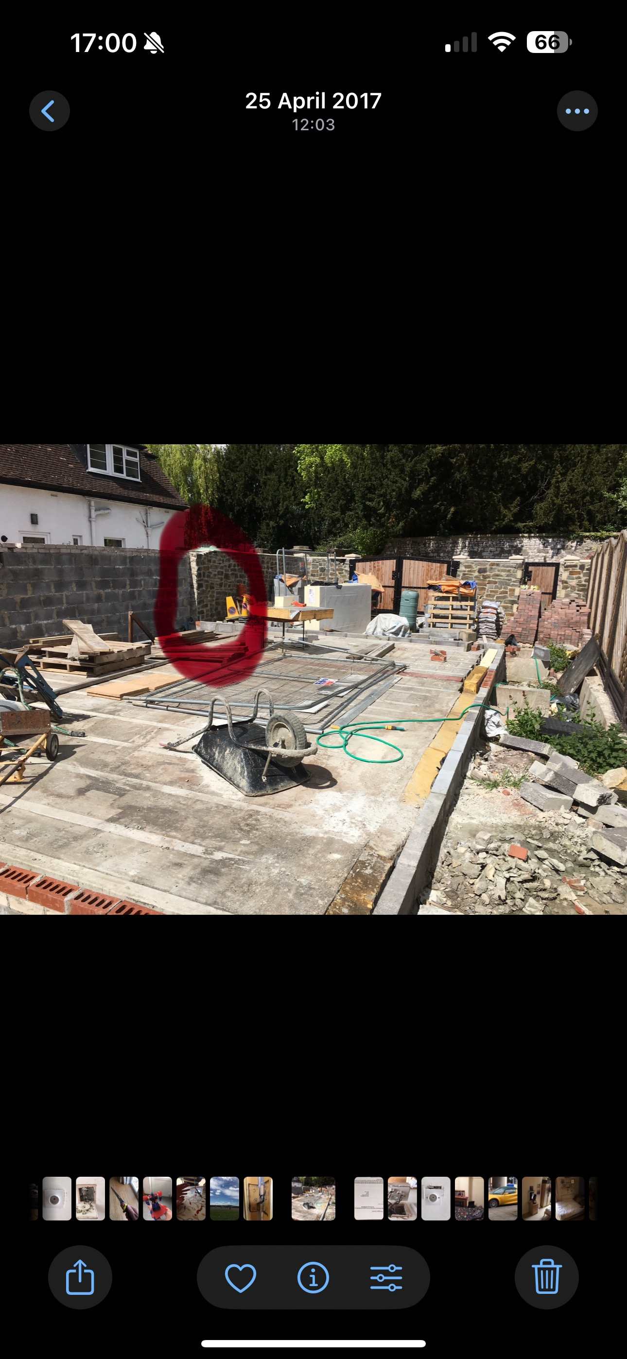

Pocster Posted April 25, 2025 Author Posted April 25, 2025 Found this old photo . Hard to tell zoomed in what’s going on - no idea if I left it like this or finished it somehow . Looks interesting at the bottom , can see plastic membrane and a hole ( ??? )
