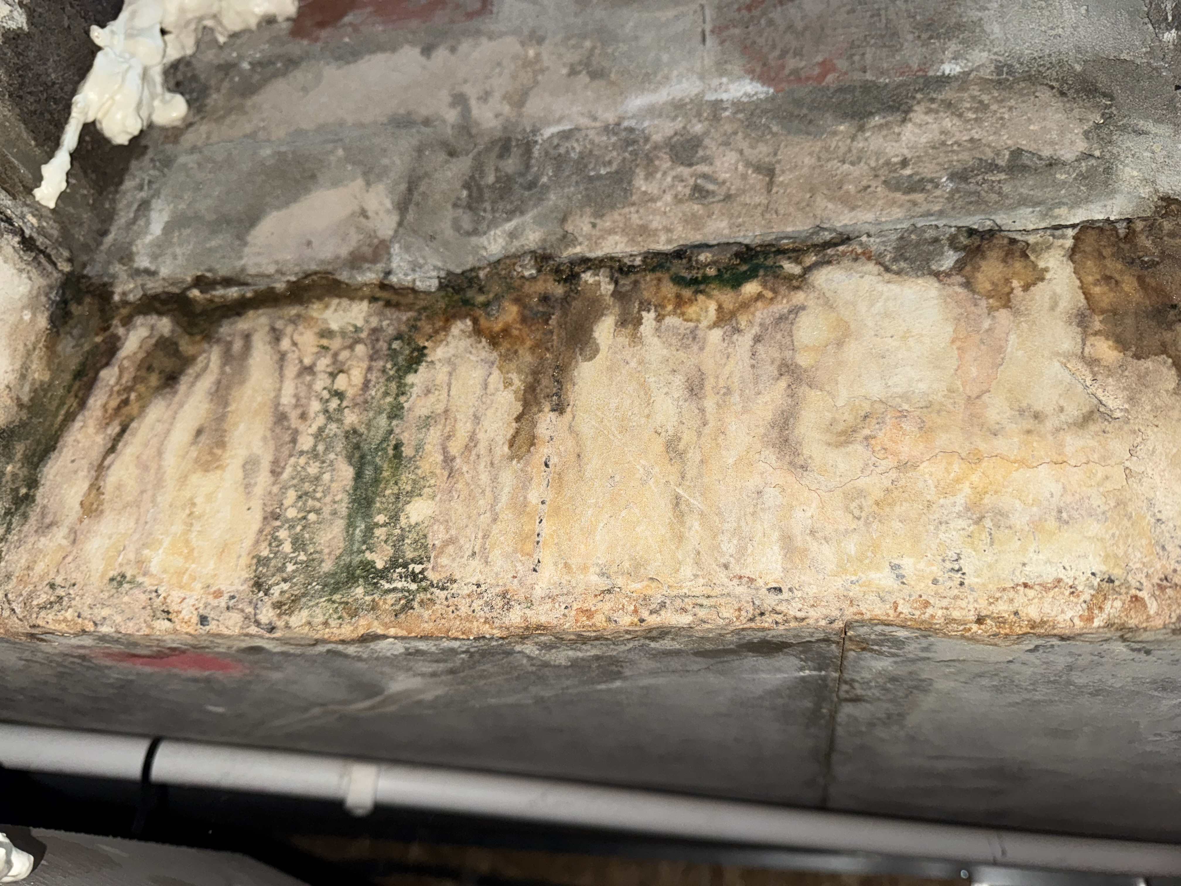

Pocster Posted November 14, 2025 Author Posted November 14, 2025 Entire day of rain - storm so lots of rain . 15:30 - finally get a drop through . You can see it’s been building up to that . I’m going to leave this as is until spring . But if I were to seal the concrete I.e to prevent water coming through what would I use? . I guess I should be happy as gone from half a bucket to just this .

Onoff Posted November 15, 2025 Posted November 15, 2025 15 hours ago, Pocster said: Entire day of rain - storm so lots of rain . 15:30 - finally get a drop through . You can see it’s been building up to that . I’m going to leave this as is until spring . But if I were to seal the concrete I.e to prevent water coming through what would I use? . I guess I should be happy as gone from half a bucket to just this . I would clean that up with a bleach solution and scrubbing brush then apply shower tanking paint and see what happens. 1
Pocster Posted November 15, 2025 Author Posted November 15, 2025 3 hours ago, Onoff said: I would clean that up with a bleach solution and scrubbing brush then apply shower tanking paint and see what happens. Hairline cracks in the concrete also I want to fill . Did assume some concrete / brick sealer waterproofing was the thing to try . So a small number of drops did get the floor . Didn’t put a bucket to collect . But it is a small amount . Just checked it now - whilst not dry it’s clearly drying out . Considering how much rain we had and how quick it’s drying does kind of confirm it certainly isn’t a lot of water .

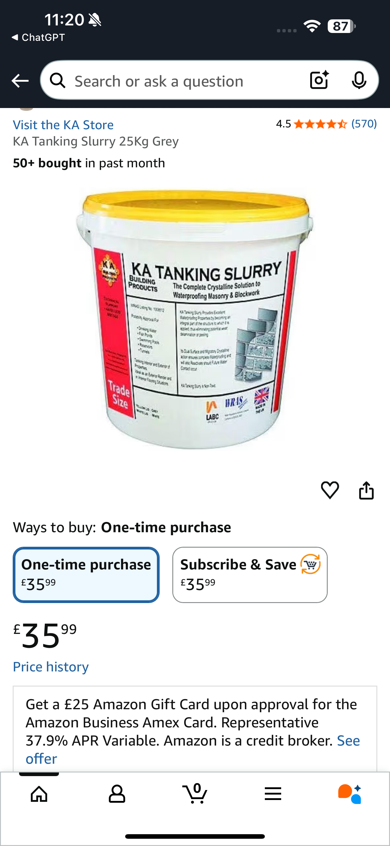

Pocster Posted November 15, 2025 Author Posted November 15, 2025 (edited) Chat suggests sika 1 waterproofing Or this Edited November 15, 2025 by Pocster
Pocster Posted November 15, 2025 Author Posted November 15, 2025 (edited) Chat suggests . Clean it all up . Ct1 the joints I.e block work on the concrete - water gets through the mortar at this point . Then ka slurry the lot . Edited November 15, 2025 by Pocster

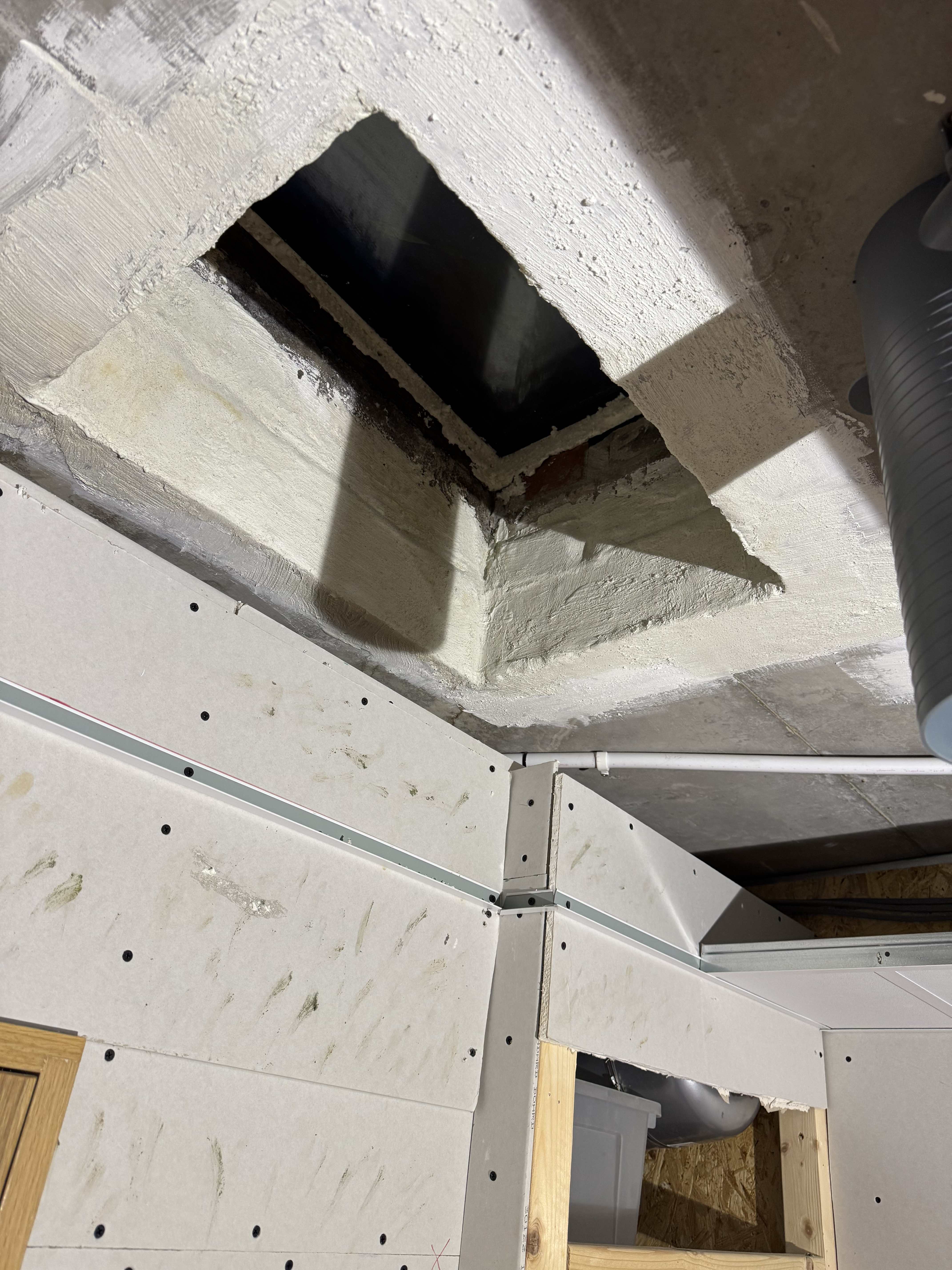

scottishjohn Posted November 17, 2025 Posted November 17, 2025 On 15/11/2025 at 11:34, Pocster said: Chat suggests . Clean it all up . Ct1 the joints I.e block work on the concrete - water gets through the mortar at this point . Then ka slurry the lot . I had a similar but larger problem when trying to control the water leaks on my firepond there was pressure as well with my leaks in the 5 meter wall behind the pond and a constant flow it was a sika _plugging fast setting cement mix it up and you got 5mins to get it on -so small areas at a time and can be use under water if you press it hard onto the leak took me 2 days frigging about to gat all the leaks plugged but it worked mix it up till its like sloppy putty --then GO I even used it on my water course --old water supply made from stones just laid on each other problem was it was leaking too much from the stone culvert and coming outanywhere it like where it went through the wall and not where I wanted it contained in the stone work imagine a stone culvert coming to a dry stone dyke and trying to get all going where you wanted on the other side --then you will get the picture did not matter with original set up as all the leaks ended up in the open collector at other side of wall , but as i was piping it in 300m twin wall all the way down to firepond 8mm drop and 20m downhill to where it meets the wall above the firepond I did not want it to form another stream under the piping and end up with the wall collapsing as it had done in the past - not a problem then as it made its way into the stone culvert which heads off across my courtyard and down the 95m drop into the quarry that stone culvert I replaced with more 300mm twin wall problem sloved but alot of frigging about 1
scottishjohn Posted November 17, 2025 Posted November 17, 2025 On 15/11/2025 at 11:34, Pocster said: Chat suggests . Clean it all up . Ct1 the joints I.e block work on the concrete - water gets through the mortar at this point . Then ka slurry the lot . I would not use CT! --just use the wate plugging cement even on damp surfaces 1
Pocster Posted November 17, 2025 Author Posted November 17, 2025 1 hour ago, scottishjohn said: I would not use CT! --just use the wate plugging cement even on damp surfaces Chat has now changed its mind 🙄 . Won’t bother with ct1 . Simply tanking slurry over the lot . There are no gaps it’s just porous material.

Pocster Posted November 30, 2025 Author Posted November 30, 2025 3 minutes ago, Onoff said: Any post tanking update? Nothing to report sir 1
Pocster Posted December 1, 2025 Author Posted December 1, 2025 I still check 10 times a day and probably will forever 🤣🤣🤣
Pocster Posted December 3, 2025 Author Posted December 3, 2025 On 01/12/2025 at 19:57, Onoff said: So the tanking appears to have worked? So far ….. 2
