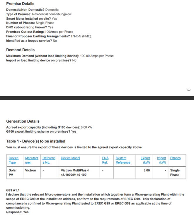

Inverter can be G100 compliant, here is a document from Victron about it. I have installed pretty much everything already. DNO has been notified, they just keep dragging their feet.
That's a G100 concept doc. Have you checked the ENA type test register for a compliance cert as a previous post reckoned Victron weren't going through certification??
Is it a G99 application you made to your DNO rather than a "notification"?
Great news, I've just got approval today from DNO and we have the 8kw approved. We used the document I mentioned earlier. Yay!
it was an application
