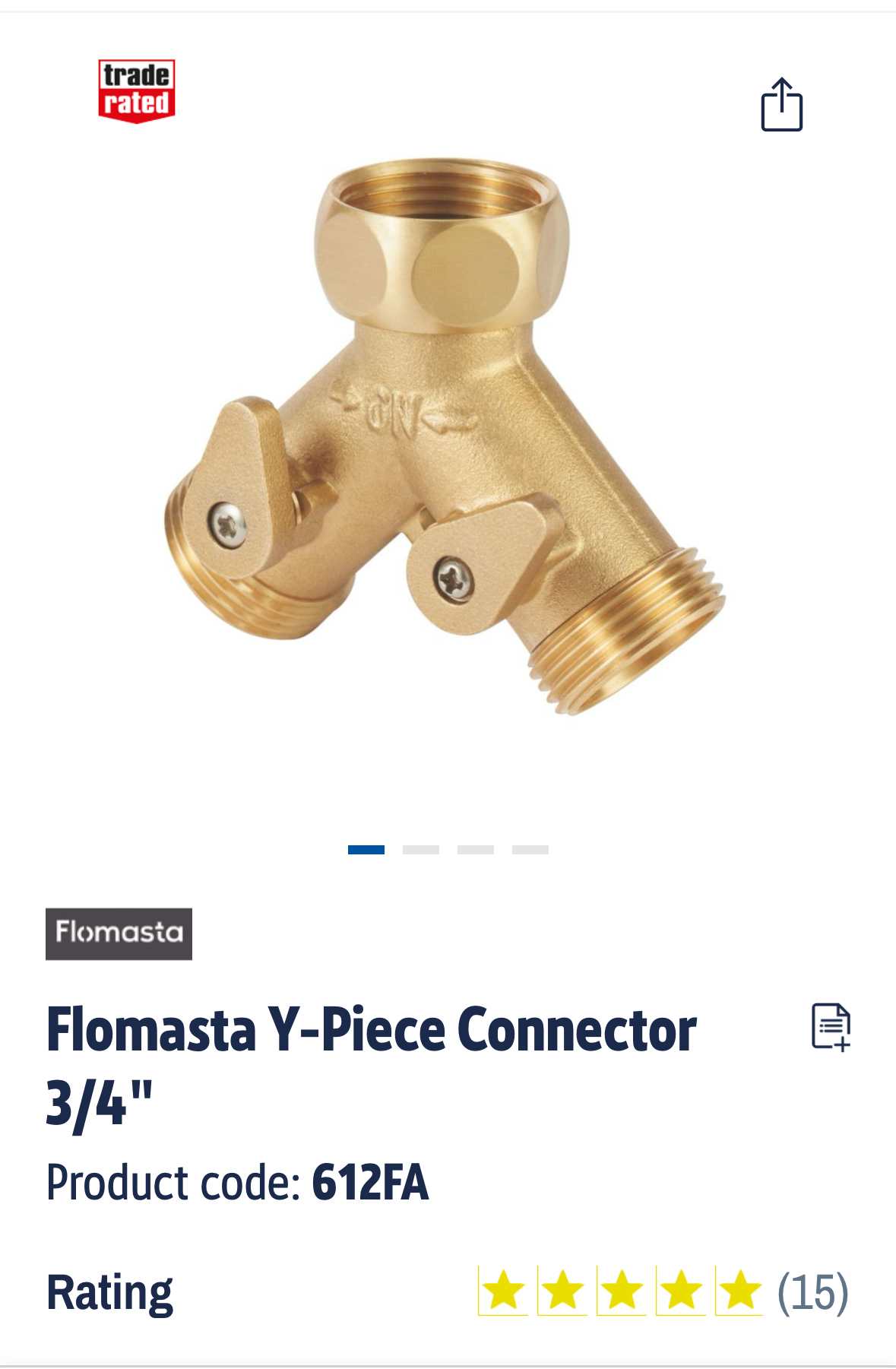

Nickfromwales Posted March 25, 2025 Posted March 25, 2025 You have some sort of up stand / outside tap? If so, now the weathers broken, you can just run 15mm push-fit pipe to that for potable water. Baby Belling cooker and a microwave, with a bit of worktop with a sink in it for wash up, and slide the washing machine under the side of that for some clean trolleys. 👍. 1

MortarThePoint Posted March 25, 2025 Author Posted March 25, 2025 1 minute ago, Nickfromwales said: You have some sort of up stand / outside tap? I have an upstand about 20m from the house but it is on the same meter as the house at the front
Nickfromwales Posted March 25, 2025 Posted March 25, 2025 16 minutes ago, MortarThePoint said: I have an upstand about 20m from the house but it is on the same meter as the house at the front Which you don’t own? Buy a cheap water meter and pay for what you use?
MortarThePoint Posted March 25, 2025 Author Posted March 25, 2025 17 minutes ago, Nickfromwales said: Which you don’t own? Buy a cheap water meter and pay for what you use? We do own the house at the front and it is where we are living at the moment (cramped etc). A 'bodged' water supply is easy though (I don't mean that rudely) 1
Nickfromwales Posted March 25, 2025 Posted March 25, 2025 5 minutes ago, MortarThePoint said: We do own the house at the front and it is where we are living at the moment (cramped etc). A 'bodged' water supply is easy though (I don't mean that rudely) Whack a tap connector on, waters solved, move on to next problem 👍
