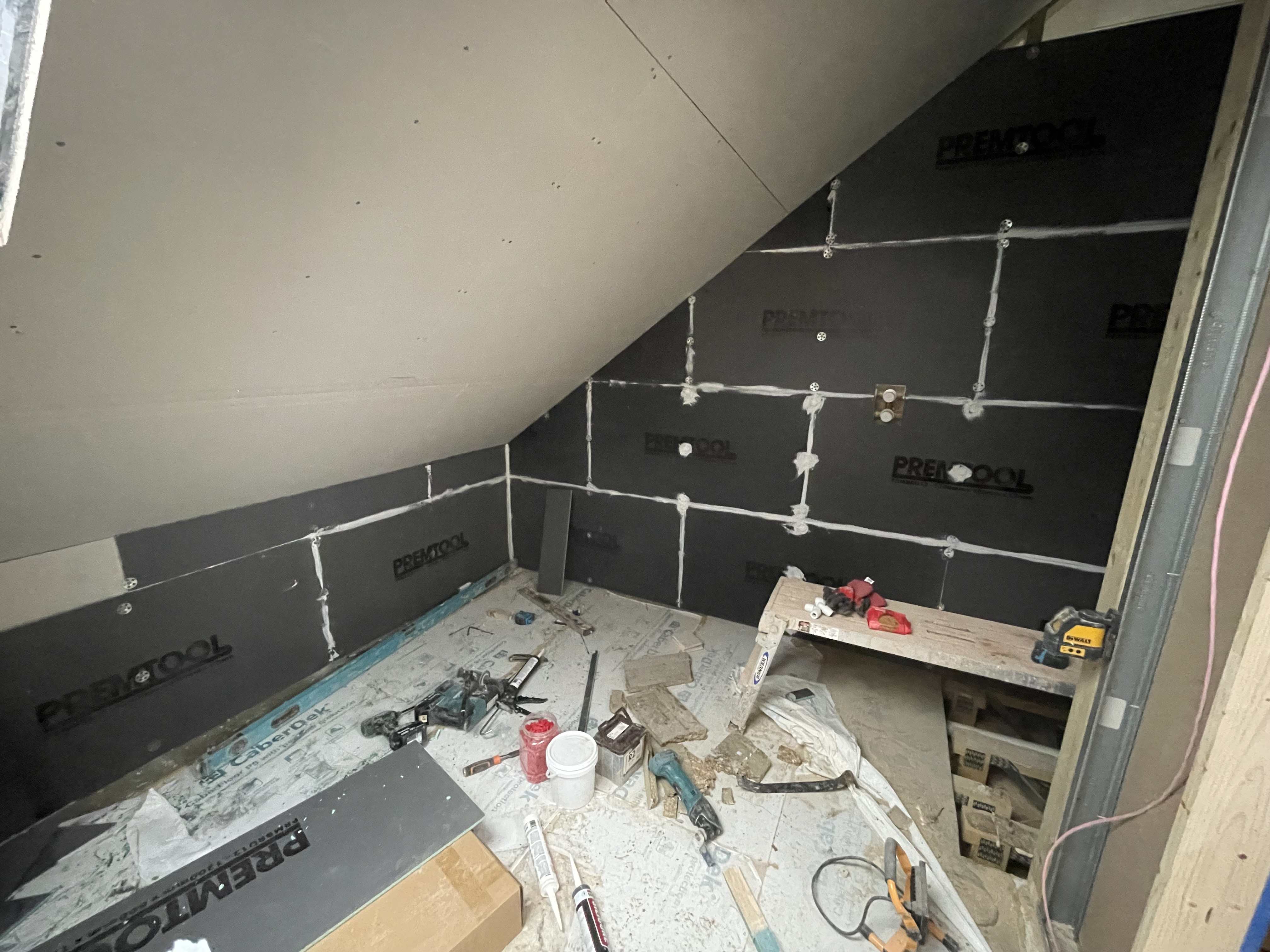

I’ve looked into this quite a bit and decided to go for premtool 12mm tile backer boards. I worked out the following;
prices inclusive of vat
Plasterboard: £4.5/m2
paintable tanking £10/m2
impey water guard £21/m2
hardie backer: £13/m2
Tile backer: £12.5/m2
both the PB and the hardie backer should be tanked, the tile backer is already waterproof and just needs the joints sealing with CT1 or similar.
i therefore believe, for a tanked wetroom, tile backer board is the cheapest option.
furthermore, plasterboard can only take up to 32kg/m2 (or thereabouts) which is right on the limit for a 10mm marble, the tile backer board is good for 120kg/m2 and the cement board 200kg/m2.
I could have gone cement board (I did at the last place), but they’re heavier, messier, and still need tanking, therefore slower to install and more expensive.
modern xps filled tile backer board seemed to me like a no brainer.
I liked the look of the impey waterguard self adhesive waterproof sheet (and decoupling membrane), but so expensive, the only people that use this must be limited by buildup height.
Ive gone tile backer wall and floor onto 22mm p5 caberdeck
I should add, the cost of the sealant between the tile backer boards is working out about a tube every 10 boards (7.2m2). £10/7.2m2 =£1.389/m². I’m using board fix by jackoboard.
you should also throw in some waterproof corners £5 a pop and a tub of insulation washers £30 for 500 (should do about 50 boards or 36m2)

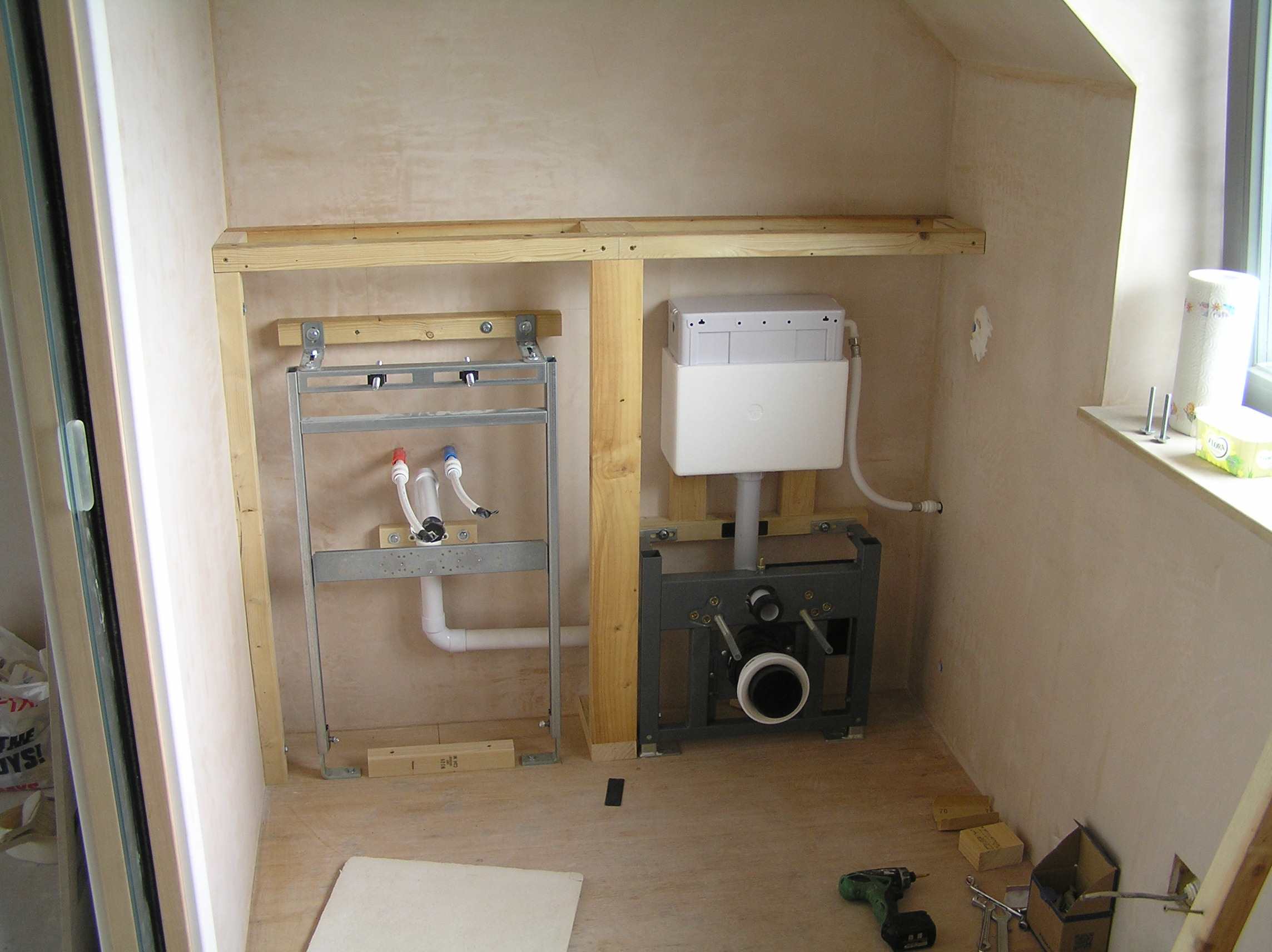

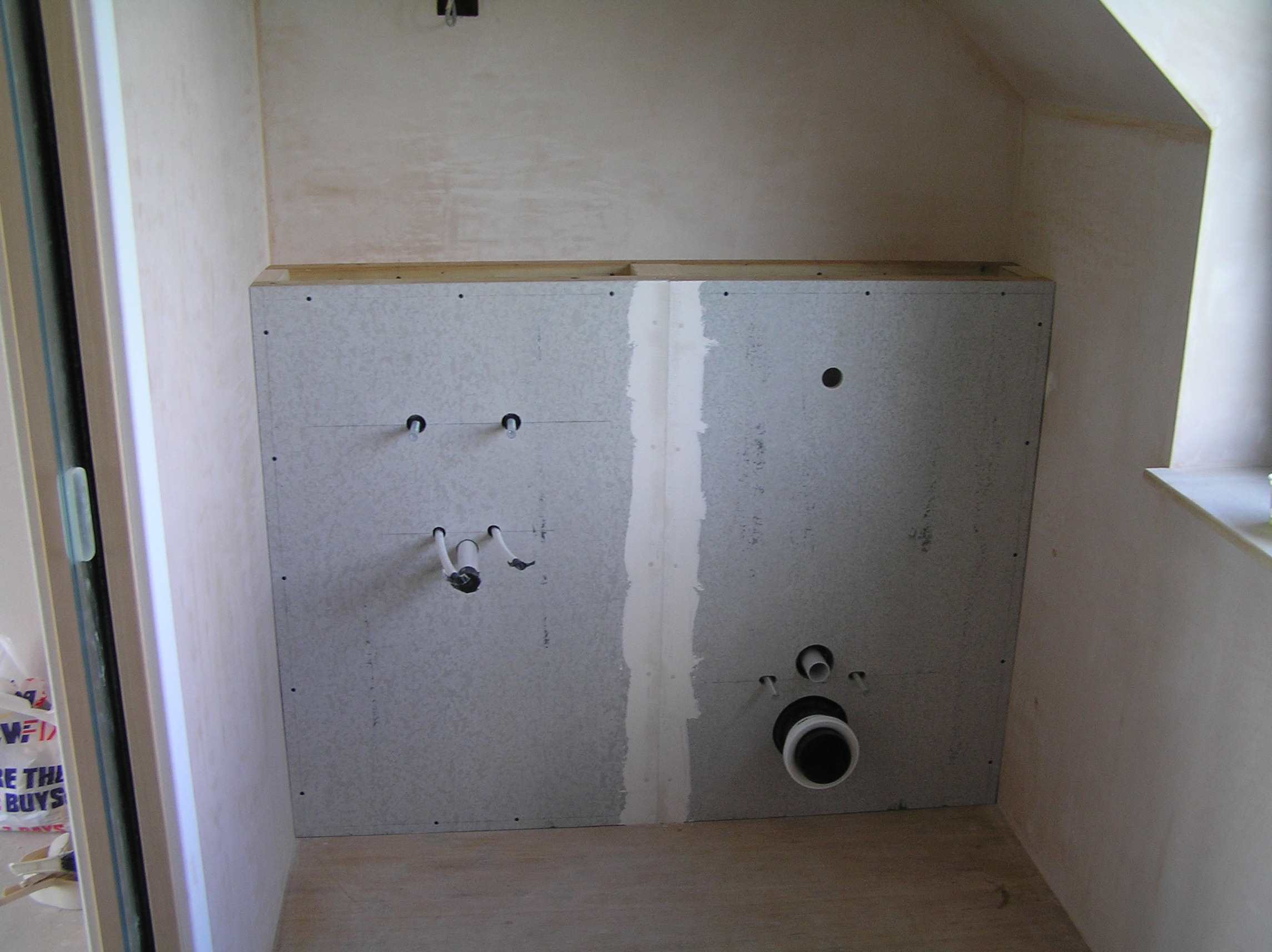

Thanks @Temp I had been wondering about STs fibre cement boards, because of my wall-hung (that was what I meant earlier) toilet which can obviously put a terrific amount of force onto the backer board so cannot have any flex...I will be doing a low profile shower tray as well, just can't really see that much point in full wet rooms.

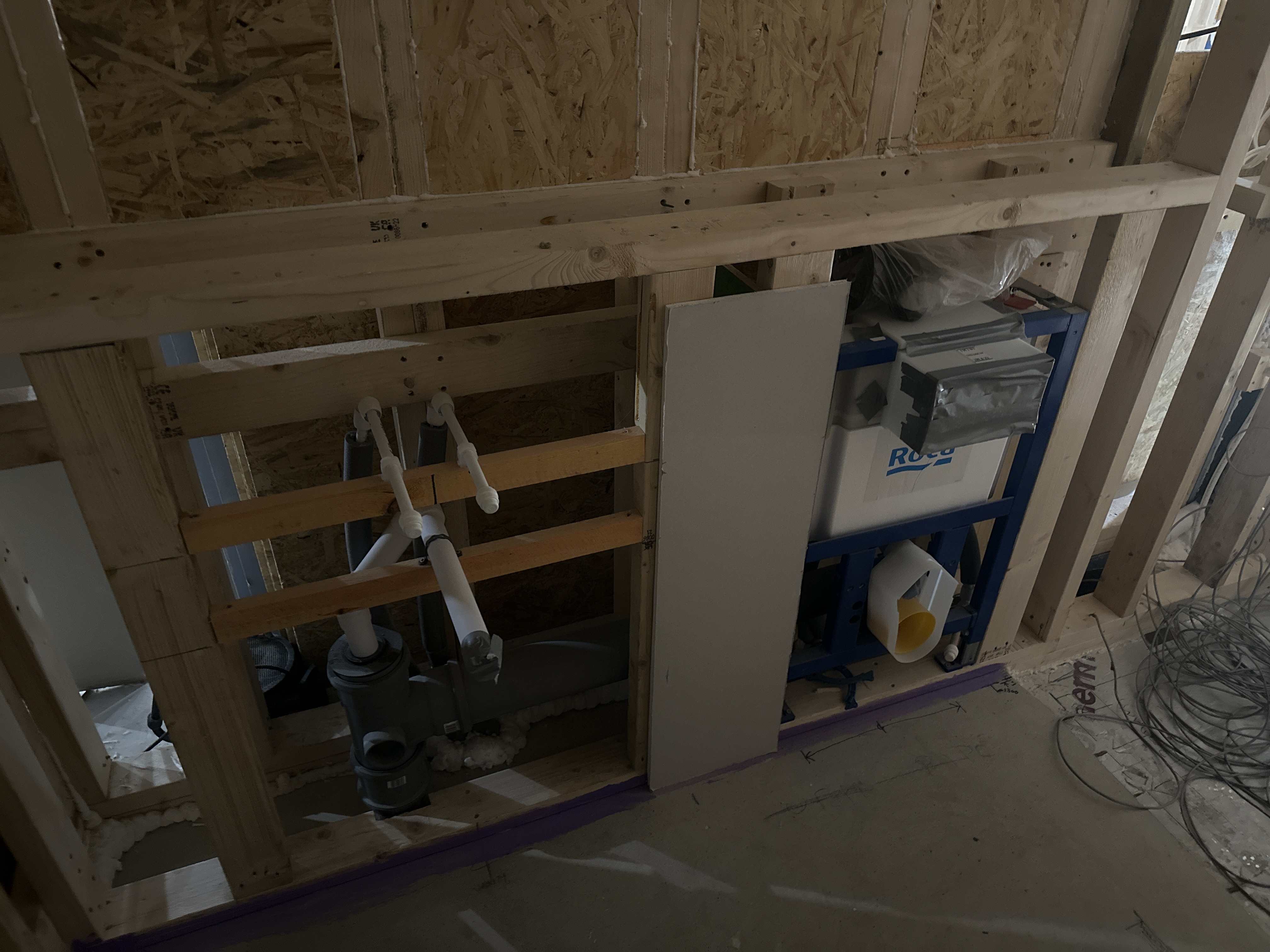

Just good (robust) woodwork and framing here for 2 x framed WCs and then plasterboard and tiles.
Thin bead of sikaflex / CT1 on the metal of the frame and use that to bond the PB to the frame, and it’s rock solid for life.

We used timber studwork covered in 12mm Hardiebacker board in all our bathrooms.

The frames provide the support, the walls around them just hold the tiles. No need for ply or doubling up of anything.
Done a load of these over the years and never any issues whatsoever, ever with the Duravit, extra-long projecting pans.
6’2” Canadian was asking if they would move, so I stood in my socks on the very front edge and bounced up and down. MBC TF house and all supports / studwork done in chunky timber, and client was going white waiting for the pan to snap off the wall (which it didn’t).
These are rated to allow for a human to trip and fall onto them, so landing your arse down with a less-than-graceful ‘thump’ or slipping and falling onto these is accounted for; impact rating of 60-odd stone / ~400kg or something iirc.
Just do NOT use the stupid gasket they sometimes include, instead I mask the tiles and set the pan back into a bead of clear CT1, tighten up and level off, and then remove the displace sealant with a load of cheap baby wipes.
