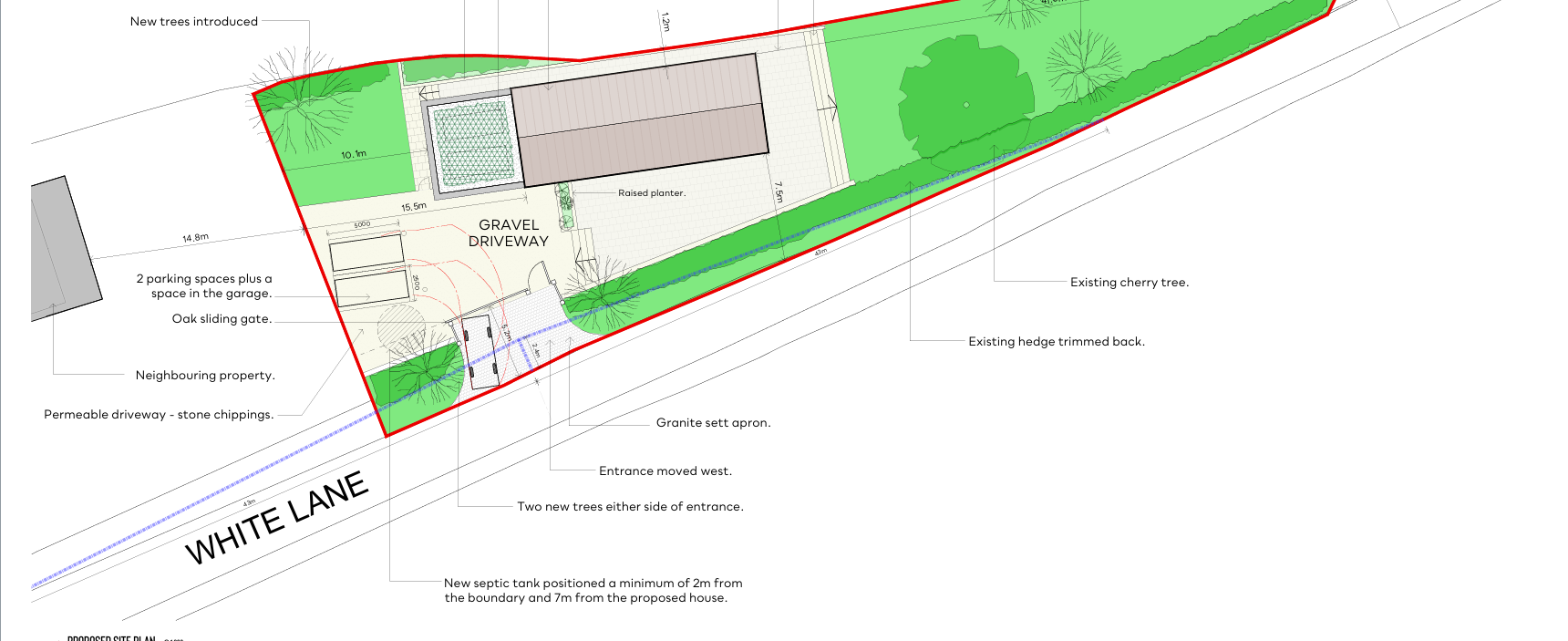

So the architects moved the proposed entrance of our house slightly westwards to that of the granted planning permission.
As is clearly visible from the blue line, it cuts directly through the neighbours hedging and they won't agree to us removing said hedging to meet the condition that they have attached (see below).  What is strange, is that the granted planning application shows the visibility splay to be nowhere near as wide as what highways have mandated this time.
"Before the development is brought into use, the means of vehicular access to the site shall be constructed in accordance with the approved plan (Drg No.24-WLC-PA-10) and no structure, erection or planting exceeding 1.0m in height shall thereafter be placed within the visibility splays shown on the approved plans."

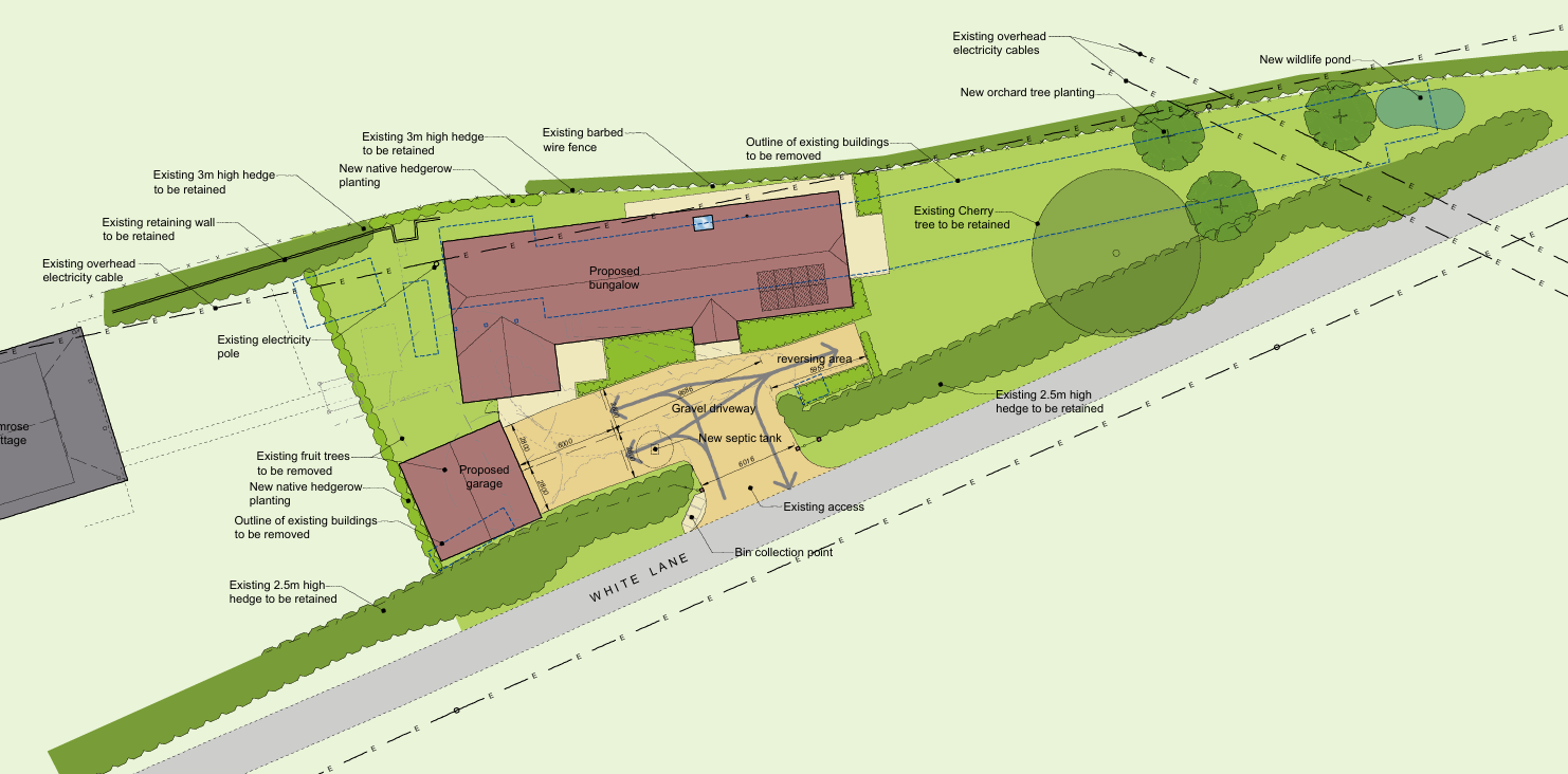

The existing entrance is shown below and Highways didn't mandate any conditions (they did so a site visit), and they haven't this time.   It's also a no through lane.
I obviously don't want to build a house that cannot be lived in because the condition cannot be satisfied.
Just to add.  This is what the architects have come back with.  One would think that before designing a house and submitting the application with visibility splays considered.  I feel that it's their screw up and they've seriously messed up.
"This could be an issue..
The previous permission did not have this 1.0m high clear sight line requirement, but then the access was not moved west.
To make the current scheme work we have to move the access west, which brings it nearer to next door, making the visibility splay to the west potentially harder to achieve. (that said the last consent also had a bin store blocking this view although I guess that may have been 1m high only.)
To be sure this isn't a potential problem we need to know some measurements as to the extent of next doors hedge and whether it obscures our 43m visibility splay as you look right - from 2m back from the highway edge - from the centre point of our proposed new access.
The photo below shows that there is some grass verge to help here, but we need to check whether this is sufficient to comply with the suggested condition.
If it's not, the choices are to do nothing, accept the consent and assume it'll never be checked or challenged, or to instruct a qualified highway engineer to make a case that the new access, and what can be seen to the right is adequate for this very lightly used single carriageway lane.
I can suggest a name in this connection if required.
It would be helpful as a start, if you could plot some dimensions when you next visit to ascertain if we do have an issue to address here.
Hope that makes sense."

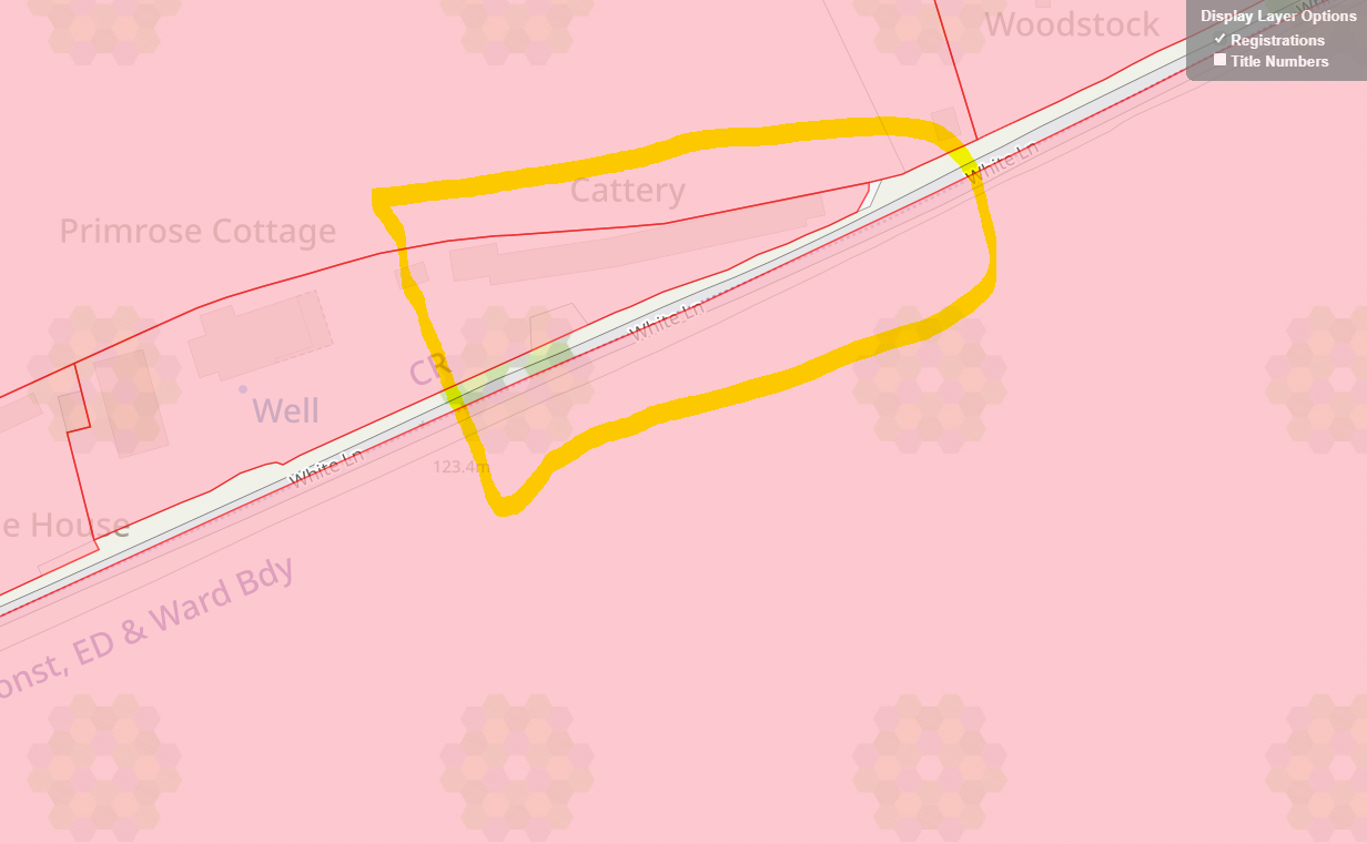

But a quick look on land registry suggests the boundary is not up to the road.  Where as on the south side the farmer seems to own half of the road as well.  This could be a land registry display issue.

The plot already has granted PP and the access for that application is shown on the second image.   The access already exists and was the entrance to the old cattery business.
As to the boundary not going to the road edge.  Our solicitor never flagged that.  I just checked on Land Registry and it appears to not be owned by anybody and I think it must be owned by the council.  This would have come up in searches if there had been an issue with access and ransom strips.
Then I would tell your architect that any revised plans MUST uses that long established access, and his job is to make a layout work using that access before you go to planning again.
