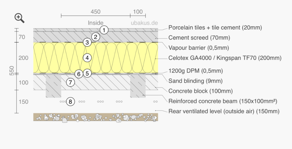

mads Posted March 18, 2025 Posted March 18, 2025 Hello! My architect mentioned that the SE is proposing a block and joist foundation rather than a concrete pad (which is what I was expecting) Quote Given the ground conditions beam and block is probably the way forward. Beam and block with insulation on top, then UFH, then screed. Just wondered if there is much difference between the two in terms of benefits, costs, etc? Re: ground conditions, we live in an area with heavy clay (awaiting geotechnical investigation report)
Nickfromwales Posted March 18, 2025 Posted March 18, 2025 Hi. Block and beam can be done well, but you’ll need to get the architect to set levels out to allow 150mm PIR insulation and (ideally) a 100mm slab atop; in the slab sits your anti crack 142 mesh and your UFH pipes zip tie to that. That would get you to ‘top of concrete’ (TOC) level, so then your chosen floor covering goes straight onto that, and then that’s your finish floor level (FFL). Insulated raft foundations are typically seen to be the best choice, as B&B will be cold ventilated so Baltic under there during winter, whereas a raft (or strip and infill slabs) will not have the cold under them eg way better imho.

mads Posted March 18, 2025 Author Posted March 18, 2025 3 hours ago, Nickfromwales said: Insulated raft foundations are typically seen to be the best choice, as B&B will be cold ventilated so Baltic under there during winter, whereas a raft (or strip and infill slabs) will not have the cold under them eg way better imho. I'm hoping not to be needing to ever get under the flooring But on a serious note, realistically how much "empty space" will be under the floor given recommendation I have seen is 225mm between floor underside and the ground. Though writing that just now it does feel like unnecessary excavation when I consider the ground floor will be 195sqm.
Nickfromwales Posted March 18, 2025 Posted March 18, 2025 2 hours ago, Big Jimbo said: @Nickfromwales but with heavy clay, would an insulated raft "Kore" etc, even be feasible . You can use them in quite adverse conditions, but where there’s excess heave you sometimes have to pile and tie the ring and intermediate beams into those. Very difficult to say much on here tbh, as it’s the SE’s call and also hangs on what the findings of the soil survey were. 1
Russell griffiths Posted March 18, 2025 Posted March 18, 2025 1 hour ago, mads said: I'm hoping not to be needing to ever get under the flooring But on a serious note, realistically how much "empty space" will be under the floor given recommendation I have seen is 225mm between floor underside and the ground. Though writing that just now it does feel like unnecessary excavation when I consider the ground floor will be 195sqm. You will need to excavate all that out if you go for a raft or block n beam. you generally strip 3-400 mm of soil from the whole house area to get down to firm sub soil, if going for a raft you will excavate more. 1
Benpointer Posted March 19, 2025 Posted March 19, 2025 We're going for B&B rather than raft because: a) large footprint (180m2), b) heavy clay and risk of heave, c) we've 0.75 acre to spread the spoil so no muckaway costs. Yes, it will be baltic under the B&B but with 200mm PIR who cares?

Nickfromwales Posted March 20, 2025 Posted March 20, 2025 On 19/03/2025 at 21:43, Nickfromwales said: Nobody. 👍 I guess I should have added that kicker walks need to be topped with Marmox to stop intermediate cold bridging under internal wall sole plates.
