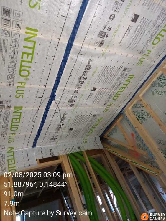

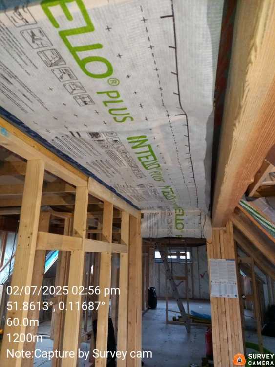

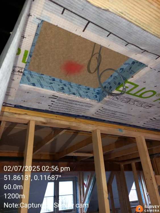

A couple of pictures of my efforts on the upper floor so far. I have so many of these aiirtight box's to make, so so many.

16 hours ago, benben5555 said:
What is the purpose of the airtight box?
Yes as Nick says, recessed lighting. also for the MVHR ducts.
The intello airtight membrane is fitted to the underside of the first floor ceiling. Once the plasterboard goes up, each penetration of it for the lights and ducts breaches the airtight boundary. So the boundary has to be extended to include these fittings. 6 MVHR outlets and 7 recessed light fittings in the wetrooms.
Now i know why the TF company left a pallet of Noggins for me.
13 hours ago, Nickfromwales said:
Nice neat work
Thanks Nick. some are better than others. The long runs of the Intello sometimes run more true that others. That is difficult to do on your own. Love my Dewalt stapler though
This is why my advice at design stage is build a house with a warm roof and all insulation and air tightness following the roof line.
Lovely warm loft and no bother with lots and lots of detailed air tightness at the junction between a warm room ceiling and a cold loft above it.
It's worth it in the end!! Don't cut corners, quality over quantity and a life time to enjoy it.
