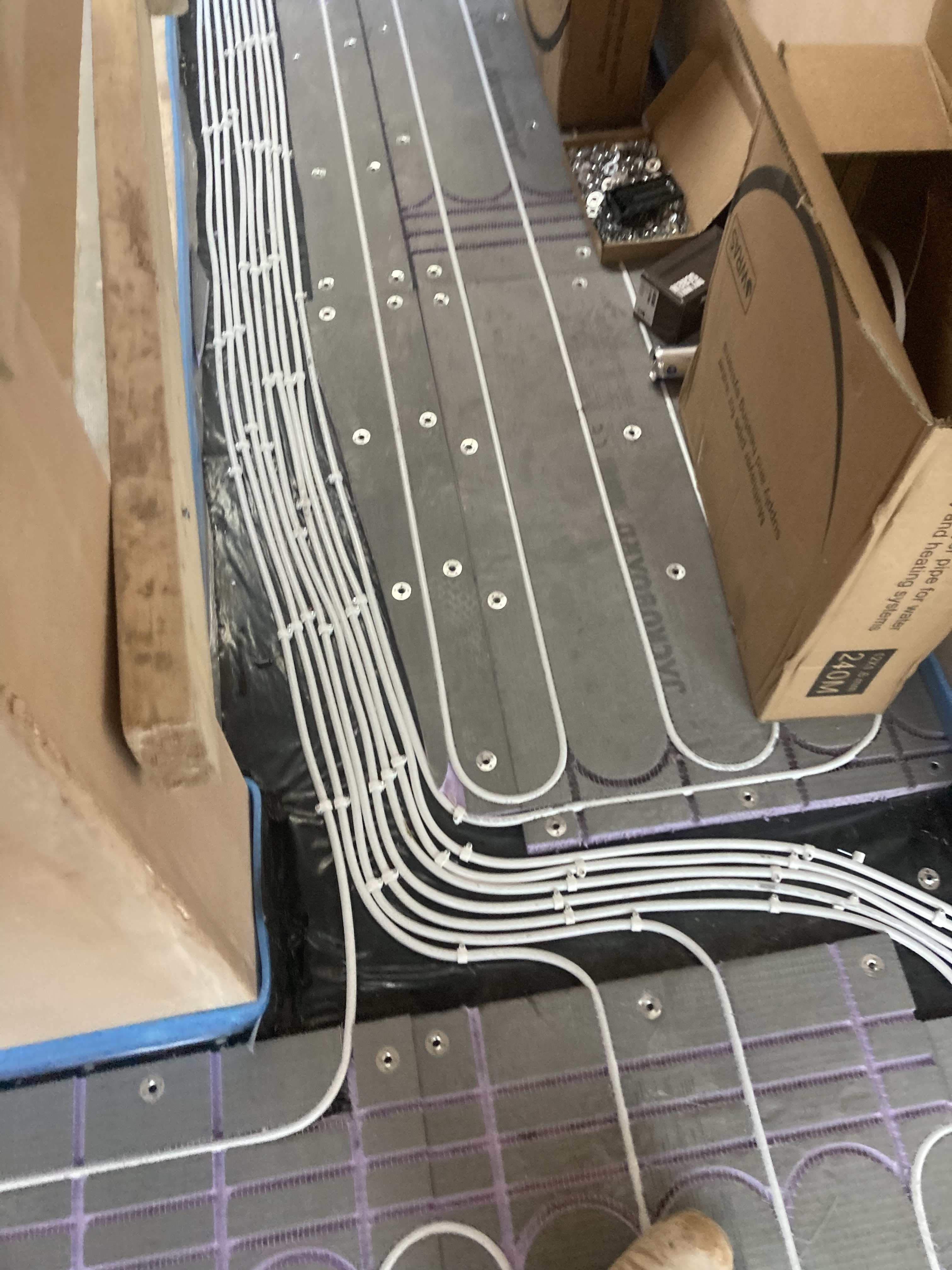

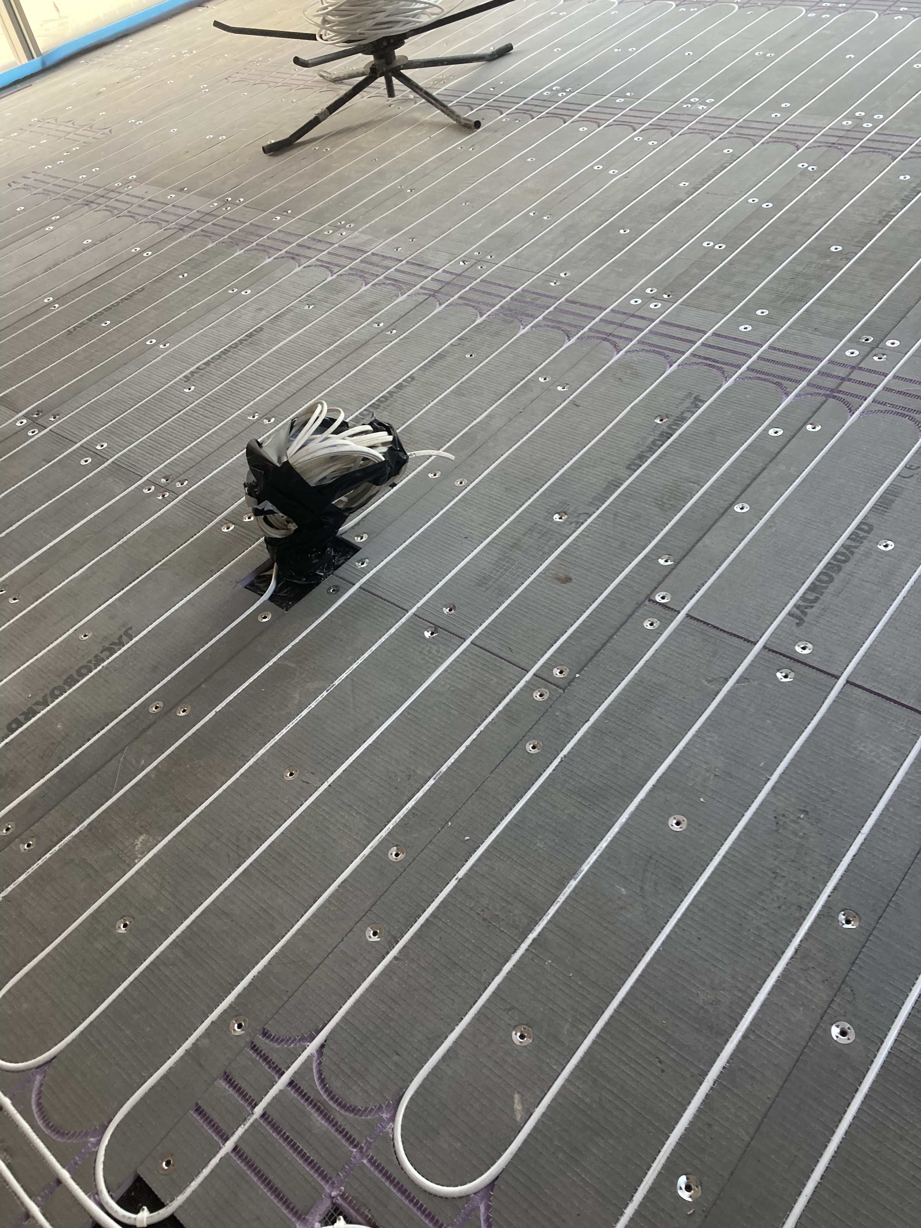

I’m fitting this one for a friend
10 mil screed So even closer
