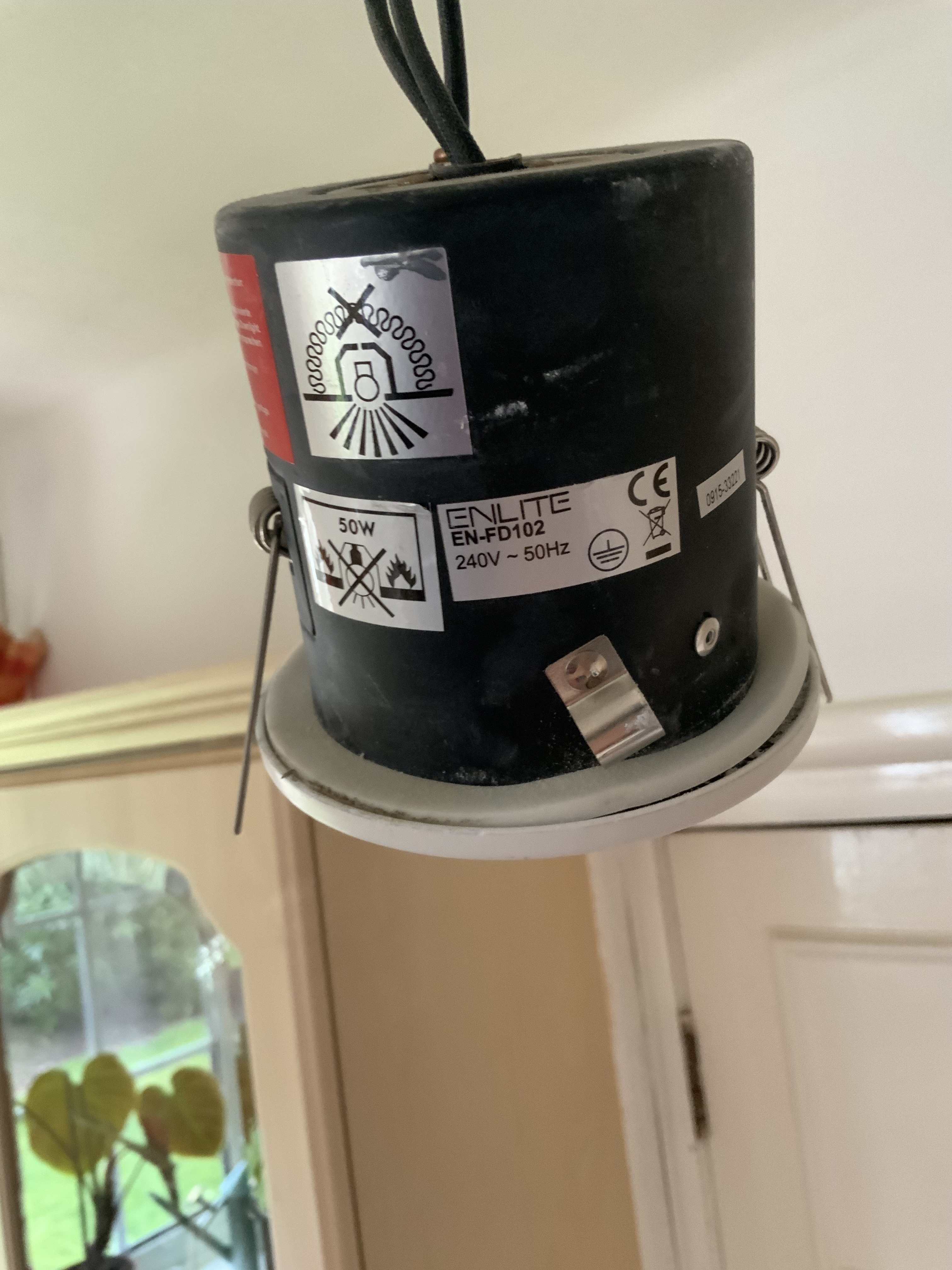

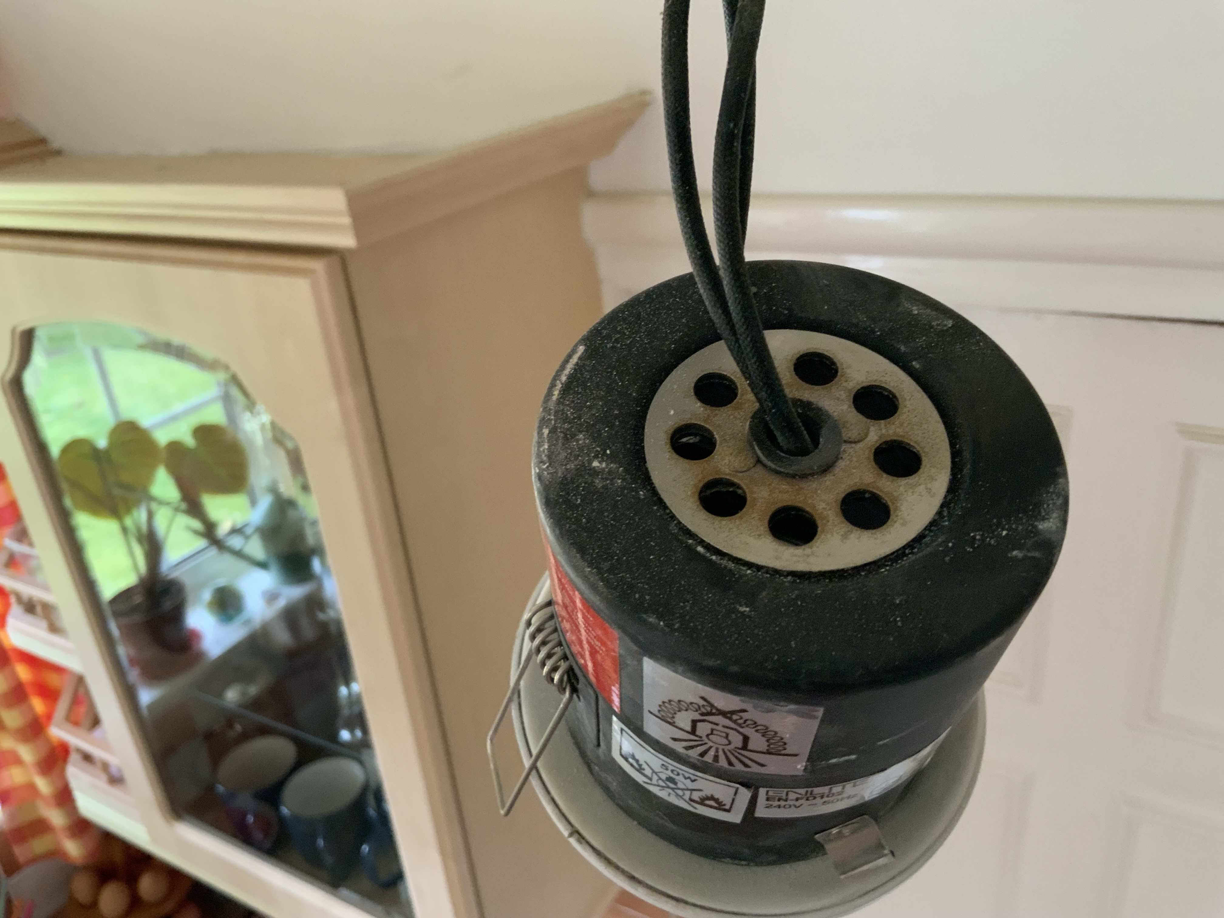

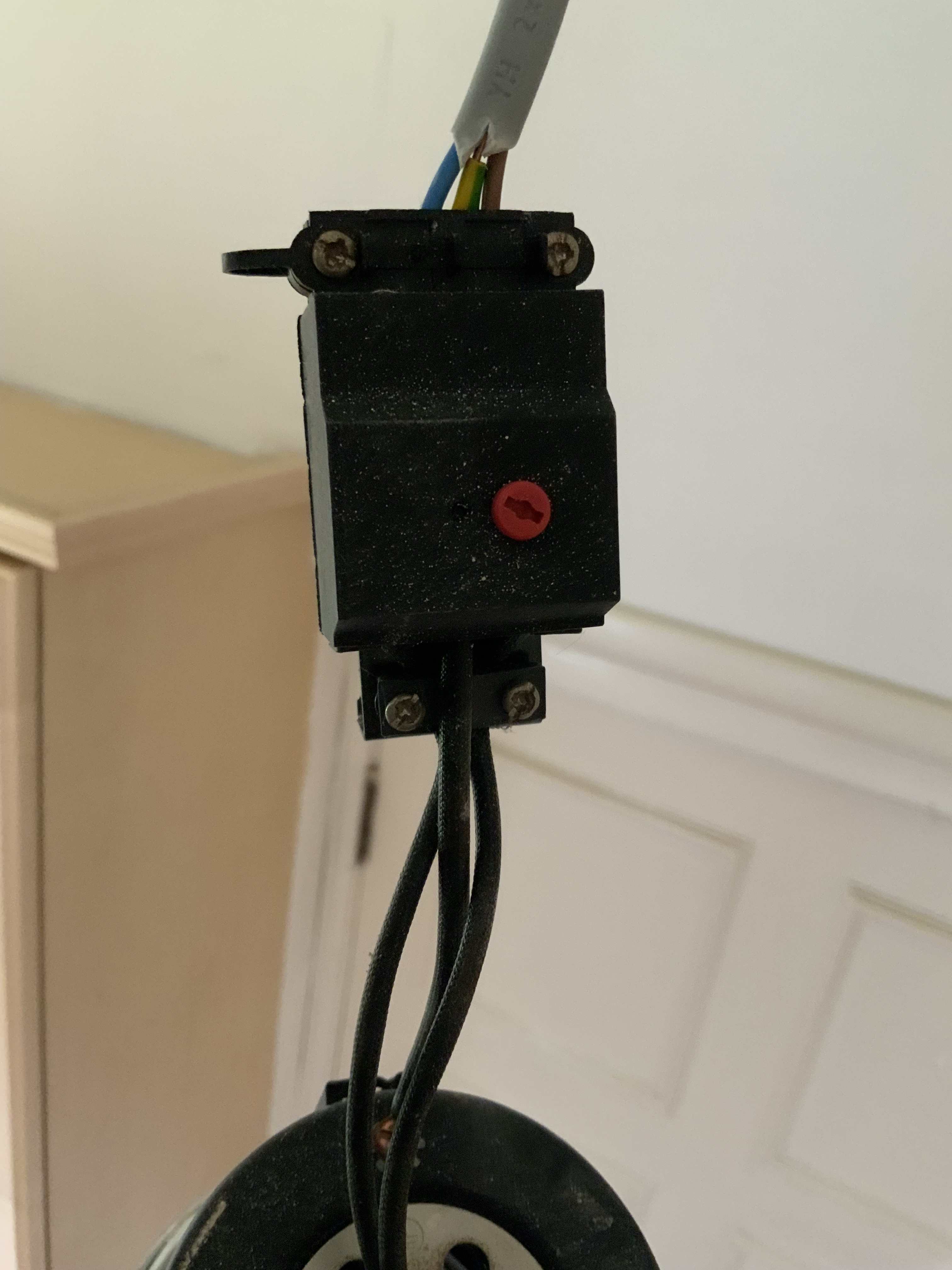

Hi all
I’ve had a look and I didn’t know if these photos help.
just to add to the fun another LED is on it’s way out.
photo #3 seems if it might be getting hot.
please advise
