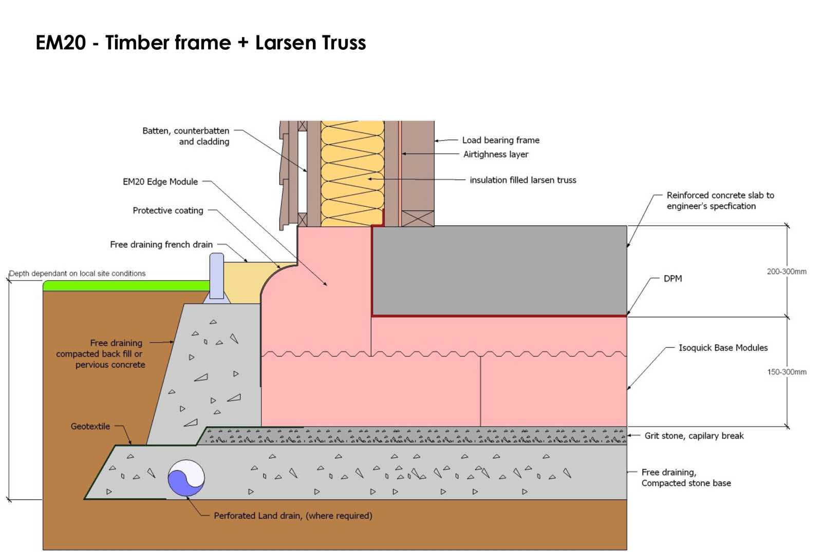

IanR Posted February 27, 2025 Posted February 27, 2025 30 minutes ago, lizzieuk1 said: Thanks Ian, Not had a test done yet so don't know the bearing capacity. Hopefully it will be suitable. With the raft needing to be 150mm about Ground level, is that standard for all rafts? Am thinking of how to grade the 2 levels - do you raise the hardstanding around the perimeter then grade down? It's a BC erquirement for DPC above ground. DPC/DPM will be at the top of the poured concrete of the raft. (unless you are building a partial basement)
lizzieuk1 Posted February 27, 2025 Author Posted February 27, 2025 4 hours ago, IanR said: It's a BC erquirement for DPC above ground. DPC/DPM will be at the top of the poured concrete of the raft. (unless you are building a partial basement) Yes, of course, was forgetting the dpc is directly on the raft top!
JohnMo Posted February 27, 2025 Posted February 27, 2025 6 hours ago, IanR said: DPM will be at the top of the poured concrete of the raft That then means the slab cannot be your finished floor and you have to screed? Which makes no sense. So surely the dpm would be below the concrete, not on top. As per sketch 1
lizzieuk1 Posted February 27, 2025 Author Posted February 27, 2025 20 minutes ago, JohnMo said: That then means the slab cannot be your finished floor and you have to screed? Which makes no sense. So surely the dpm would be below the concrete, not on top. As per sketch Yes, sorry I've caused confusion, what I meant was the dpm exits from under the concrete to finish level with the top of the concrete (as per your detail) not sure what happens under the Larsen truss though, does it have another dpc tied in or is the detail to minimise risk of water ingress between the insulation in the walls and the top of the raft insulation?(sorry I've not looked at TF details really so a bit ignorant on that aspect)

IanR Posted February 27, 2025 Posted February 27, 2025 (edited) As per image posted on page 2 of this thread And in practice 2 hours ago, lizzieuk1 said: Ooi how have others met the BC requirements for a level threshold? Was hoping to get level with garden paving but seems that's not an option with the raft design. At the threshold locally bring the outside surface up to the FFL with linear drain against the threshold if exposed, or just tip the surface away from the door a degree or two if there's an overhang above. Level thresholds are no problem with a raft. Edited to add: Edited February 27, 2025 by IanR
