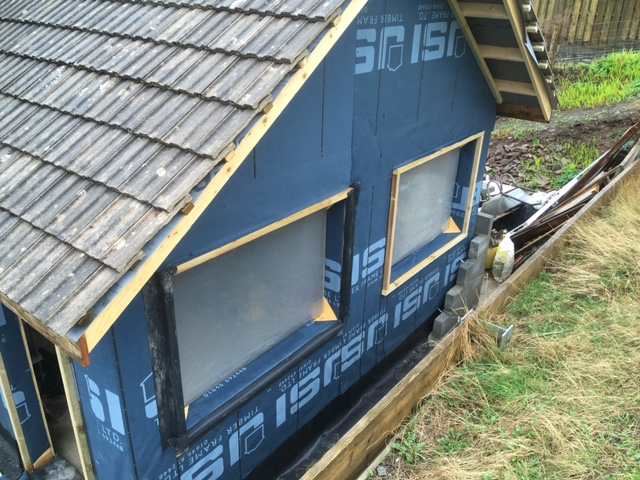

I would just like a little reassurance that I am calculating this correctly please. I have two windows at the back of my timber frame extension. The span is 1.5m.

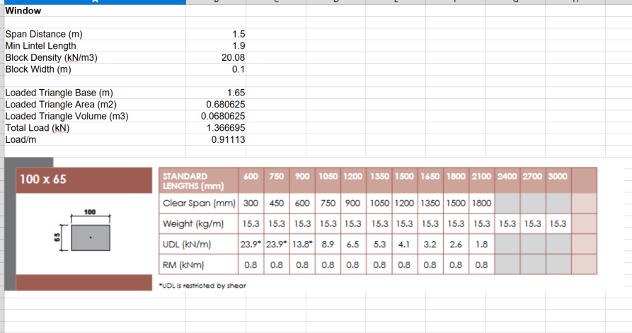

There are no complicating loads above the windows so its just the dense concrete blocks. Ive calculated the weight of the Loaded Traingle above the lintel and come out with a total load of 1.37 kN or 0.911 kN/m. My bricklayed thinks I should put a 100mmx150mm lintel over them but looking at the loading table it suggests that a 100mm x 65mm is more than sufficient with a UDL of 2.6 kN/m.  Have I made a mistake somewhere?

I just wanted to be sure I was calculating correctly really, if it is more than ample why use a bigger one? It not really about the cost, although the smaller one will be a lot lighter.

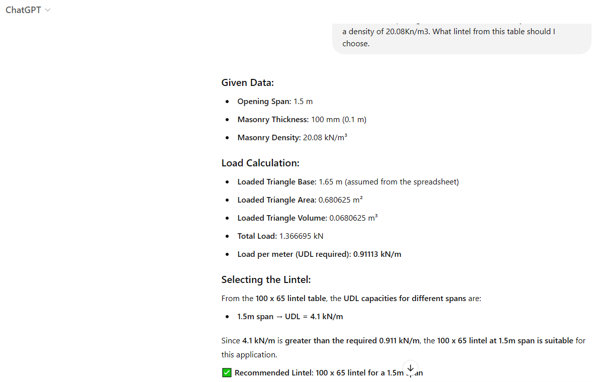

The computer super brain thinks you're right. II just dropped your question in there and the image of the span tables.
Me on the other hand have no idea without eyeballing it on site and jumping up and down on it.
EDIT. I notice it just read the span table incorrectly!!! If in doubt always jump harder on member in question.

Well I never thought of using ChatGPT like that!
Your bricklayer knows from experience that a 65 mm will deflect over that span especially with a ‘wet’ load. Either prop a 65 mm lintel in the middle while they build over it and then let the first course set before continuing or spend the extra £’s and use a 145 mm lintel with no propping.

Having read a bit more about the differences between composite and non-composite lintels, I have a question. Does the use of a cavity tray negate the support effect of the blockwork above a lintel and if it does then should a non-composite lintel always be used in that situation?

Yes as the plastic introduces a slip plane which destroys the composite action between the masonry above and the lintel.  If you bend a beam (also a composite beam.. composite lintel) downwards then there is compression in the top, tension in the bottom. When you balance all the forces within the beam you'll find not least that there are axial shear forces along the length.. the top of the beam is in compression so it shortens.. the bottom is stretching getting longer.. so there must be some axial shear forces in there. If you put a cavity tray in then the longitudinal shear force is not transferred between the brick courses above and the concrete lintel.. add a bit of water to that.. as that is what cavity trays are for and you have a good slip plane. Hope that makes sense?
In this case you need a non composite lintel.
