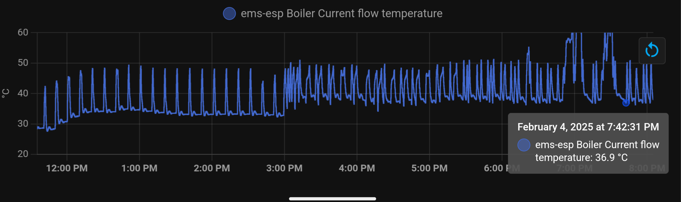

Boiler short cycling with low flow temperatures
I've got a Worcester 38 CDI Classic combi boiler supplying a small 90s 3 bedroom house (8 radiators, 2 towel rails, UFH in kitchen extension). Pipework is 22mm primaries at the boiler with 10mm microbore drops to each radiator. I've set up some automation in Home Assistant to provide a degree of weather compensation and lower the flow temperature on warmer days, but I'm finding the boiler is struggling with this - unless the flow temperature is 65 or above, it hits target after about 30-60 seconds then shuts down the burner. I can see from the metrics that it's modulating down to 28%, which appears to be the minimum. I think my problem is the microbore pipework (so small water volume) and the rubbish modulation ratio of the boiler - I think my heat loss is probably around 6kW and the lowest modulation is over 10kW. Is there anything I can do to improve this (buffer/volumiser, increasing radiator sizes, ...), or am I fighting a loosing battle? Plan is to replace the boiler with an ASHP in the future but it's only about 6 years old so I was hoping not to do this just yet. Many thanks!

Boiler and equally so heat pumps, just produce heat, if the heat cannot be dispersed to the house, return temp stays too high and you get what you are seeing. Splitting the system with zones will make life hard for the boiler.
Are you running with lots of thermostats, TRVs etc. micro bore may not be the issue, actual flow rate may be. Remember the microbore is only carrying the flow to a radiator which will have a decent volume.

Sounds to me like the boiler isn't seeing enough flow to keep it happy in the initial purge and high output phase unless the flow temp is set high enough that it doesn't overshoot (most boilers initial fire/purge is at 75% of max before they start modulating down)
I had similar issues with a Glow Worm 24kW boiler which had a similar 10kW min - my resolution to run lower flow temps was to sacrifice the delta T at the rads - ie increase the pump speed and or and free off the rads will still maintaining the balance in the system.
If you have an ABV in the circuit you could try increasing the flow thro it a little but ultimately returning flow back to the boiler via an ABV isn't great for efficiency
Microbore to the rads isn't necessarily a problem (if it's just a short section from main flow and return that are 22mm)
If your heat loss at around -2 is 6kW and the min modulation is 10kW it should be able to cope with that
10kWh with 6kWh requirement is going to run for ~30 mins in the hour with all rads in circuit provided you have the flow thro the boiler above the min which will be 10 lpm
However once TRV's start to close the circuit size is going to shrink quite quickly

I'd try increasing the flow rate thro the circuit first and see if you can get the boiler to cope with a lower flow temp and not overshoot on the initial fire/purge
Yes, that's pretty much what seems to happen and thus no heat distribution either.
The 38CDi classic should theoretically be able to run 40/30 flow and return, so I think there is a control issue.
Would be interesting to test the system on relay control only and then set flow temp at boiler with system all open.

Thanks folks. The Evohome is currently switching the boiler by relay and I've got a spare round thermostat, so I could try taking Evohome out of the picture and pairing that directly instead, but I think it does TPI control too. I'm not sure about the heating flow and return, it's possible it reduces to 15mm later in the run. When I balanced radiators at 65deg flow, I was going for a 10 degree drop across the rad - should I be aiming for more than that?
I've got monitoring of the boiler through an EMS-ESP and that shows it dropping the burner to 28% within a few seconds but the flow temperature continues to climb rapidly (and it continues to climb for a bit after the burner is turned off too). I've tried the pump on proportional low but I'm currently running it on fixed speed step 3 (of 7) - any faster and the radiators get quite noisy.
Oh, and there's no ABV on the system (one of the towel rails has no TRV). I also struggled a lot with balancing one of the tall radiators - I got to about 6 degrees drop, but if I closed the lock shield any more, the flow temperature started dropping too. I think it's near the end of the system, so maybe not enough residual head? However, it's also the noisiest if I turn the pump speed up...

Depends on the rads - running 60 deg flow on my old glow worm I was struggling to better 8 deg on a T11 and 14 on a T22 rad
I gave up worrying about getting rads to the highest possible delta T and just concentrated on getting the right mean water temps to heat the rooms
So in responding to your last question a higher than 10 deg delta is going to make life worse for your boiler so no don't aim for more aim for less
The rads get noisy because you are restricting the flow so generating system noise
Open the lockshields a little and lower the pump speed and keep it on a fixed speed - proportional will do the opposite of what you want
Just for an example I'm running a ~30 deg flow temp at around zero deg outside air temp - I get a delta at the boiler of 7 deg
Pump speed is 2 (fixed) and is around 0.5 m3/hr - there are 13 rads in the circuit
My biggest rad 700 x 1400 K33 has a flow in of 30 deg and a return of 24 deg and it's getting nearly 20% of the total circuit flow but it's a big room and one rad has to heat that room

9 cycles an hour between 12 and 1? And in the afternoon way more - I’d not be happy with that at all
27 minutes ago, seanblee said:
No obvious improvement yet, but I'll see what it's like tomorrow morning on warm-up...
The boiler is being cycled 6 times an hour by Evohome. It is not the boiler initiating the cycle. My Drayton Wiser does exactly the same. I think you can change the cycling frequency within the Evohome settings.
I understand that Evohome turns the boiler on and off a few times an hour, but that's not the issue I'm having here - even when Evohome is continuously calling for heat, the burner is firing, the flow temperature is rapidly rising until it crosses the setpoint, then the burner is turned off until the flow falls to the hysteresis threshold of 10 degrees below the setpoint, then the cycle repeats...
