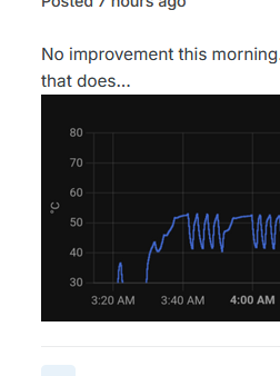

No improvement this morning. I'll try opening the lockshields half a turn as you suggest and see what that does...

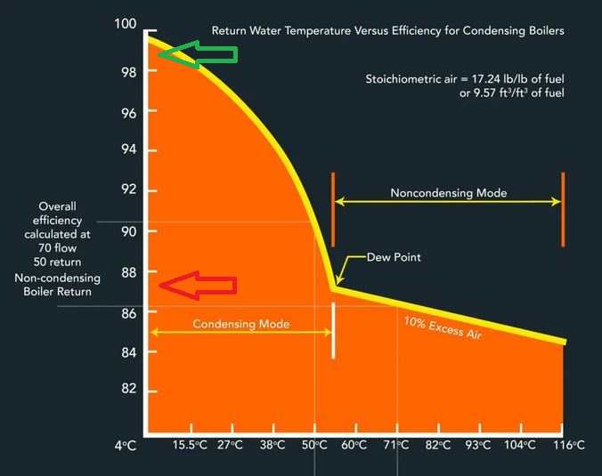

Can I have a bit more detail on this end of the graph please??
Just looking at the graph.
I would operate a little more dumb and at a higher temp.  Do you need heating on at 3.30am? If not leave for as late as possible to give boiler way more work to do flow at 60+. As long as your return temp is below 53/54 deg you are in condensing mode, only marginal gains are made after that.  It's going to way more efficient than your current operation.  Does your boiler control have its own thermostat? or if you want to, do through Home Assistant for now just use the generic thermostat set the hysteresis to 0.5 or more
I think that's what he is doing - he's running it at the minimum elevated temp he can - he wants to run the boiler at lower flow temps but can't because it cycles like heck (more than it's doing now)
Marginal??
The difference between the red arrow and the green arrow is marginal??
That's like saying the difference between running a heat pump at 55 versus 45 is marginal in terms of COP!!!
On this we agree :D
Overnight setback for the lounge is 17 (dropping from 20 at 10pm), so there are a few spikes from 3am onwards where I guess Evohome is firing the boiler for short durations to maintain temperature. Warm-up proper started at 3:30am in order to hit 20 by 5:30am (my kids wake up annoyingly early!):
