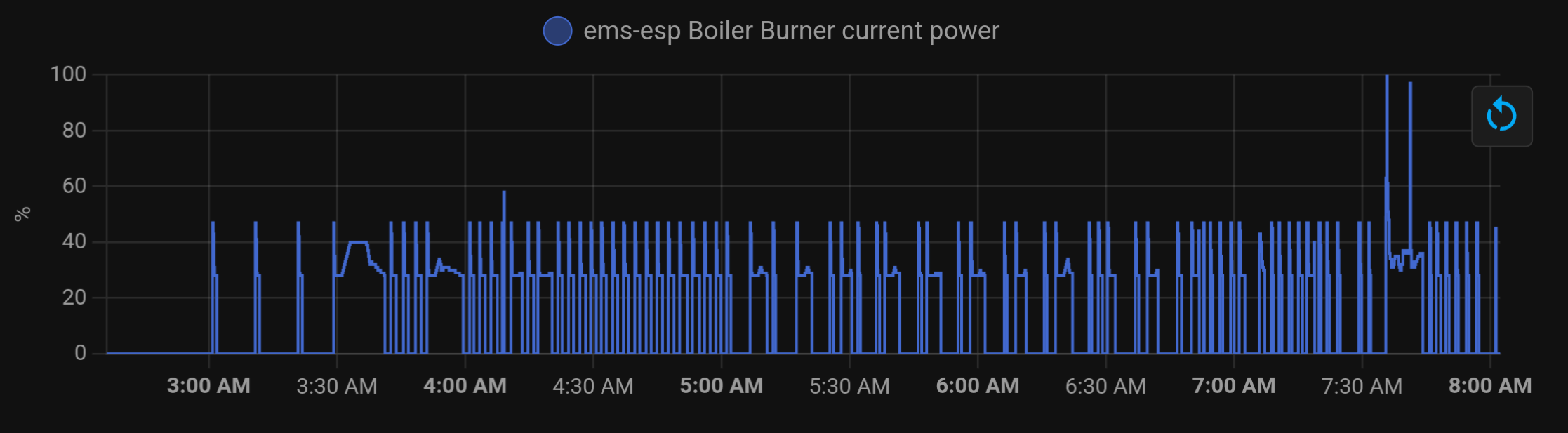

February 5, 20251 yr Author 57 minutes ago, marshian said: Yes it’s still cycling but the important bit to consider is if the boiler still overshooting the set point with more open rads? Unfortunately yes. I've increased the set point to 65 and it seems better, but I'll know more tomorrow morning - right now, the rooms have overshot their set temperature, so I think Evohome needs to re-adapt.
February 5, 20251 yr 1 minute ago, seanblee said: Unfortunately yes. I've increased the set point to 65 and it seems better, but I'll know more tomorrow morning - right now, the rooms have overshot their set temperature, so I think Evohome needs to re-adapt. I'm not concerned about rooms over shooting Evohome can do what it likes but if you still have a situation where the flow temp spikes when the boiler shortly restart overshoots and shuts down quicky then clearly the circuit still has a restriction to flow that the boiler is not happy with. You also say the system is noisy - now normally that would indicate a strong flow thro the circuit and I wouldn't be looking there but now I am. Let me show you my issue when for a reason I didn't understand I had to wind up the pump to speed 2 in order to stop the boiler short cycling due to temp overshoot. This massively increased system noise Now admittedly the pump had been in there 15 years and there was a magnaclean installed a couple of years before I found this but it was installed after the pump......... The system noise kept SWMBO awake which is sub optimal and also annoyed me as the system had always been whisper quiet on the lowest pump speed Cleaned out (and there was a lot of stuff in the vanes you can't see) I was able to drop back to speed 1 and the short cycling stopped Not say this is your problem but whilst Evohome is almost certainly cycling the boiler the over shoots aren't down to Evohome

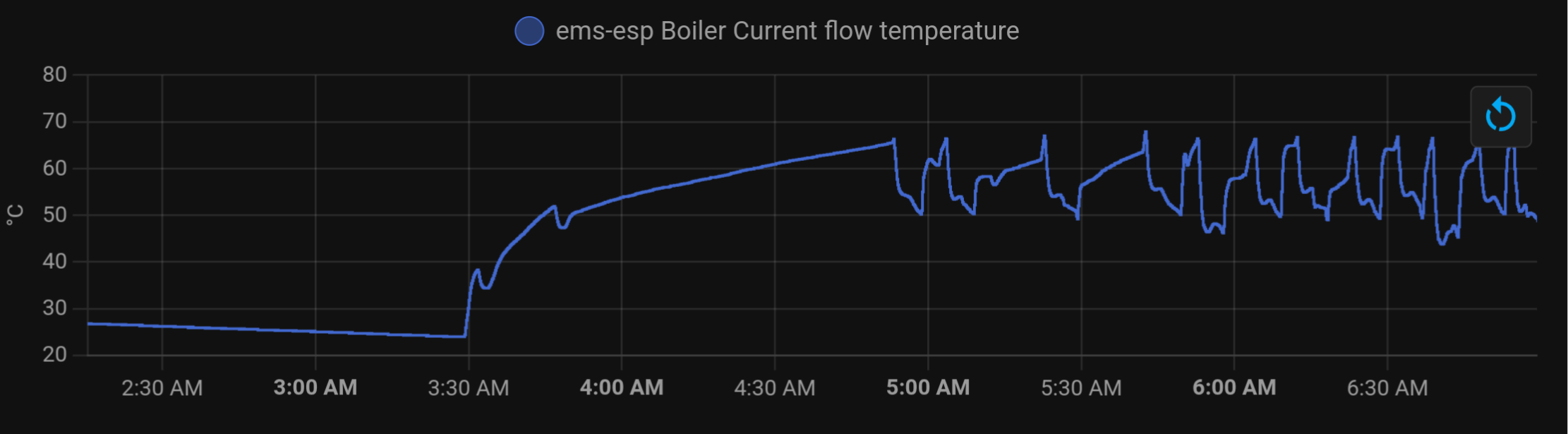

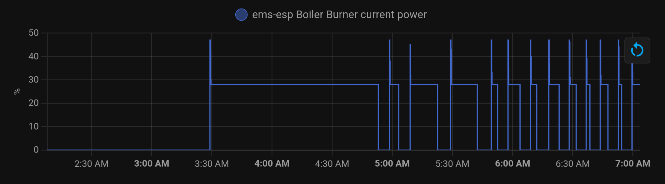

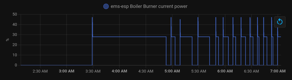

February 6, 20251 yr Author This morning is looking rather better: Perhaps more interesting is the burner power - this was yesterday morning: And this is today: Pretty dramatic difference! I might still raise the ACT a little to reduce the cycles when the room temperature is closer to the set point, but this is the first morning I can remember where I came downstairs to find the lounge at the target temperature, not 1-2 degrees below. 28% is as low as it'll go for range rating, the register won't accept a smaller number. It looks like it very briefly fires at a higher power level but almost immediately drops back to the configured setting. Edited February 6, 20251 yr by seanblee Typo
February 6, 20251 yr That’s better - still probably things can be tweaked but I’ll take that as a win
February 6, 20251 yr Important thing (stating the bloody obvious) is the boiler has to get the house warm - no point having a boiler thats tweaked to the max to give longest burns possible at lowest flow temps if the house is cold………. I reckon you’ll be able to reduce the flow temps along with a few more tweaks and maybe even drop the pump speed too last question are the lockshields reset to where they were or still a 1/2 turn open more?
February 6, 20251 yr Author 25 minutes ago, marshian said: last question are the lockshields reset to where they were or still a 1/2 turn open more? They're all back where they were, so approx 10 degrees drop across each radiator at 65 degrees flow. At this point, I think the changes that have made a difference are eliminating (most of) Evohome's TRVs, range rating, tweaking anti cycle and increasing the flow temperature. I'll give it a few days then I might try lowering the flow a few degrees in tandem with opening the lock shields a little and see what that does, but I'm happy it's at a good starting point now. Thanks again!

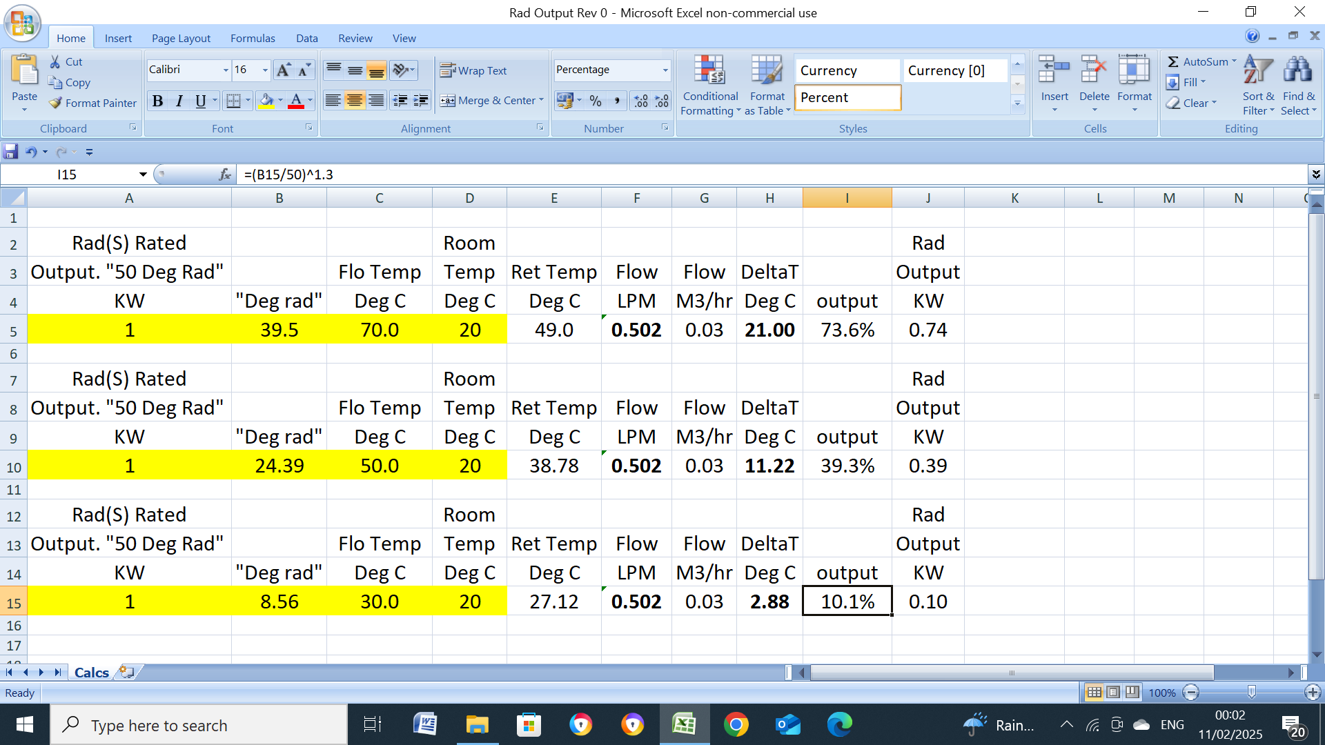

February 11, 20251 yr 28 minutes ago, John Carroll said: Is this a heatgeek table, if so, or whoever, then they must be changing the flowrate to get those sort of dTs?. If you use the third row, 70C/49C/21C, as the base, this gives a flowrate of 0.502LPM/kW and (assuming the same flowrate) a dT of 11.22C (vs 15.0C) at 50C flowtemp and a dT of 2.88C (vs 9.0C) at 30C flowtemp. (Assuming a 20C Room Temp) Table generated by "Rule of thumb" Heat Geek article said As the controller causes the return temperature to drop and get ever closer to the room temperature, it becomes increasingly more difficult to shed the heat. This is because the 'heat transfer coefficient' of the radiators drops. For example, if you have a room of 20°c you'll never be able to get a DT of 20 if your flow temperature is for example 30°c. A more realistic target is a DT that's around 30% of the flow temperature. For example; If we have a flow temperature of 70°c, (70 x 0.3) gives a DT of 21°c. If your flow temperature is 50°c this would give a DT of 15°c (50 X 0.3) and so on. This is not exact, it's just to get the flow rate in the right ballpark. There are more complex calculations for this if you need but really not worth it.

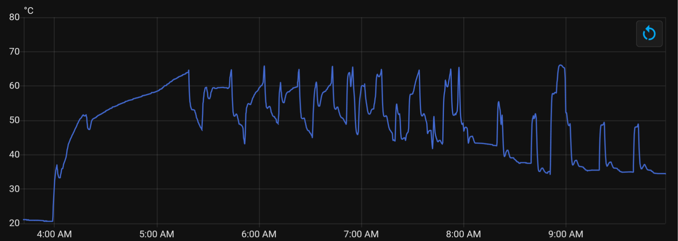

February 19, 20251 yr Author Well, I'm still running at over 60 degrees flow temperature - I think I'm ultimately going to need to replace the two vertical radiators with bigger ones to get more heat into the room at lower flow temperatures. Other than that, I think things are looking pretty good - this is the flow temperature today, and the burner stats show it running at 28% from 4am for nearly 90 minutes, so it's no longer short cycling.
February 20, 20251 yr 20 hours ago, seanblee said: Well, I'm still running at over 60 degrees flow temperature - I think I'm ultimately going to need to replace the two vertical radiators with bigger ones to get more heat into the room at lower flow temperatures. Other than that, I think things are looking pretty good - this is the flow temperature today, and the burner stats show it running at 28% from 4am for nearly 90 minutes, so it's no longer short cycling. Looks better You can potentially avoid bigger rads by heating longer (ie 24/7 or with very minimal set backs outside of scheduled heating periods) I was heating to a schedule and running 50 deg flow temps (at zero OAT) - to get the room up to temp within the schedule Moved to 24/7 heating and I'm running 32 deg flow temps (at zero OAT) Setbacks with recovery didn't seem to save any energy v a 24/7 heating period Only proviso is the boiler needs to be happy at the lower flow temps
