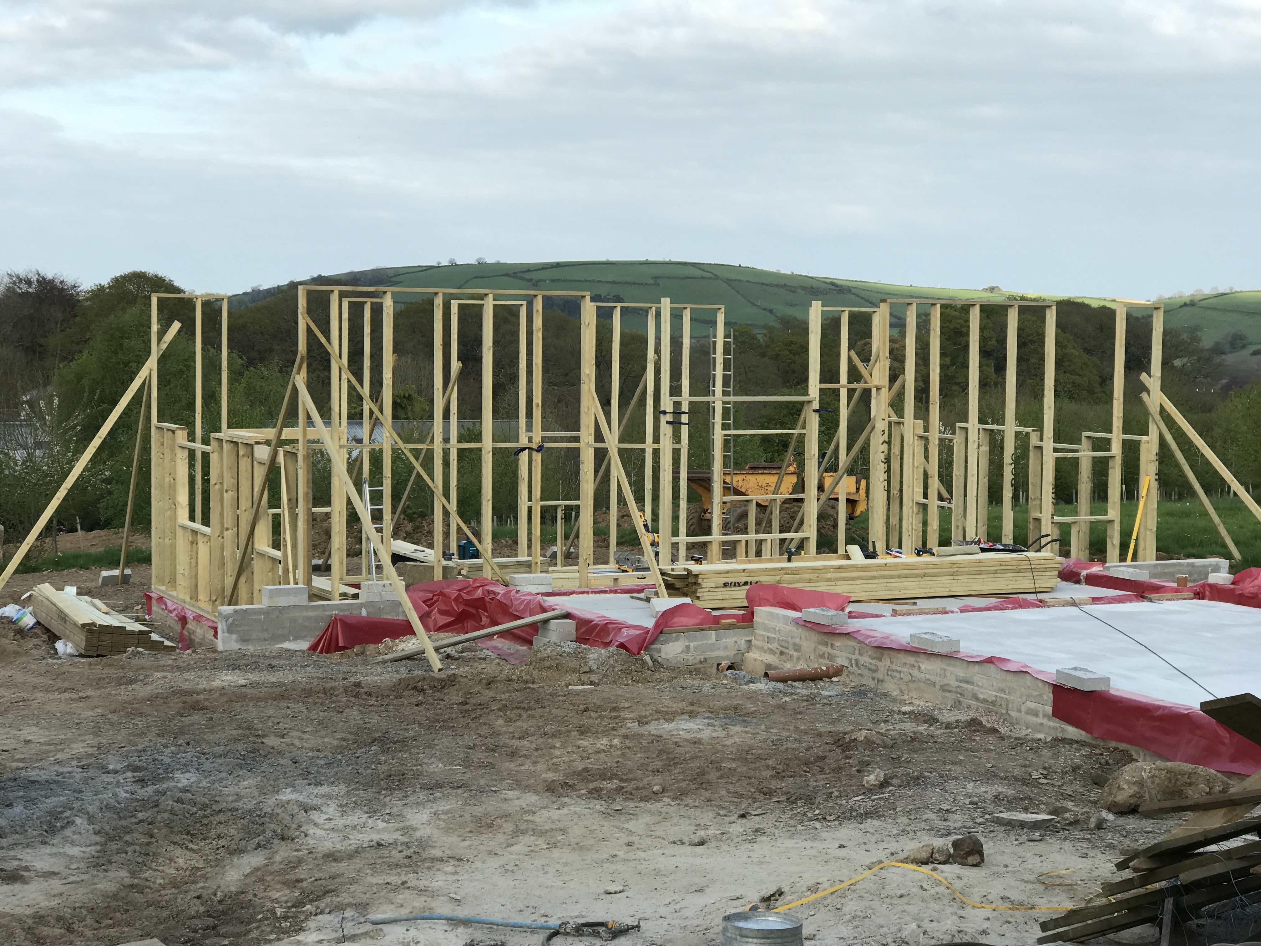

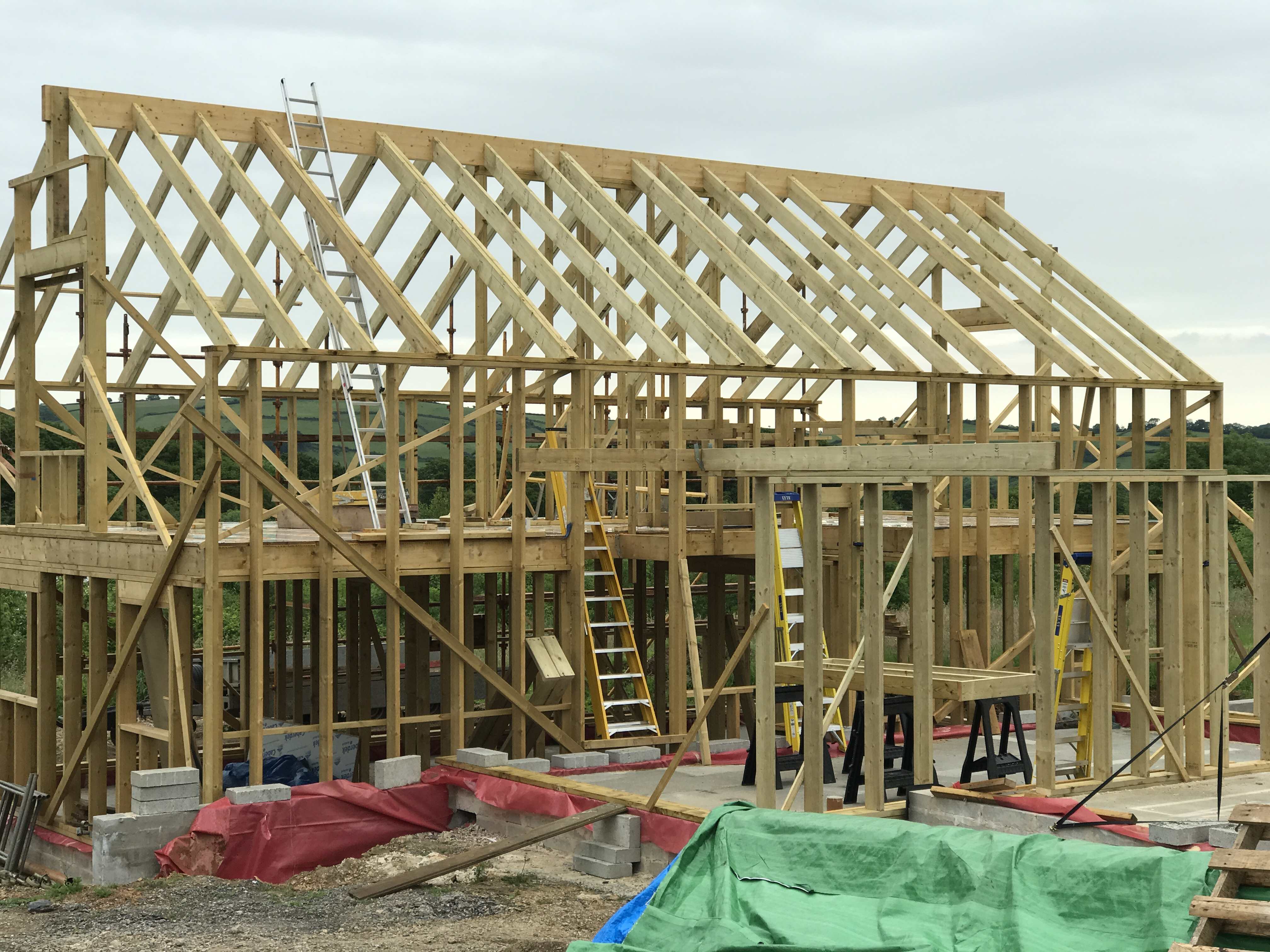

saveasteading Posted February 1, 2025 Author Posted February 1, 2025 @JamesP it's almost a shame to hide that frame behind boards. Did you prefab any of that? I'd bought 2 lots of 4 x 2 (excuse the shorthand. One lot was dressed as carcassing, the other sawn and tanalised for shuttering. The latter was cheaper and seemed better quality, so I will note the advice on finished dimensions.
Nestor Posted February 1, 2025 Posted February 1, 2025 I made the frame in sections on some workhorses. Worth spending time on getting it all square and vertical. Have fun. 3

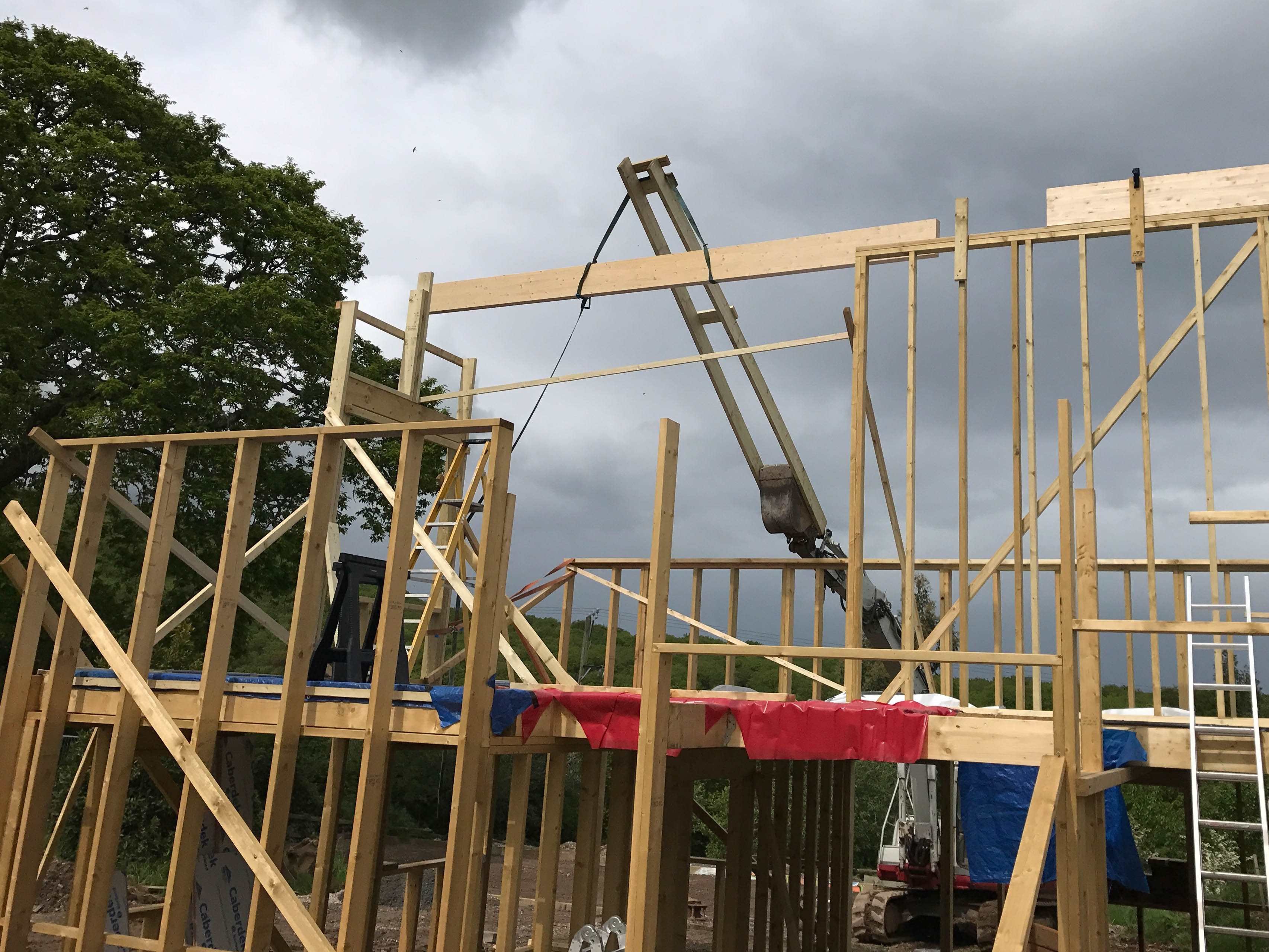

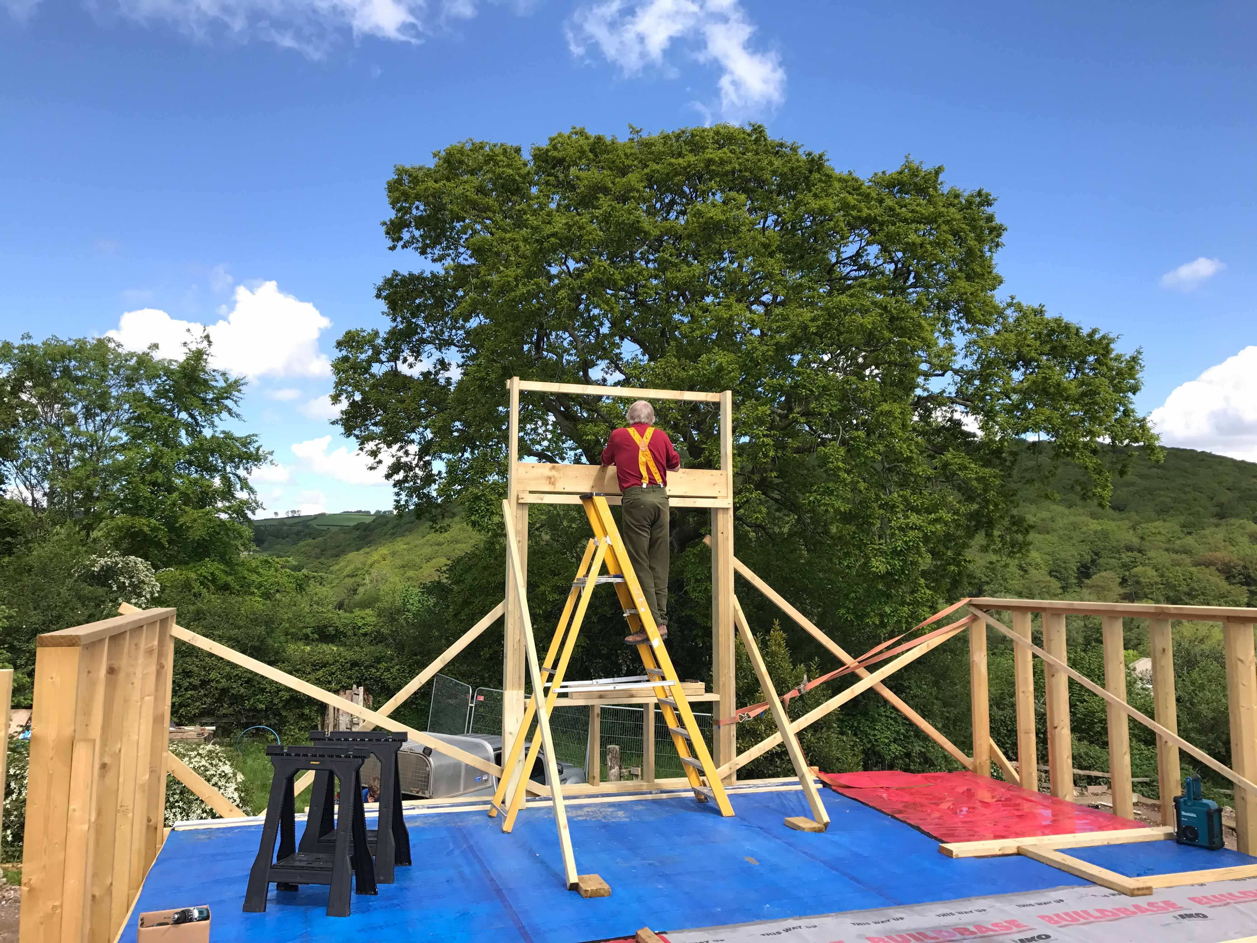

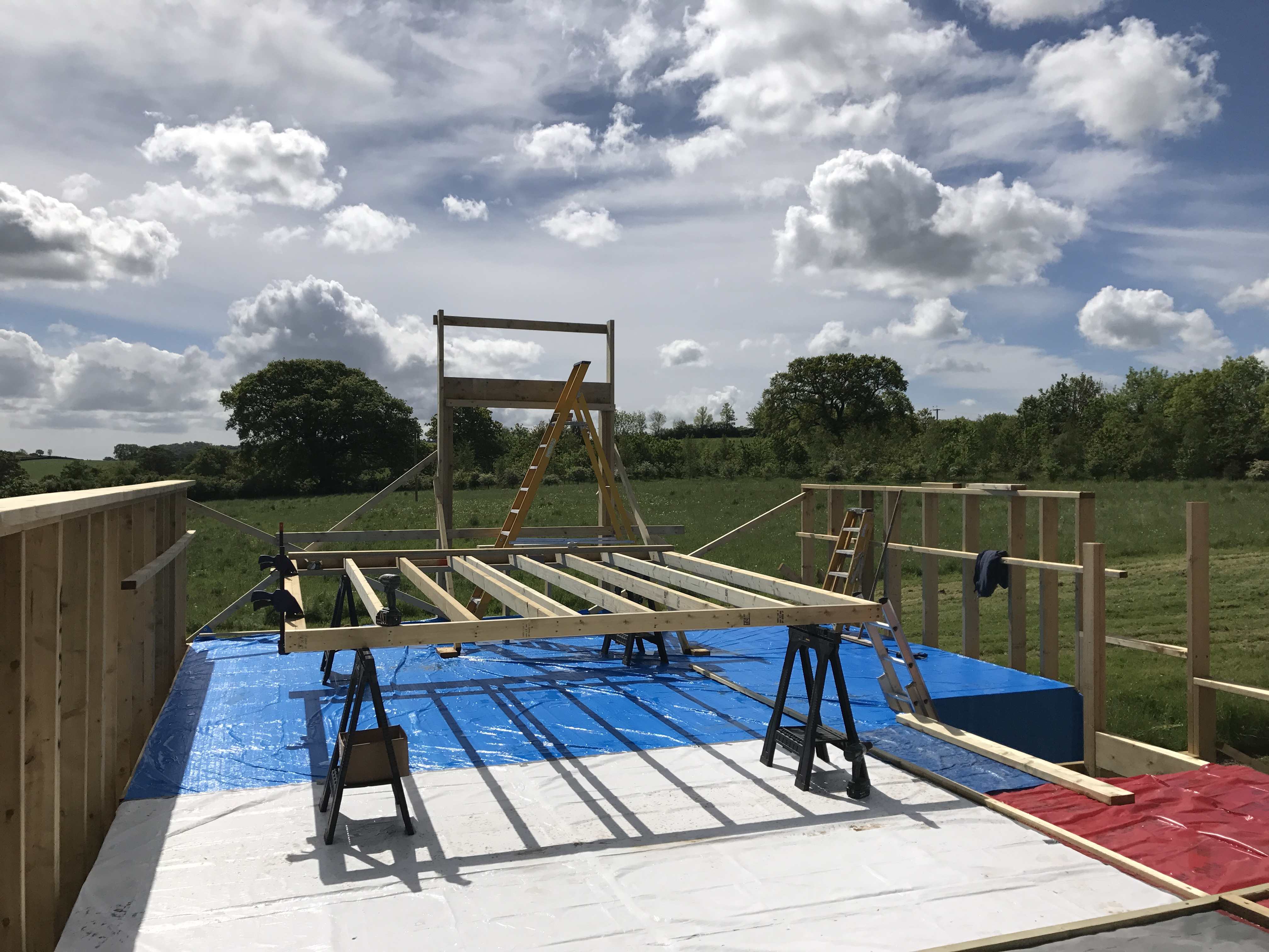

saveasteading Posted February 2, 2025 Author Posted February 2, 2025 13 hours ago, JamesP said: made the frame in sections That looks tall and heavy. How did you get it in position? That ladder also looks very high and precarious...I used to do that but no longer.
Nestor Posted February 2, 2025 Posted February 2, 2025 @saveasteading I used a extension on the bucket to lift Glulam ridge in position and some Genies to lift the 10.5m Steel for kitchen ridge. Otherwise it was all lifted by my Dad,on ladder and myself, 74 and 54 at the time. I did purchase some Kwikstage scaffolding to fit roof and cladding. 3
