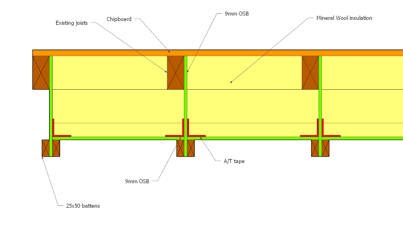

tenovus Posted January 27, 2025 Posted January 27, 2025 Hello all! I'm looking to insulate a Victorian suspended timber floor so I can stop heating the dirt. I'm planning to take most of the boards (not original) and replace with UFH chipboard panels. As my joists are 100mm deep (if I'm lucky - some are shallower), I don't think the Ecological Building Systems route alone is going to be quite good enough. I have some 100mm PIR to hand and plenty of crawlspace. I've put together a bit of a proposal on Ubakus which I'd love some thoughts on. Essentially using woodfibre board to extend the joists, hanging a breathable membrane off those, filling those hammocks with loose fill or STEICOflex (or eq) then a layer of PIR at the top. I'd hope this would combine the hygroscopic and gap filling qualities of the natural insulation with the U value of the PIR. I've also looked at forgetting about using up the PIR and just going for 200mm of natural with the woodfibre board joist deepeners. Would love to hear people's words of warning on this option. Would fixing the woodfibre directly to the base of the joists be more secure? Would anyone have any thoughts on the best way to do that? Thanks in advance!

Iceverge Posted January 27, 2025 Posted January 27, 2025 My suggestion. U Value about 0.16. Rip some 9mm OSB, nail 2 x battens to either side of the bottom to create a flange. Nail it to the sides of the existing joists. Drop in a bottom piece of OSB to create a box. A/T tape the corners to make it completely wind proof. This is very important the performance as your insulation will get wind washed if it is not sealed. Drop in the mineral wool/woodfiber insulation. Lay the Chipboard on top and fastidiously foam glue all the joints. This will be your internal airtight layer. This proposed arrangement can all be done without the bother of getting into the crawl space at all. If you add some glue to the OSB and the battens you would effectively be creating an I beam which would massively strengthen the floor too. I never like PIR between joists. Too many reports of it shrinking and coming loose over time. 1
tenovus Posted January 28, 2025 Author Posted January 28, 2025 Thanks for this Iceverge! Hadn't considered something so OSB based! Definitely allows me to make use of the massive bags of loftroll I have to hand! Is there a risk of condensation with the OSB at the bottom? And do you think even when glued UFH chipboard will work as a vapour barrier or do you think I'd need to find one with a specific coating? I'm tempted to try a version of the above but with a breathable membrane at the bottom instead of the box base. I guess it wouldn't have quite the same structural improvement!

Iceverge Posted January 29, 2025 Posted January 29, 2025 12 hours ago, tenovus said: Is there a risk of condensation with the OSB at the bottom? And do you think even when glued UFH chipboard will work as a vapour barrier or do you think I'd need to find one with a specific coating? Airtighess is the key. Not vapour diffusion. Hundreds and hundreds of times more moisture is carried by air leaks than by diffusion. You have to have a complete airtight layer. The chipboard floor will be fine but ensure you seal every joint and seal it to the walls too. 1

Iceverge Posted January 29, 2025 Posted January 29, 2025 23 hours ago, tenovus said: I'm tempted to try a version of the above but with a breathable membrane at the bottom instead of the box base. Sketch it for me please what you're thinking. You really need to have the bottom of the membrane quite taut or else you'll end up with baggy droopy bottoms empty voids in the insulation which isn't good. The deeper you go the harder this will be to execute in practice. 1
