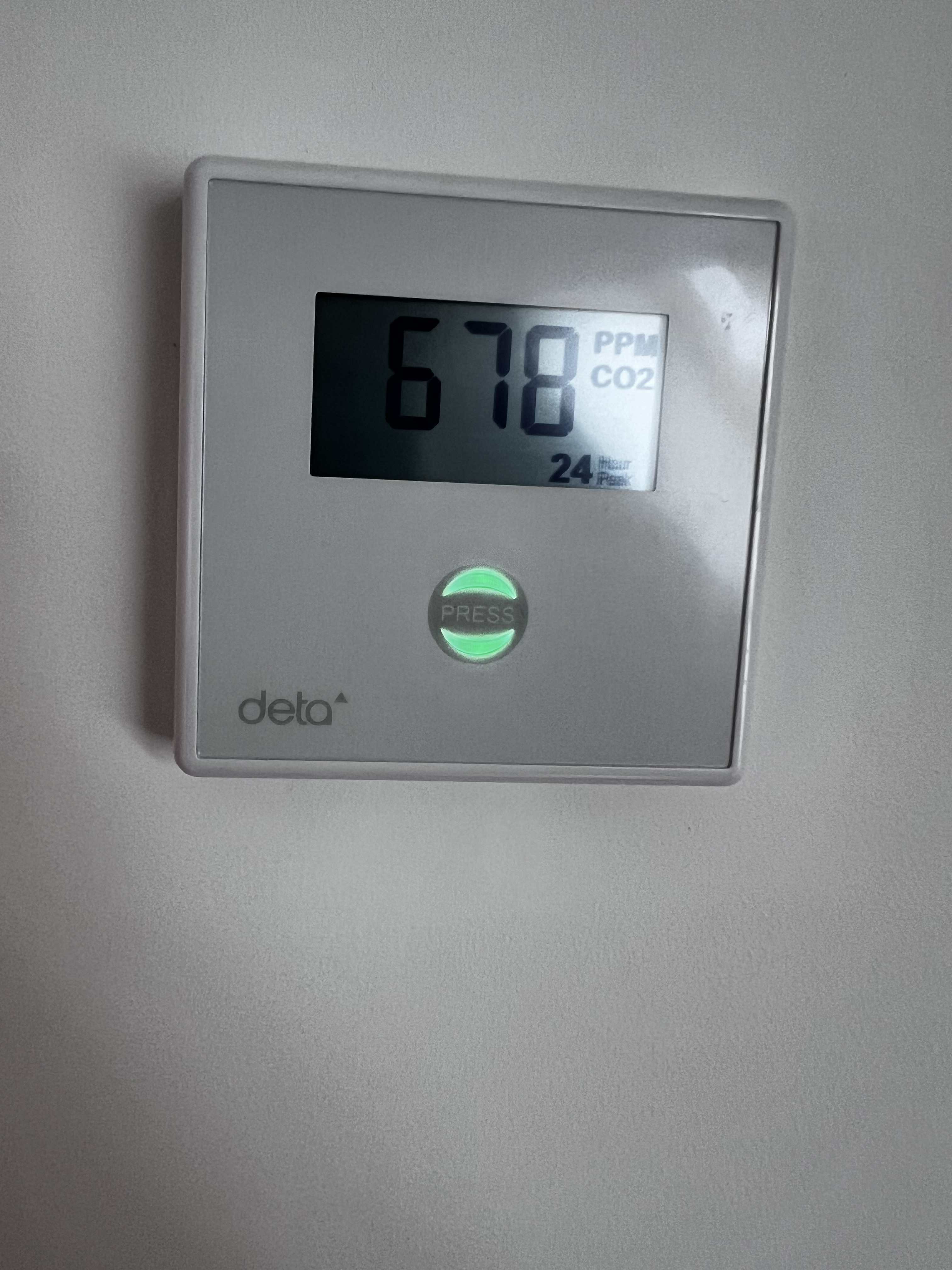

Kelvin Posted January 26, 2025 Posted January 26, 2025 (edited) The one we have is by Deta. Hardwired. It only lights up when you press the button and it’ll cycle through 8hr average, 24hr average, and 24hr peak. It will display Green, Amber, or Red depending on the level of CO2 detected. Currently showing 24hr peak. Edited January 26, 2025 by Kelvin 1

JohnMo Posted January 26, 2025 Posted January 26, 2025 We use Deta, as linked above. Been ticking away without issue for a couple of years. 29 minutes ago, SteamyTea said: am sure I have asked this before, why a CO2 detector To show the people living in the building it is being ventilated correctly. 43 minutes ago, MikeSharp01 said: Where is the sensor, I dimly recall it has to be no more than 300mm above the floor. Between 1.4 and 1.6m from floor if wall mounted. https://www.gov.scot/publications/building-standards-technical-handbook-2020-domestic/3-environment/3-14-ventilation/

Kelvin Posted January 26, 2025 Posted January 26, 2025 (edited) 1 hour ago, MikeSharp01 said: Where is the sensor, I dimly recall it has to be no more than 300mm above the floor. It doesn’t specify as far as I can remember other than it must be hard wired, easily visible, not covered up, not at the head of the bed, not in corners, good airflow. There are other guidelines about what it displays and how it’s displayed. It also shouldn’t have an alarm as folk will switch them off. We also fitted one in the smaller guest bedroom and the peak reading is much higher. https://www.gov.scot/binaries/content/documents/govscot/publications/advice-and-guidance/2017/11/building-standards-domestic-ventilation-supporting-guidance/documents/building-standards-domestic-ventilation-supporting-guidance-version-2.1-november-2017/building-standards-domestic-ventilation-supporting-guidance-version-2.1-november-2017/govscot%3Adocument/Building%2Bstandards%2Bdomestic%2Bventilation%2Bguidance%2C%2BNovember%2B2017.pdf Edited January 26, 2025 by Kelvin
JohnMo Posted January 26, 2025 Posted January 26, 2025 10 minutes ago, Kelvin said: 1 hour ago, MikeSharp01 said: Where is the sensor, I dimly recall it has to be no more than 300mm above the floor. It doesn’t specify as far as I can remember It does Unless otherwise indicated by the manufacturer, a carbon dioxide monitor, with or without an integral detector, should be mounted between 1.4m and 1.6m above floor level. A carbon dioxide detector head (or monitor if integrated) should not be sited within 1m of the expected location of a bed-head.
Kelvin Posted January 26, 2025 Posted January 26, 2025 Ah right. I may have mixed up the detector and separate head unit. Ours are integrated and at 144cm. I cut the holes for them so that might be just good luck but more likely under instruction from the electrician.
