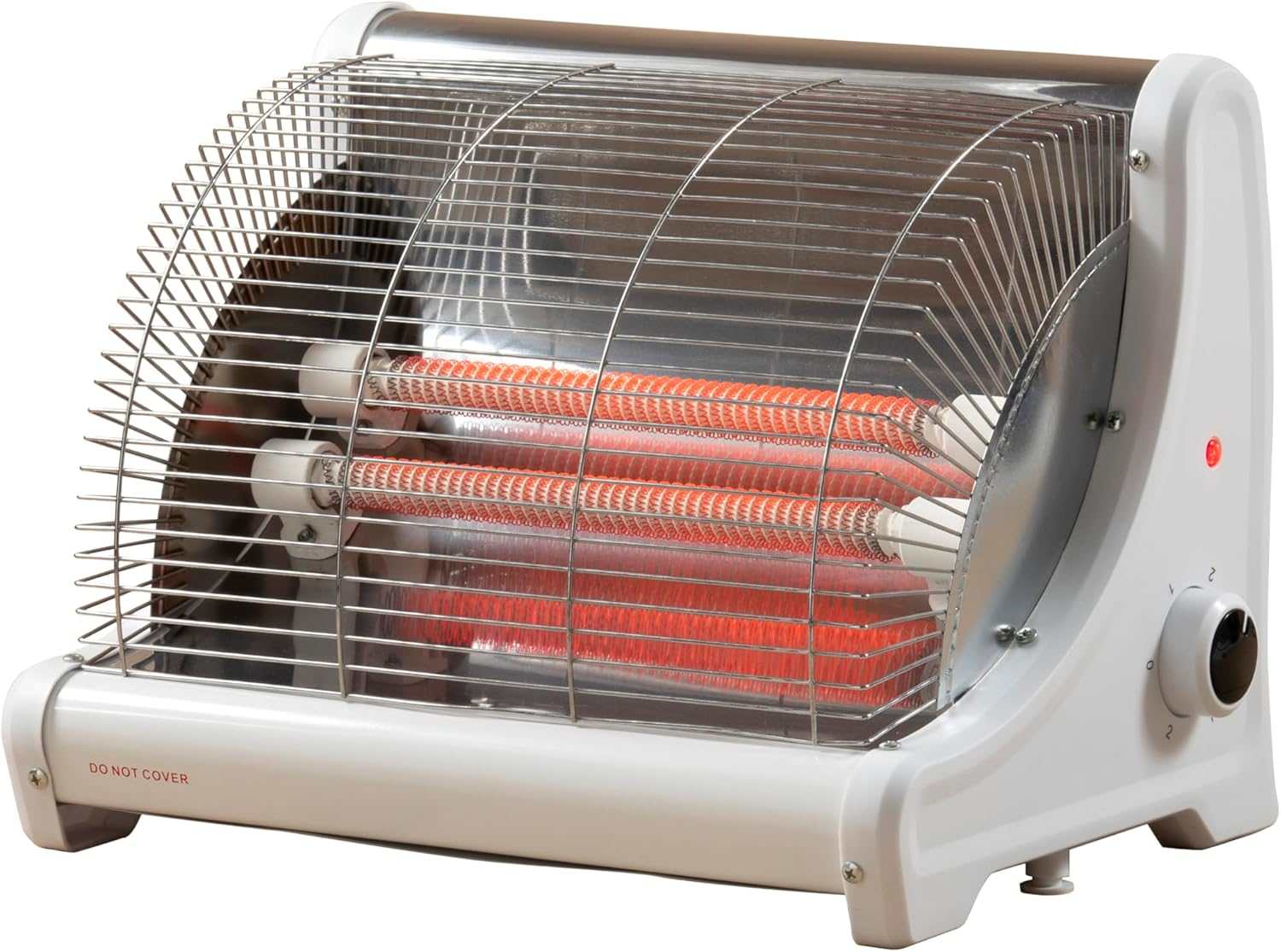

SteamyTea Posted Saturday at 09:00 Share Posted Saturday at 09:00 https://www.amazon.co.uk/Daewoo-Ceramic-Settings-Portable-Indicator/dp/B0CNKJPY7Z Link to comment Share on other sites More sharing options...
