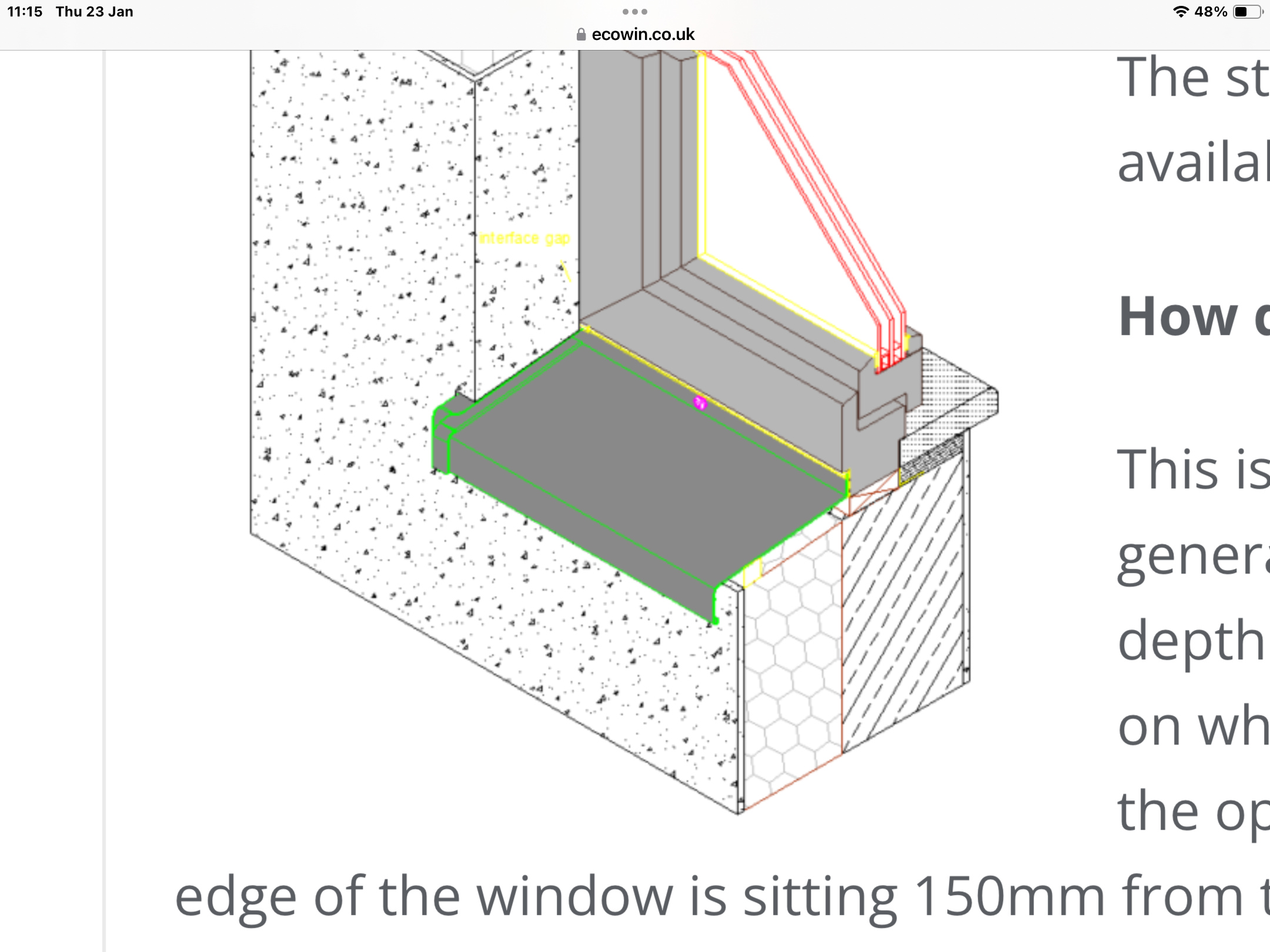

LaChab Posted Wednesday at 22:37 Author Share Posted Wednesday at 22:37 @Mike I must confess I haven't considered the cills as much as I perhaps should have! It's been a bit of a journey deciding on the window design. The Internorm salesman showed us some aluminium cills that looked quite good. They attach to the "extra lump" that appears underneath the window. They've got upstands at each end, which makes them quite robust. Much better than the rather flimsy ones we've got now. I've only arranged for the sides and top of the reveal to be rendered to stop beads. The bottom is just being finished with a stop bead on the vertical surface. Then I was going to paint the bottom reveal with liquid membrane, as I've seen on here, and possibly even add a strip of actual membrane. The windows are going to be 120mm inset, so about 150mm cills. Hope that makes sense! Link to comment Share on other sites More sharing options...
Mike Posted Wednesday at 23:56 Share Posted Wednesday at 23:56 1 hour ago, LaChab said: I must confess I haven't considered the cills as much as I perhaps should have! It's been a bit of a journey deciding on the window design. The Internorm salesman showed us some aluminium cills that looked quite good.... I've only arranged for the sides and top of the reveal to be rendered to stop beads. The bottom is just being finished with a stop bead on the vertical surface Sounds good, though I was thinking of something a little different! A sill would normally project through the render, where the red arrow is below (looking at the outside now, not the inside). But if you're rendering before the window's fitted, the render will be in the way, unless you make some provision for it, or have another solution - stone sub-sill maybe? Link to comment Share on other sites More sharing options...

LaChab Posted yesterday at 09:26 Author Share Posted yesterday at 09:26 @Mike You're right, it does look a bit of a potential problem.Leaving the render until after the windows are fitted would be a real pain though. I checked with Internorm, and they were ok with doing the render first, so I didn't think much more about it! I'll bring it up with the surveyor when they come to measure up. 1 Link to comment Share on other sites More sharing options...

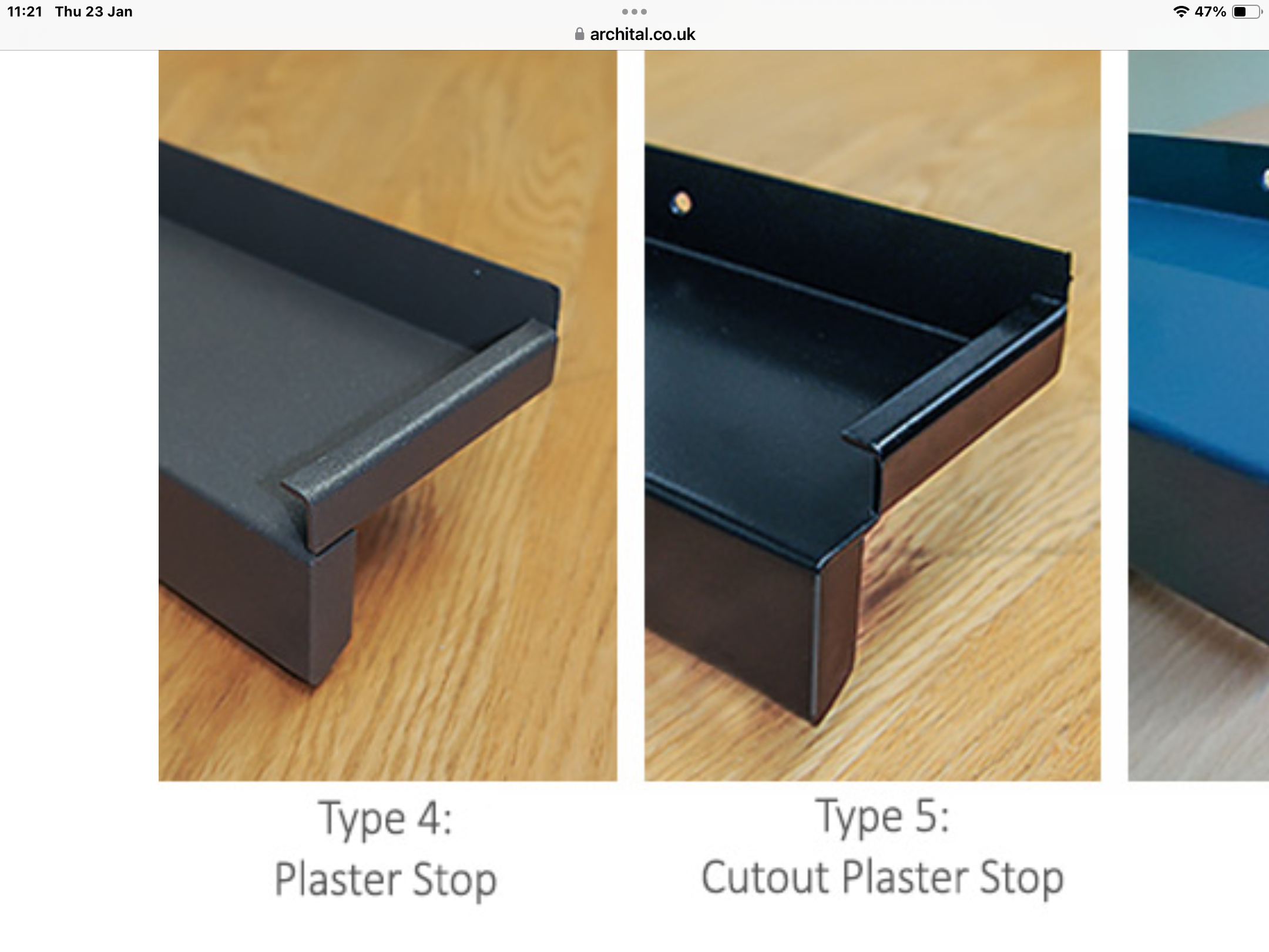

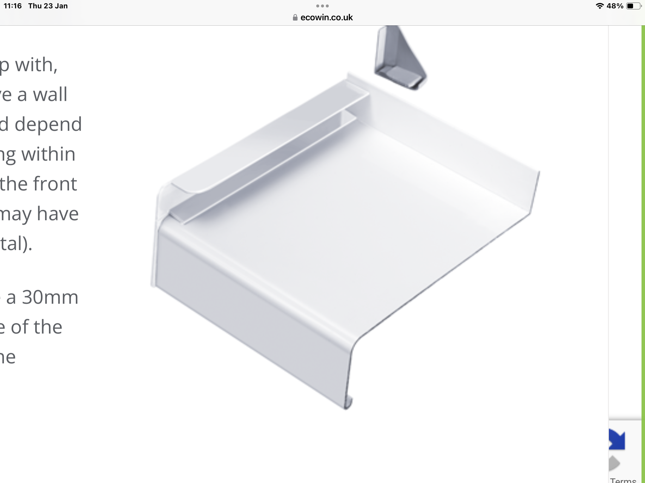

Russell griffiths Posted yesterday at 11:14 Share Posted yesterday at 11:14 @LaChab if you render the reveals, how will you prevent water going down the sides of the window cill. from the cills we purchased I thought they went in first and the render came down onto the cill. 1 Link to comment Share on other sites More sharing options...

LaChab Posted yesterday at 11:31 Author Share Posted yesterday at 11:31 @Chanmenie @Russell griffiths Yes, cills first sounds much better. Trouble I hink that would mean having a second lot of scaffold just to do the sides of the reveals. I was intendiung to use the liquid membrane you like before the cill is fitted, so perhaps that and something suitable (silicone? tape?) between the upright side of the cill and the side of the reveal might be ok. Wouldn't be ideal, but probaly waterproof........ The reveals havn't been rendered yet (weather!), so if I found the section of the cills I could "block of" just the lower bit of side render, then patch it in by ladder after the cills have been fitted. Link to comment Share on other sites More sharing options...
LaChab Posted yesterday at 11:36 Author Share Posted yesterday at 11:36 @Russell griffiths Yes, those pictures make the problem a bit obvious! Did you cut into the foam for your cills? We're using thin coat render, so wouldn't be a huge overlap without going into the foam, but still be a big improvement. Link to comment Share on other sites More sharing options...
