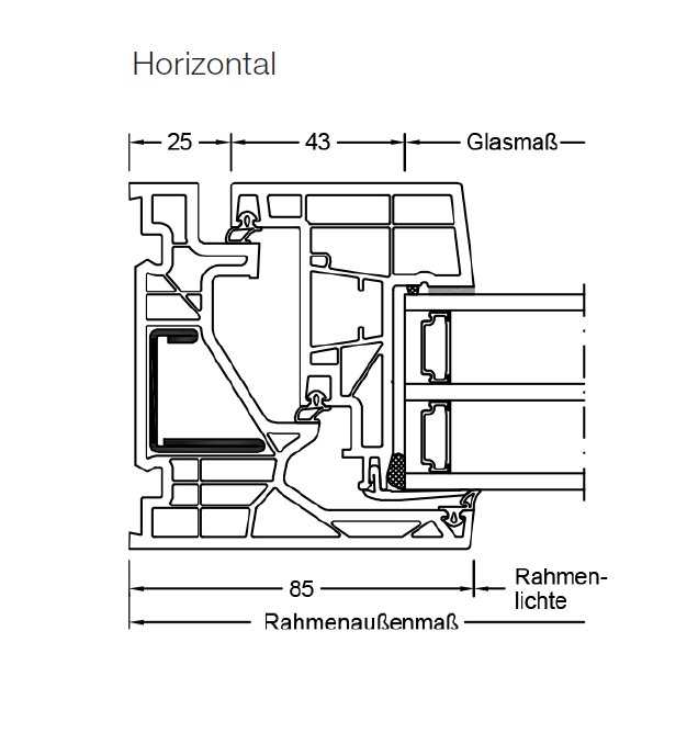

LaChab Posted 15 hours ago Author Share Posted 15 hours ago @Redbeard I was intending to just line the reveal with plasterboard, so with a 10mm gap round the windows AFIC see that doesn't really give room to stick tape. Also we're intending to use KF520s, which have got a rather tight tolerance inside. Link to comment Share on other sites More sharing options...

Redbeard Posted 14 hours ago Share Posted 14 hours ago (edited) 5 minutes ago, LaChab said: @Redbeard Sorry if I'm misunderstanding, but with a 10mm gap and 15mm of PB, there would only be <5mm for the tape. The factory fitted tape seems much the best, but what a ridiculous price! I guess it depends how much of the stile you can 'lose'. Usually you can 'lose' up to 20mm without the end result looking stupid. If I had the set-up you have I'd maybe use 2 x 9.5mm plasterboard and once 3mm skim was on you'd have more room for tape. Edited 14 hours ago by Redbeard Link to comment Share on other sites More sharing options...
Redbeard Posted 14 hours ago Share Posted 14 hours ago 11 minutes ago, LaChab said: Also we're intending to use KF520s, which have got a rather tight tolerance inside. Just searched for what KF520s are! Looks enough space there for what I have described but I may be wrong, or you may just like to see a lot more frame than I'm happy with. Link to comment Share on other sites More sharing options...
LaChab Posted 14 hours ago Author Share Posted 14 hours ago @Redbeard Thanks for looking! I'm quite likely misinterpreting the diagram, but as far as I can see there's only about 15mm of frame on the inside, before the opening bit (25mm less about 10mm) And they're such nice looking windows! Link to comment Share on other sites More sharing options...
Redbeard Posted 14 hours ago Share Posted 14 hours ago Ah... Are they inward-opening? I had assumed they were outward-opening, but I cannot find confirmation of that. Link to comment Share on other sites More sharing options...
Redbeard Posted 14 hours ago Share Posted 14 hours ago (edited) @LaChab, Google translate suggests that Rahmenaussenmass means 'external frame dimensions', suggesting (to me...) that that 85mm section is inside. But perhaps I am misunderstanding. Edited 14 hours ago by Redbeard Link to comment Share on other sites More sharing options...
MikeSharp01 Posted 14 hours ago Share Posted 14 hours ago 17 minutes ago, LaChab said: Thanks for looking! I'm quite likely misinterpreting the diagram, but as far as I can see there's only about 15mm of frame on the inside, before the opening bit (25mm less about 10mm) And they're such nice looking windows! Are they inward opening or outward is the large flat side on the inside then? Link to comment Share on other sites More sharing options...

Redbeard Posted 14 hours ago Share Posted 14 hours ago ''Posted 15 minutes ago (edited) ''@LaChab, Google translate suggests that Rahmenaussenmass means 'external frame dimensions', suggesting (to me...) that that 85mm section is inside. But perhaps I am misunderstanding. Edited 14 minutes ago by Redbeard'' No, I got that completely ar*e-about-face!! @LaChab I think you must be right and I am wrong. So they are inward-opening? Link to comment Share on other sites More sharing options...
LaChab Posted 13 hours ago Author Share Posted 13 hours ago @Redbeard They are. And the limited width of the internal frame is why I don't think taping to it is the way to go. And worsened by the installer virtually insisting on a 10mm gap around the frame. I'm probably just being obsessive, but relying on foam for an airtight seal just doesn't seem right. I'll ask more detailed questions about fitting of some other Internorm dealers. Link to comment Share on other sites More sharing options...
