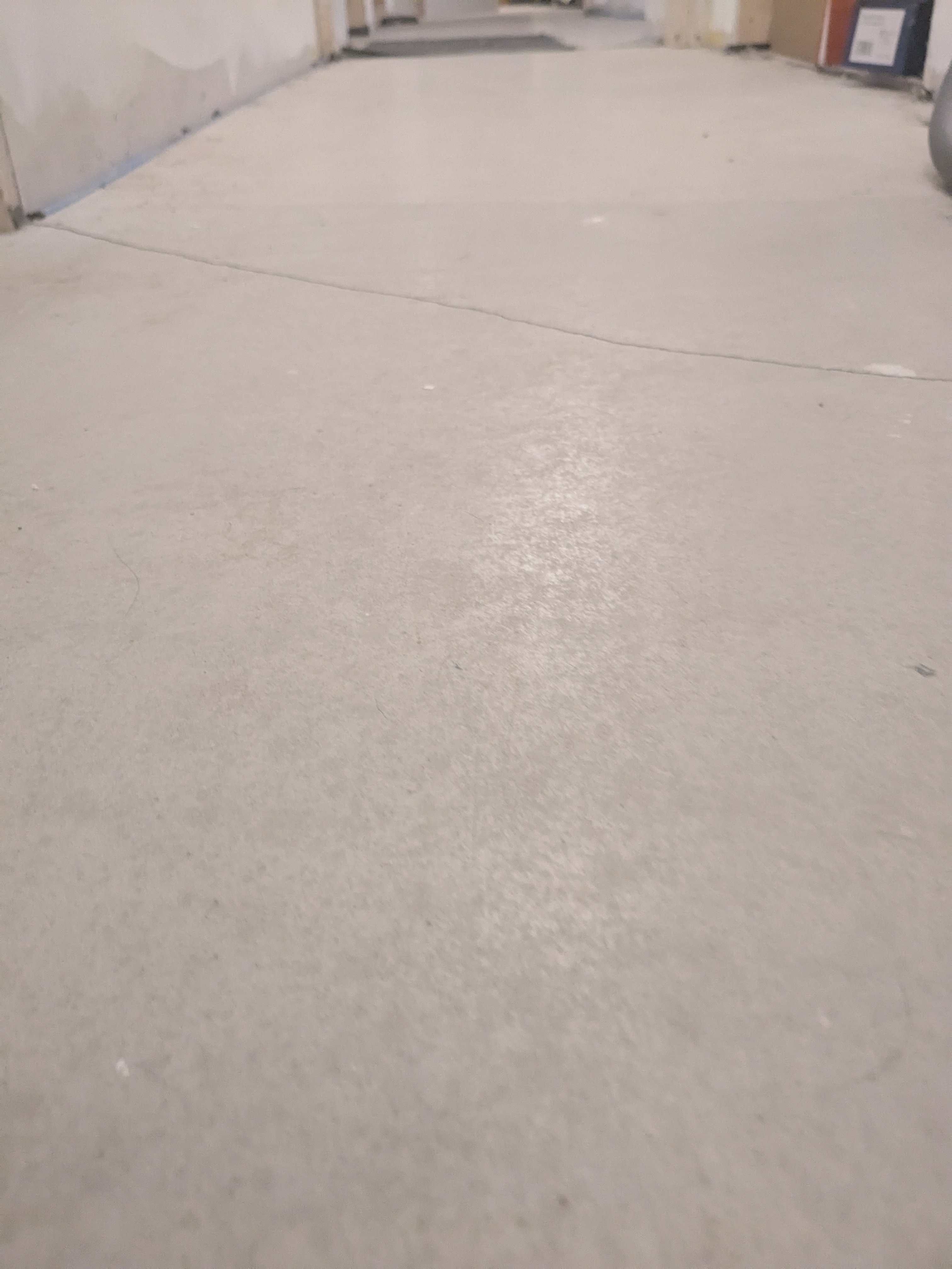

CalvinHobbes Posted January 19, 2025 Posted January 19, 2025 So we have amtico lvt floor tiles which we need to put down ourselves on a chemfloor. Needs must. Homebase has good reductions on paints which is good so whilst looking found this floor primer cempolay. I know we need it to be compatible with whatever adhesive we use. Any suggestions? Also wondering what tools..the roller from Screwfix and some sort of soft hammer??? I know...yikes.

CalvinHobbes Posted January 19, 2025 Author Posted January 19, 2025 Thanks, fair point. We have chemfloor and it was well put down, only one crack and we have to deal with the breakers too. Not quite sure about them. So hopefully not too much scraping.

Chanmenie Posted January 19, 2025 Posted January 19, 2025 1 hour ago, Thorfun said: Out of interest, can you lay Amtico on some form of underlay to remove any small imperfections on the underlying floor? Or does it not work that way? There’s two types, glue down and click, the click version can have an underlay or has a built in underlay and can be used on slightly uneven floors. The glue down does not have underlay and needs a perfect base to lay on. 1 1
Chanmenie Posted January 20, 2025 Posted January 20, 2025 You don’t really need a roller, but probably a primer then 3mm latex screed then glue them down. Why would you need a soft hammer for glue down ? I used the Ardex 175 adhesive on my upstairs landing and bathroom as that was what the flooring supplier had. It worked well 1
