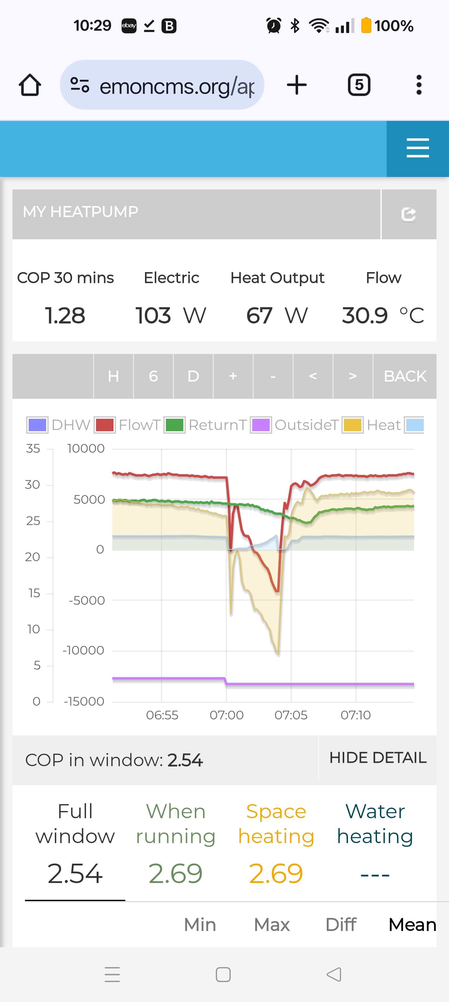

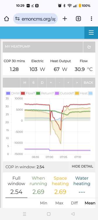

JohnMo Posted Friday at 10:32 Share Posted Friday at 10:32 (edited) Just to give you area of what happens during a defrost. This mine So green is the return temp, that drops around 3 degs through the defrost cycle. The flow temp (red) drops a good 17 degs. However the time period is 5 mins in total. Run time between defrosts being about 1hr and 10 mins. Edited Friday at 10:39 by JohnMo 1 Link to comment Share on other sites More sharing options...
