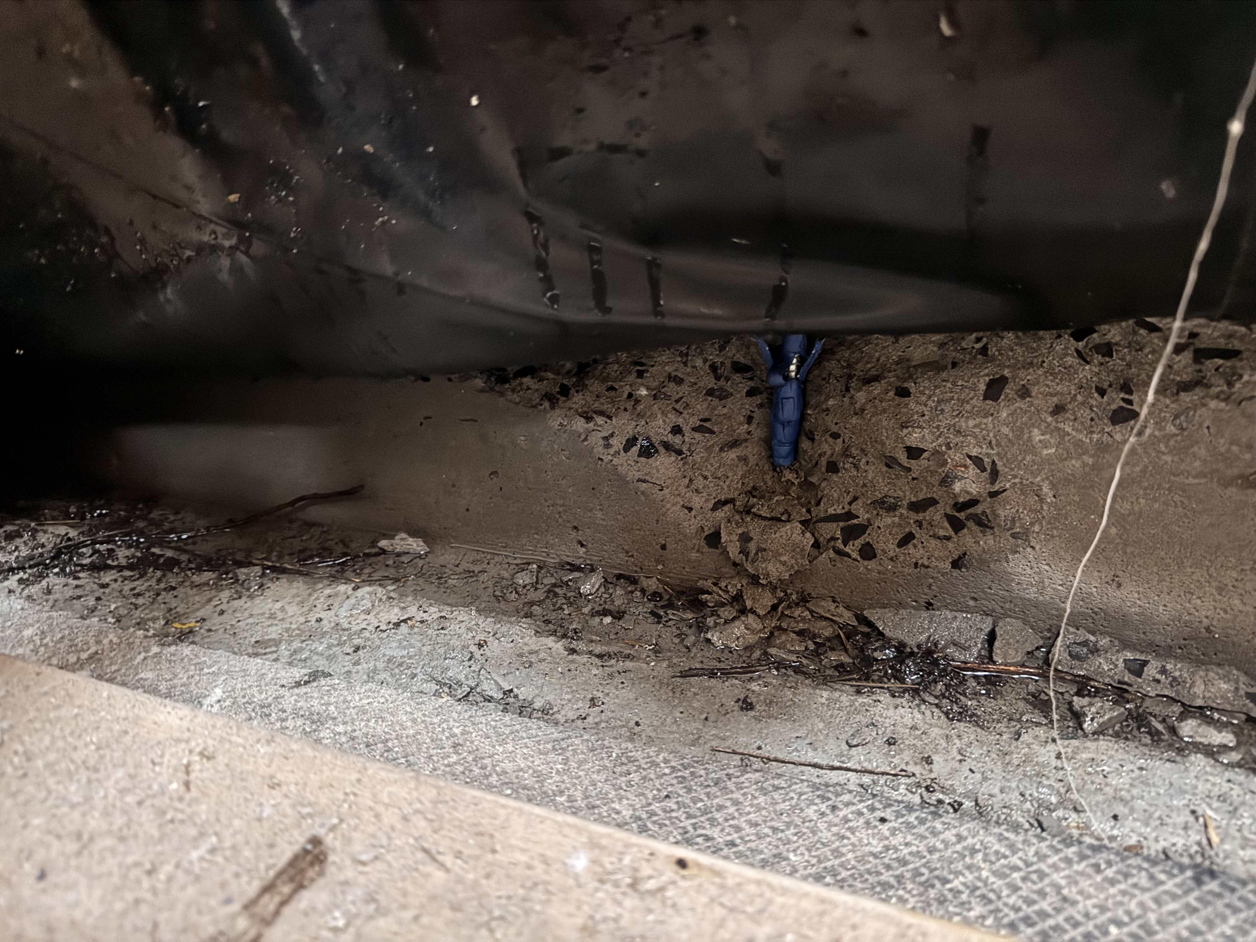

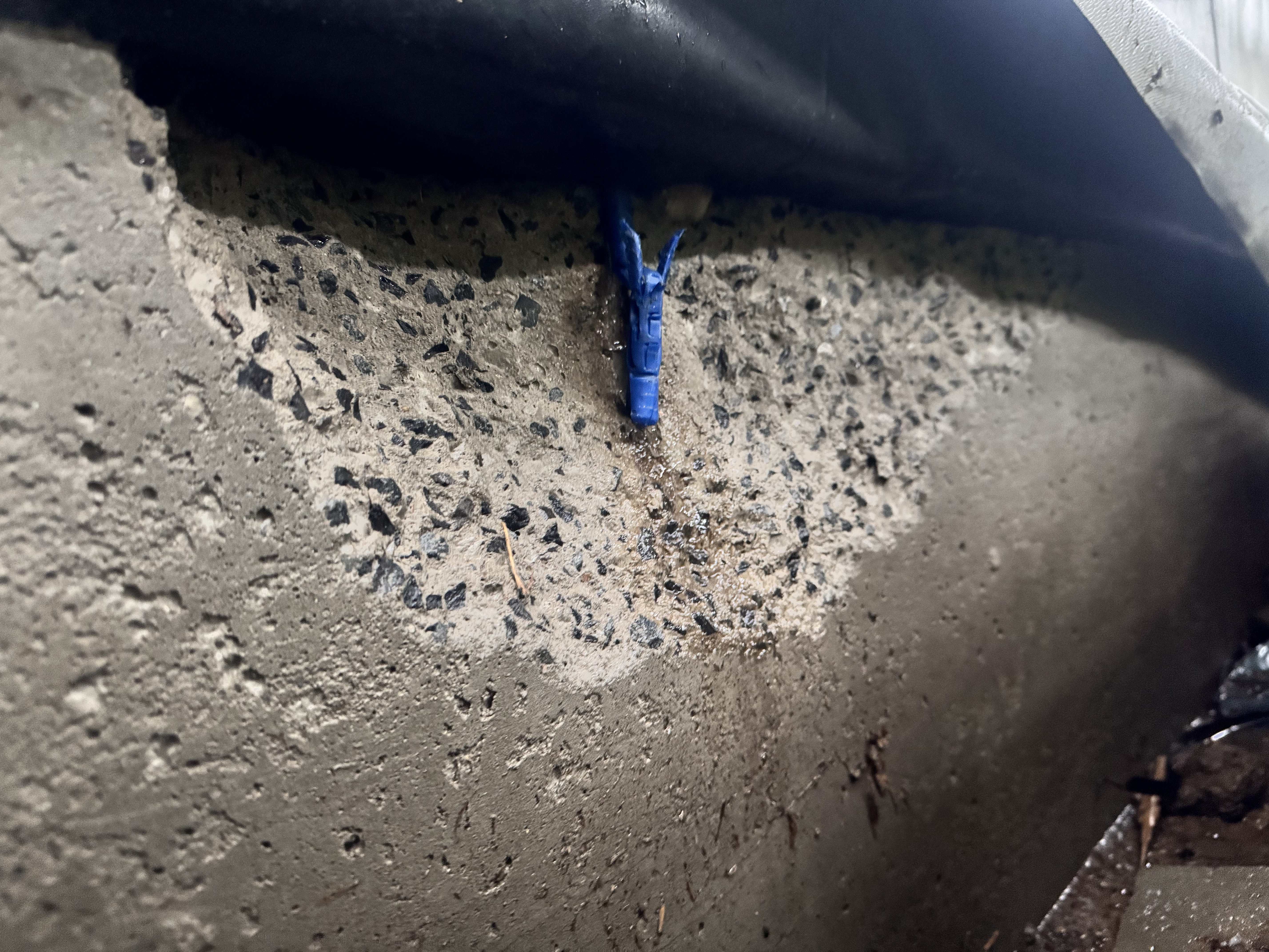

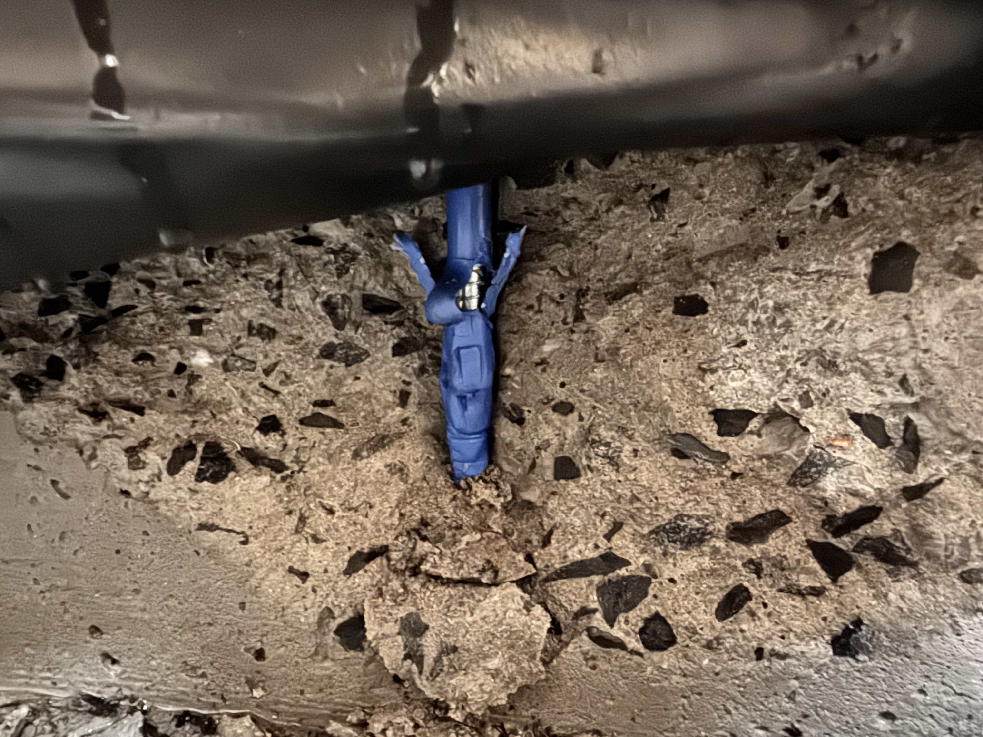

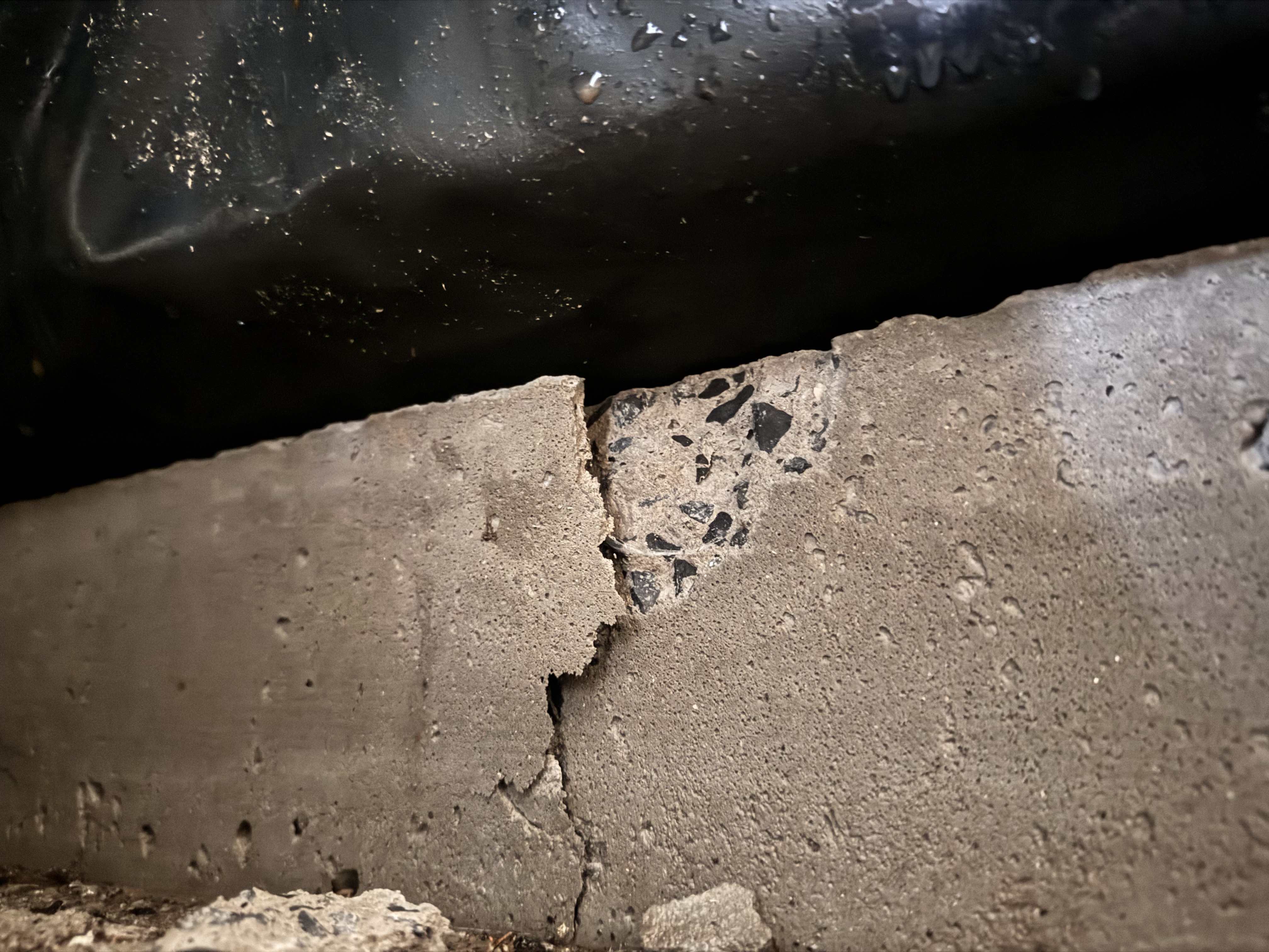

junglejim Posted January 5 Posted January 5 (edited) Just when one problem is solved another surfaces… self building is definitely stressful! I’ve discovered today that the concrete upstand around the perimeter of our foundation (cast as part of foundation raft slab) has been damaged (presumably when the TF company fitted the soleplate) which has caused water ingress… luckily I haven’t insulated and screed yet. I didn’t notice earlier because we weren’t wind and watertight so assumed it was from window opening and area is also concealed under dpc overlap. I’ve messaged the TF company for help but wonderful what everyone’s take on this is in terms of responsibility and solutions? I’ve attached a few photos… the upstand is damaged inside and out where 2 fixings are so there’s 2 photos for each location one from inside ABs the other from outside. All advice very appreciated. Thank you Edited January 5 by junglejim
junglejim Posted January 5 Author Posted January 5 Hoping that this is repairable with some kind of mortar but worried it might be a weak spot so want to make sure it’s done right.

Russell griffiths Posted January 5 Posted January 5 I’d be more worried that they have fixed close to the edge, with a 140 sole plate they should be 70mm in from the edge its a bit shit to be honest and I would be checking every fixing. I wouldn’t be happy with the sole plate fixed down with plastic plugs either, do you have frame anchors going down into that concrete as well. 1
junglejim Posted January 5 Author Posted January 5 (edited) 56 minutes ago, Russell griffiths said: I’d be more worried that they have fixed close to the edge, with a 140 sole plate they should be 70mm in from the edge its a bit shit to be honest and I would be checking every fixing. I wouldn’t be happy with the sole plate fixed down with plastic plugs either, do you have frame anchors going down into that concrete as well. Yes I share that concern. I’ve been around the perimeter and checked the concrete. As far as I can tell it’s blown in 3 locations so the rest seem good. Not sure I can remedy the anchoring at all as the building is up and fixed to the sole plate. I’m not sure why they’ve used plastic plugs. Engineer drawings specify shot firing (I’m not sure what that is) I’m speculating but wondering if shot firing would have been more likely to damage the concrete? I don’t know if there are frame anchors as well… but of a can of worms here and not sure how to broach with the company 😬. Edited January 5 by junglejim

saveasteading Posted January 6 Posted January 6 The plastic plug method may well be OK, as the loads are well spread through the sheer number of fixings. 600 centres? But it is not for us to say, when you have an SE and supposedly expert contractors. There may be more damage, perhaps cracked but hanging in for the present. Something is wrong. Too close to the edge is likeliest. And/or Not the right fixings or hammered in too hard. Yes epoxy will sort it but the SE should specify it. Or the contractor present you with a formal remedial proposal which is not a cement and sand patch. 1
jack Posted January 6 Posted January 6 I was whizzing through this on my phone when I answered and didn't realise three of them were affected, or that they'd used the wrong fixings. A one-off might be unlucky, but three suggests a pattern. No way I'd be happy just repairing the cracked stuff - the fixings need to be done properly. 16 hours ago, junglejim said: Not sure I can remedy the anchoring at all as the building is up and fixed to the sole plate. Can they not go back and add fixings at this stage? Leave the ones currently in place and put the correct ones in the gaps between them. 10 hours ago, JamesP said: That is a poor job as others have mentioned. I used some concrete bolts. It is critical to use the exact size masonry bit and the hole is cleaned out before fitting the bolt otherwise it can split the concrete. These are what was specified (and used) on our house. I don't like the idea of shot-fired fixtures into concrete that has shown a propensity to crack, so perhaps you could have a word with your SE about using something like this instead? As others have said, it's the SE who needs to be your guide here. The builder is reponsible for rectifying the fixings. 1
junglejim Posted January 6 Author Posted January 6 Update: Thanks for everyone’s thoughts and advice. Below is the reply from the engineer today. Feel much better having this in writing but still a little weary given the concerns raised on here. “I can confirm the 140mm long Rawlplug screw with plastic plug is the preferred fixing for timber sole plates to concrete up-stands. This type of fixing alleviates any excessive lateral forces within the up-stand unlike an expanding bolt fixing.” 1
