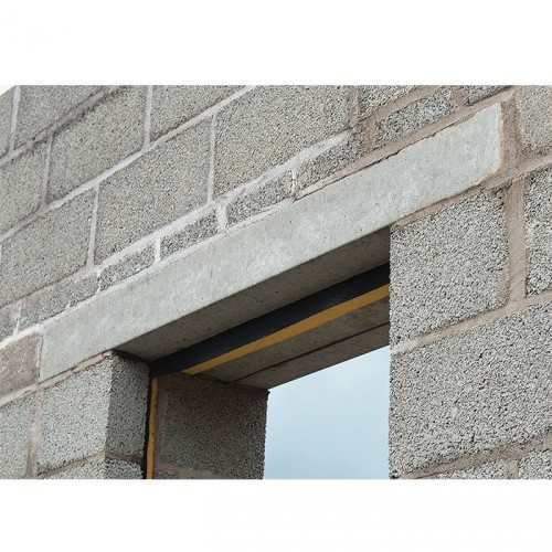

DevilDamo Posted Sunday at 21:01 Share Posted Sunday at 21:01 Unless it was to massively improve the u-value, I don’t know why internal wall insulation was even specified in conjunction with a 100mm cavity. May also working out the cost and time difference between IWI and wider lintels. Link to comment Share on other sites More sharing options...

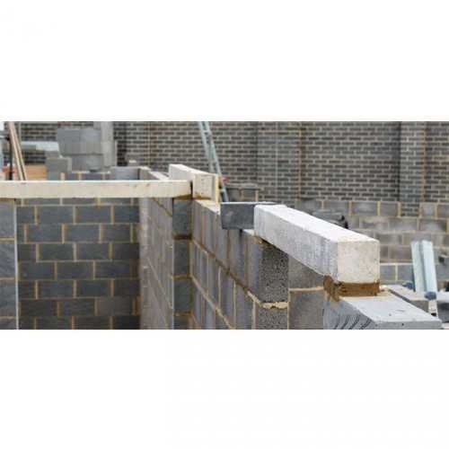

Iceverge Posted Sunday at 21:15 Share Posted Sunday at 21:15 10 minutes ago, DevilDamo said: Unless it was to massively improve the u-value, I don’t know why internal wall insulation was even specified in conjunction with a 100mm cavity. May also working out the cost and time difference between IWI and wider lintels. Wider lintels won't be needed unless you're using those silly catnic things. Just use separate precast concrete one on each leaf. Link to comment Share on other sites More sharing options...
joe90 Posted Sunday at 21:25 Share Posted Sunday at 21:25 7 minutes ago, Iceverge said: Just use separate precast concrete one on each leaf. +1 and no cold bridge. Link to comment Share on other sites More sharing options...

DevilDamo Posted Sunday at 21:59 Share Posted Sunday at 21:59 42 minutes ago, Iceverge said: Just use separate precast concrete one on each leaf. Suppose that does work with a rendered block wall as per the OP’s situation. Link to comment Share on other sites More sharing options...
