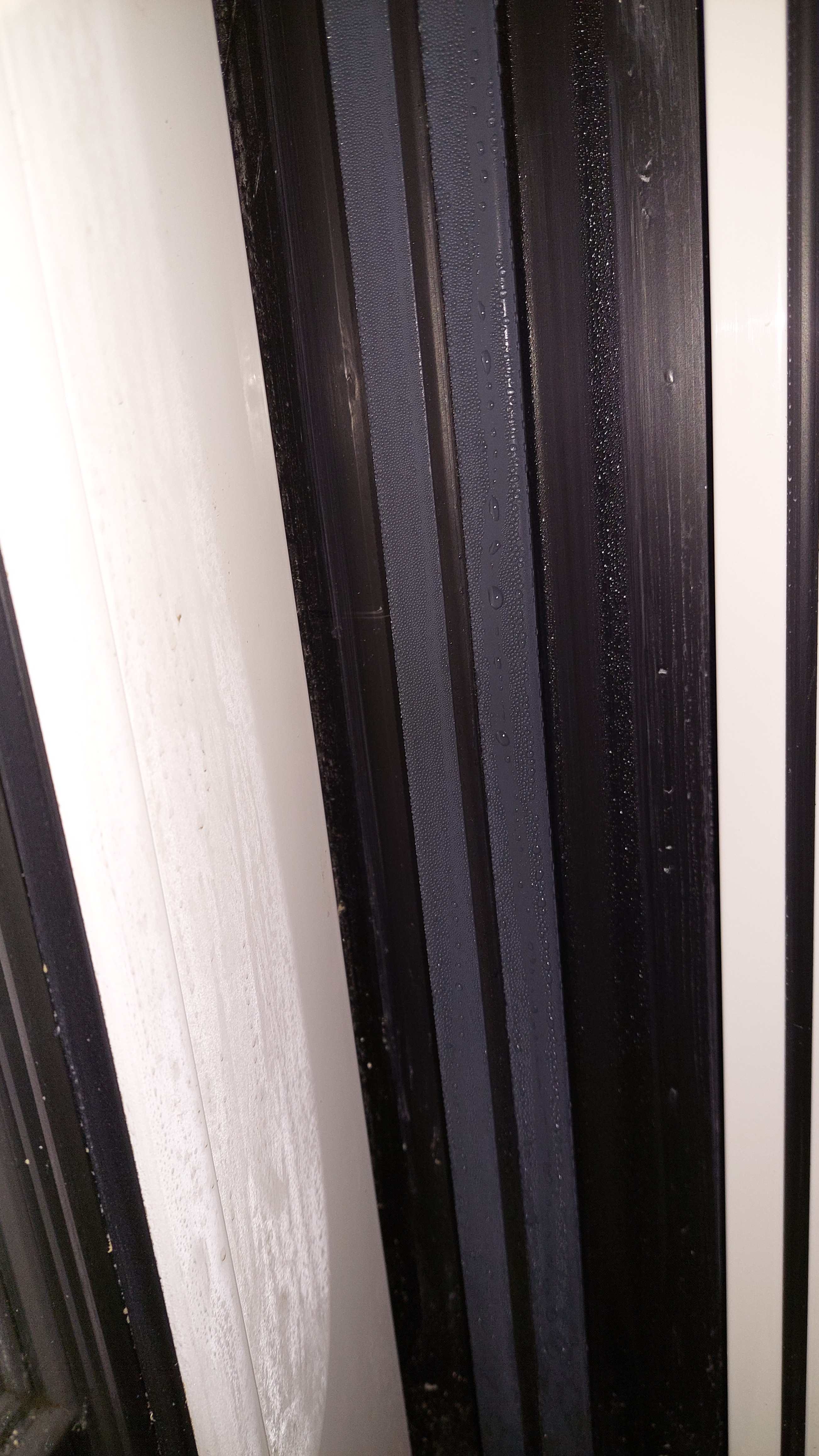

Condensation on aluminium door frame
Our builder has recently installed a large aluminium sliding door.
The frame includes a "thermal spacer" that is between the inside and outside frames. The manufacturer claims this will insulate the inside frame and stop it getting cold.
Following installation, we have found that we frequently get condensation on the frame (but not the glass). If I clean the condensation, it returns in about 24 hours. The builder says this is because we have too much humidity and not enough ventilation.
I have purchased a humidity meter and read up on the science of dew points and and the installation instructions for the window system: Our humidity level is typically 50-55%. This seems pretty normal and nothing exceptional. The calcs suggest that with an internal temperature of 20°C and humidity of 50%, the dew point is 9.3°C. This means condensation is expected to form below this temperature. It is colder than this outside for most of the winter.  The installation instructions for the window system say the cill should be on plastic packers to insulate it from the masonry and the frame should be fixed through the thermal spacer (plastic bar). I think our cill sits directly on the masonry and is held in with metal clips that connect it to the masonry. Taken together, I think the problem is that our frame isn't correctly insulated from the masonry, the frame gets cold and this leads to the condensation.
Please can I ask:
a. Is it normal for aluminium frames to be very cold on the inside? Is condensation normal?
b. Is it most likely caused by our (excess) humidity, poor frame design or incorrect installation?
c. Is my explanation plausible or is there something else I have missed?

Get yourself a cheap IR thermometer and see what the temperatures actually are.
Would not be unusual for an aluminium frame to cold on the inside, the thermal conductivity in around 236 W.m-1.K-1

Thank you for the many suggestions and comments. I really appreciate it.
Some more information:
1.       The house is an old building with (empty) cavity walls. It has recently had a large extension. The extension has foam cavity insulation.
2.       The majority of the original house has double glazing without trickle vents. Some newer windows have vents. It doesn’t have MVHR.
3.       The extension has an aluminium window, aluminium sliding door and an aluminium patio door. All of the aluminium units have the condensation problem but is much worse on the sliding door.
4.       In each case, the aluminium frame cill sits directly on the outer masonry. There are no packers underneath as specified in the install instructions.
5.       The frame is anchored (at the sides and top) to the inner masonry using metal ties. The majority of the ties appear to be in the frame rather than anchoring through the thermal break (as specified in the install instructions).
6.       My working theory is that the cill position and/or the metal ties have effectively 'by-passed' the thermal break and created a cold bridge between the inner/outer frame and the inner/outer masonry. The window system manufacturer specifies that the cill should be on packers and the anchored through the thermal break. We don’t have either of these.
7.       At the sides and top, the small 8-10mm gap between the frame and the masonry is filled with expanding foam.
8.       We were advised not to have cavity closers because the plaster finish would crack. Instead the cavities are closed with plywood. This is starting to feel like a big mistake!
9.       We have identified that there is no foam cavity insulation below the largest aluminium frame. It is just a cavity. Maybe, this is contributing to the condensation problem (which is much worse at the bottom).
10.   The frame is noticeably colder at the bottom and get less cold further up. Similarly, the condensation is much worse at the bottom and less higher up. This correlates with the theory that the cill is sat directly on the masonry and is a cold bridge to the outside.
11.   The plastering was completed about a month ago. It has long since changed colour and appears to be dry. We thoroughly dried the frames to remove all condensation. It returned 24 hours later.
12.   We are aware that the problem may be exacerbated by the recent plastering but given the humidity level is now around 50% and unlikely to get much lower, the dew point calculation suggests dew (condensation) is likely over a wide range of winter temperatures and realistic inside humidity levels when the inside frame is at a much lower temperature than the room.
13.   Thank you for the suggestion to measure the frame temperature with an IR thermometer. I will try this. I suspect it is cold (near outside) temperature.
14.   If it only happened a few times a year, we could probably live with it. The problem is we haven’t had it long enough yet to know if this will be the case. The big question, is condensation normal on modern aluminium frames? I get the sense that this shouldn’t regularly happen and there is a problem in either the product or, more likely, the installation.

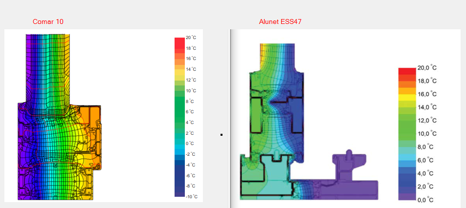

As suggested, I purchased a thermal camera. The results were very revealing. From the inside, the metal frames are the coldest part of the room (much colder than the glass within them). From the outside, the frames are the hottest part of the building. They glow "red hot" on the camera.
In summary, the changes suggested by the supplier have helped a little. However, the fundamental problem remains. When the outside temperature is zero, the bottom edge of the inside frame is around 3 degrees C. This is well below the dew point (at any reasonable temperature and humidity) so it is no surprise that condensation forms there. In the same house, our plastic double glazed frames are around 13 degrees C. I don't think the thermally broken aluminium units are fit for purpose, but others may disagree?

The doors use the "Alunet ESS47 profile
That's useful. Their technical manual (https://www.alunetsystems.co.uk/wp-content/uploads/ESS47-CATALOGUE_ALUNET_JUNE_2023.pdf gives the u-value for the frame as 4.18 W/m².K - which is poor.
For comparison, the first Passivhaus-certified aluminium window I can across from a UK company (https://database.passivehouse.com/en/components/details/window/comar-architectural-aluminium-systems-the-parkside-group-limited-comar-10-1657wi03?), has worst-case frame u-value of 0.77 W/m².K, which would therefore loose 82% less heat through the frame.
You see the difference in these isotherms. The Comar 10 keeps the cold on one side and the warmth on the other. The Alunet doesn't.
