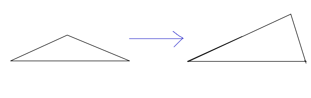

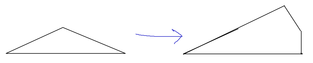

Garald Posted December 27, 2024 Author Posted December 27, 2024 (edited) Another possibility (thinking of the ground-floor neighbors on the other side of the backyard, who may lose some light if my wall just becomes 4.5m higher, though windows would help): Is this sort of thing ever done? Is it feasible? Alternatively: Edited December 27, 2024 by Garald

Mike Posted December 28, 2024 Posted December 28, 2024 On 27/12/2024 at 22:31, Garald said: Is it feasible? Expand Yes, either could be done in principle, and the vertical part of the 2nd one could either be constructed in masonry or timber. However once the roof gets steep like that you'll need to check out the maxinmum inclination of the pantiles; either slate and zinc could be used instead & would fit with Parisian style. You'd also need to check & enlarge if necessary the capacity of the left hand guttering, as it will be taking much more of the rainfall due to the longer slope.

Garald Posted December 28, 2024 Author Posted December 28, 2024 On 28/12/2024 at 21:09, Mike said: Yes, either could be done in principle, and the vertical part of the 2nd one could either be constructed in masonry or timber. However once the roof gets steep like that you'll need to check out the maxinmum inclination of the pantiles; either slate and zinc could be used instead & would fit with Parisian style. You'd also need to check & enlarge if necessary the capacity of the left hand guttering, as it will be taking much more of the rainfall due to the longer slope. Expand Right, the vertical side or the very steep side would clearly not be tile. And yes, had just thought of guttering. In fact I have to do something related to guttering on that side at some point. I don't know whether I mentioned it here, but during my recent birthday party, someone rung the door during dinner - no, it wasn't a late guest, it was a random person who informed us that hot water was pouring out of my apartment over passersby like herself. A few days later, the plumber came, and told me it was no biggie - I just have the same illegal plumbing as about 1/4 of the population of Paris: the water leaving the kitchen doesn't go to sewage as it should - it joins the eavestrough. The joints in the eavestrough were not watertight - in fact, the plumber said, they are not even meant to be watertight. The eavestrough got clogged with leaves and other random roof stuff, with the result that the output from unusually massive dishwashing flooded onto the street. The plumber just unclogged the eavestrough with a little vacuum pump of sorts, and told me to just make the plumbing legal the next time I "break my kitchen" (an unromantic expression for that modern vice, kitchen renovations). 1

Garald Posted December 30, 2024 Author Posted December 30, 2024 (edited) On 27/12/2024 at 14:25, Mike said: This would probably be the better option in terms of added value, as it would change the Loi Carrez floor area (the area higher than 1.8m) - worth verifying that with an estate agent? Expand Seeing things strictly from a Loi Carrez perspective (... which is a bit crude from some real estate agents' perspective, but it does give you a main term): The current width of the loi Carrez area in the attic is about 160cm (well, a bit more because of the skylights, even once you discount the stairs, I think; also, these measurements are from the faketitecht's plans - I should verify them myself). The house minus outside walls is about 825cm wide. a) Under the asymmetric plans we started to discuss, the total loi Carrez width would be 825/2 + 160/2 = 492.5cm b) If the attic were scrapped and made into a place with straight walls (not so likely; wouldn't slanted walls from a lighter material be better?), the total loi Carrez width would be 825. Hence we are looking at a ratio of (825/2-160/2)/(825-160) = 1/2. Hah, we could have also got that without computing anything, just given that the house is symmetric. In other words, from a crude Loi Carrez perspective, the 'sophisticated solution' a) is preferable to b) if its cost is half or less of the cost of scrapping and redoing everything. In reality, it's probably rational to prefer b) (if done well) for 60k eur to a) for 100k eur (both figures may be optimistic - and both require me to wait some time to save first). One also needs to add 10k+ to redo the roof insulation no matter what. Either plan puts me above 150m^2, which probably means an architect needs to be involved - bummer. The solution, I guess, is to find a good engineer who works at architectural studio, so that someone in the order of architects could sign off on the thing. There's such a thing as engineer-architects or architect-engineers in France (apparently there's a difference), but Wikipedia tells me they are rare. Edited December 30, 2024 by Garald
Mike Posted December 31, 2024 Posted December 31, 2024 On 30/12/2024 at 20:50, Garald said: Either plan puts me above 150m^2, which probably means an architect needs to be involved - bummer Expand Yes, unfortunately that is necessary - though even below the limit your copro might require you to use one as a condition of giving permission.
