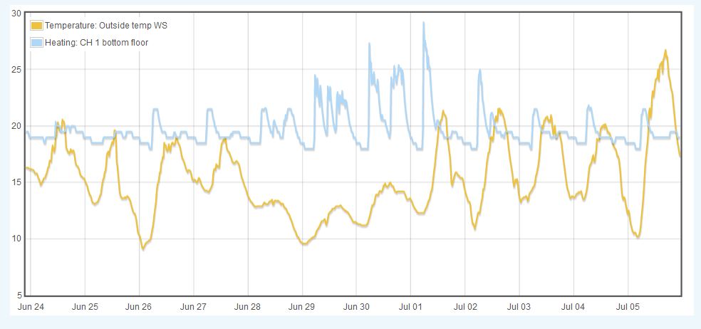

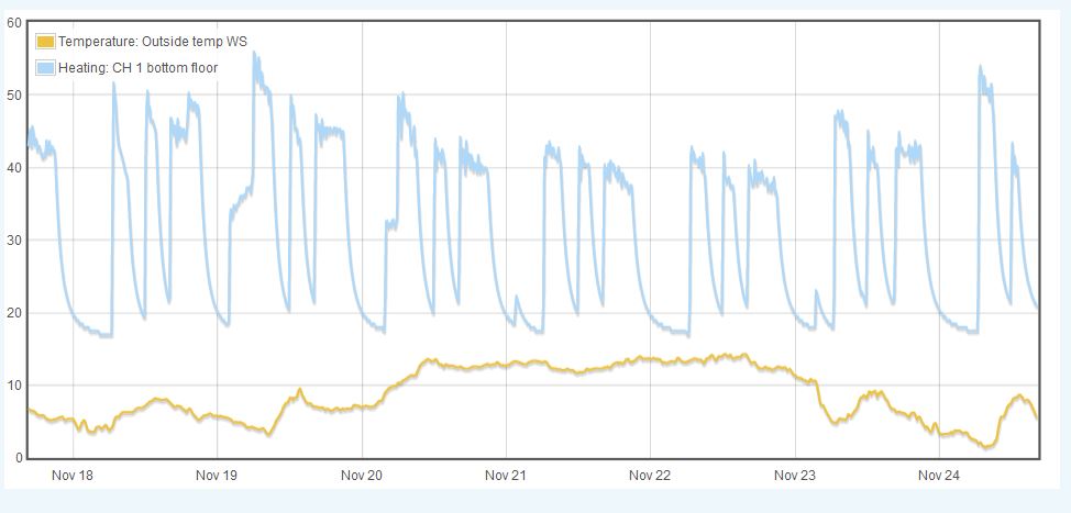

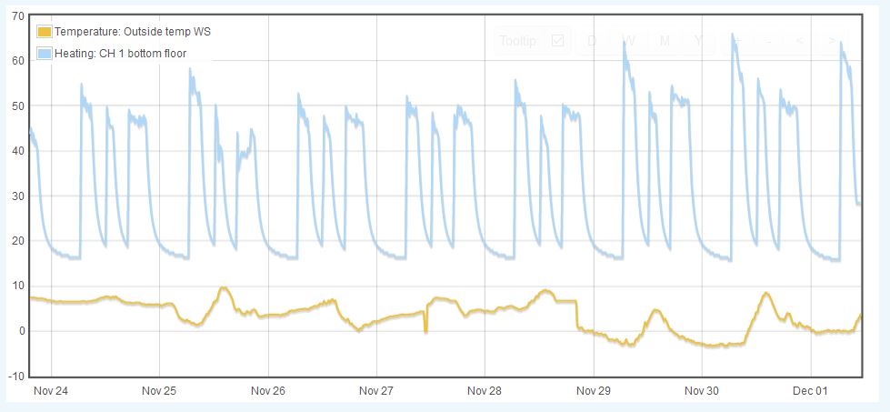

billt Posted November 24, 2017 Posted November 24, 2017 Just to demonstrate that it does work here are graphs showing outside and water temperatures for the last week, a week in June and the coldest week last winter. 1
SteamyTea Posted November 24, 2017 Posted November 24, 2017 The CH1 bottom floor temperatures seem to swing quite a bit. Can you plot floor temp against external temp to see the correlation better.
billt Posted November 26, 2017 Posted November 26, 2017 The yellow line is the outside temperature. Compare the top of the blue line to the yellow line and you should see in inverse relationship. It isn't perfect, partly as there's an internal temperature sensor which modifies the offset. The large swings are due to the heating being timed (like most domestic systems). High flow temperatures are when normal room temperatures are being demanded, low flow temperatures are during set back periods. As the house has a long thermal time constant the internal temperature doesn't usually drop to the set back temperature so the flow temperature will drop towards (internal) ambient.
SteamyTea Posted November 26, 2017 Posted November 26, 2017 So is your air temperature set to around 18°C. On November 29th, 30th and December 1st the flow temperature went up to over 60°C. That implies quite a high temperature difference between the slab and the air temperature, do you know how hot the floor is actually getting, seems to be around 35°C (from an eyesight average). If that is about right, and you are happy with the temperature stability, then you can safely run the ASHP up to 40°C and get a good CoP. Have you got any raw data rather than charts?
billt Posted November 27, 2017 Posted November 27, 2017 I fail to see how you can deduce anything about the air temperature from those graphs. The system uses radiators, not UFH and a lpg boiler, not an ASHP. The OP has a radiator system at the moment and it has been suggested that his best option is to keep the system as is and use a condensing boiler. I was merely suggesting that using a weather compensating controller will keep the boiler in condensing mode for as long as possible and maximise the efficiency of the system. The following discussion was about the operation of weather compensating controllers. Yes, I've got lots more data but it's not going to be any use to anyone else.
SteamyTea Posted November 27, 2017 Posted November 27, 2017 It is amazing what can be deduced from data, why we have statistics I had forgotten that it was radiators, but they are just convection devices anyway, so it is possible to compare systems. It is the air temperature that you are trying to keep stable, not the rest of the house, that is a bit of an irrelevance. I just don't see a decent correlation between the two datasets, though there may well be a weak one, but without looking at the data properly it is hard to tell.
