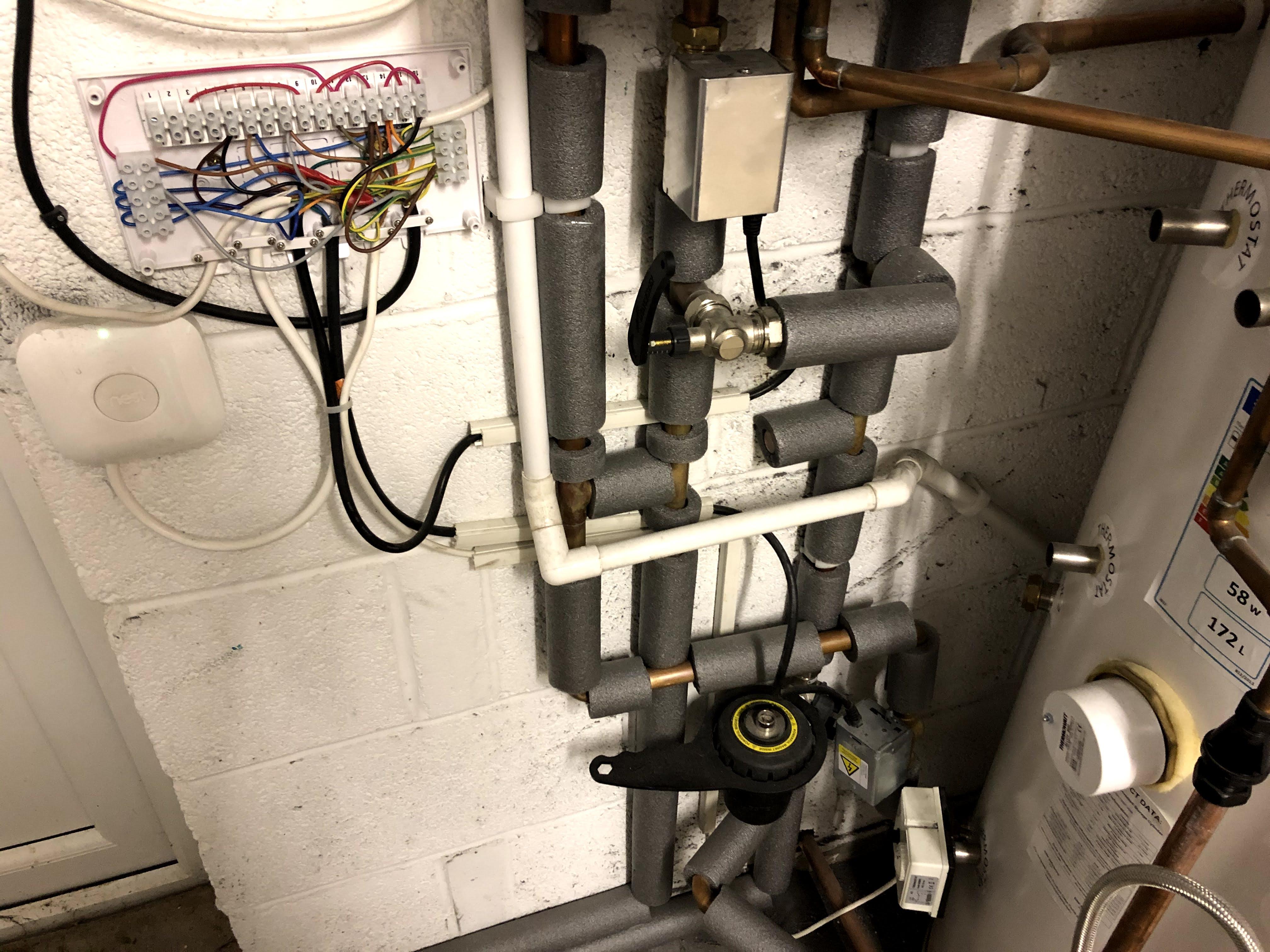

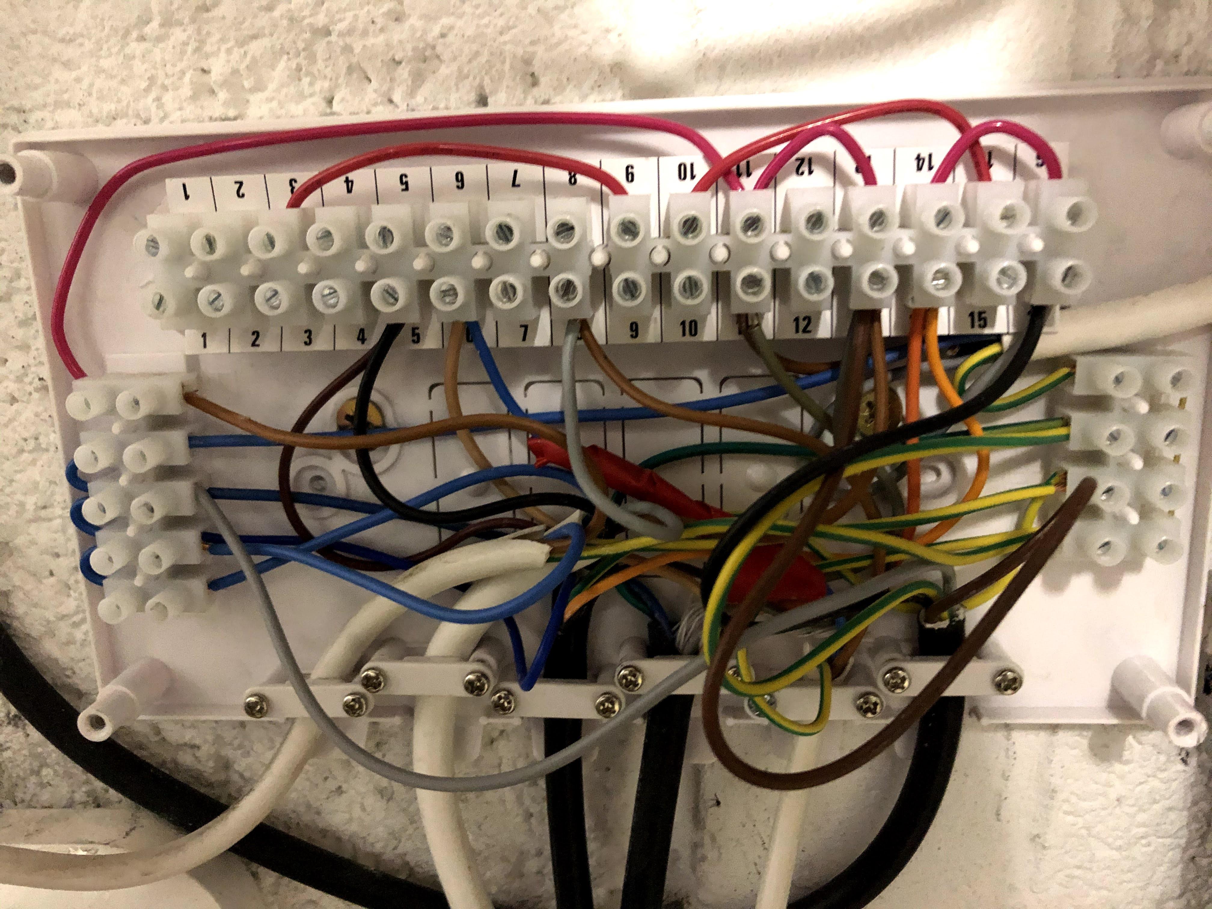

johny_99's Achievements

  2. I believe the nest is working as intended, as in it does turn the boiler on to heat the water at the set times. I believe the nest is supposed to act as the time switch you're referring to? Could it be that the cylinder thermostat doesn't know about the nests set on/off times in the morning/afternoon (wired wrong), and is constantly trying to heat the water if it's not up to temp? That would explain why the boiler turns on/off all day/night if the cylinder thermostat is turned up. We only have our boiler set to 60°c, perhaps that's not high enough to heat the cylinder being set above 40°c? Hi Peter Thanks for that. I had expected as much as the installer really didn't seem that competent. Don't suppose you or anyone here knows of a decent guy in the Staffordshire area?
  3. Hi Dave That's interesting. We have the nest controlling our upstairs heating (regular radiators) and our hot water cylinder. The nest is programmed to heat the cylinder for 30 mins twice a day. I had thought this was how it was meant to work as it was the same before the new boiler/tank was installed. I thought the cylinder thermostat was connected to the wiring centre to bypass the nest and turn the boiler off when the water was up to temp. So the cylinder thermostat is meant to keep the water at a constant temperature all day/night? That seems a bit wasteful for us and we would be happy just heating the water a couple times a day.
