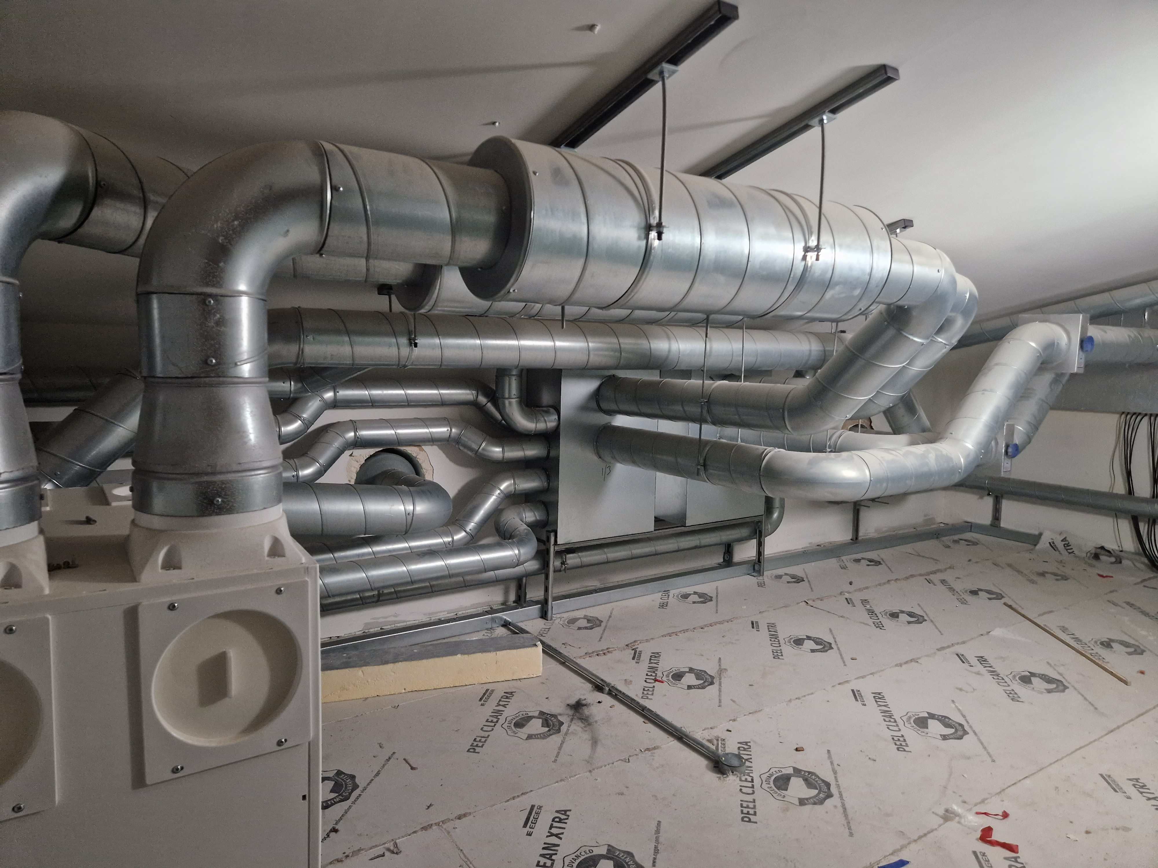

Another complication is that the unit is currently running at boost and I can't seem to turn it down to normal flow. It seems to be gurgling inside so I wonder if there's some trapped condensation in there tripping the humidity sensor.
What's your opinion on the plenums? I'm assuming they shouldn't be making a noise?

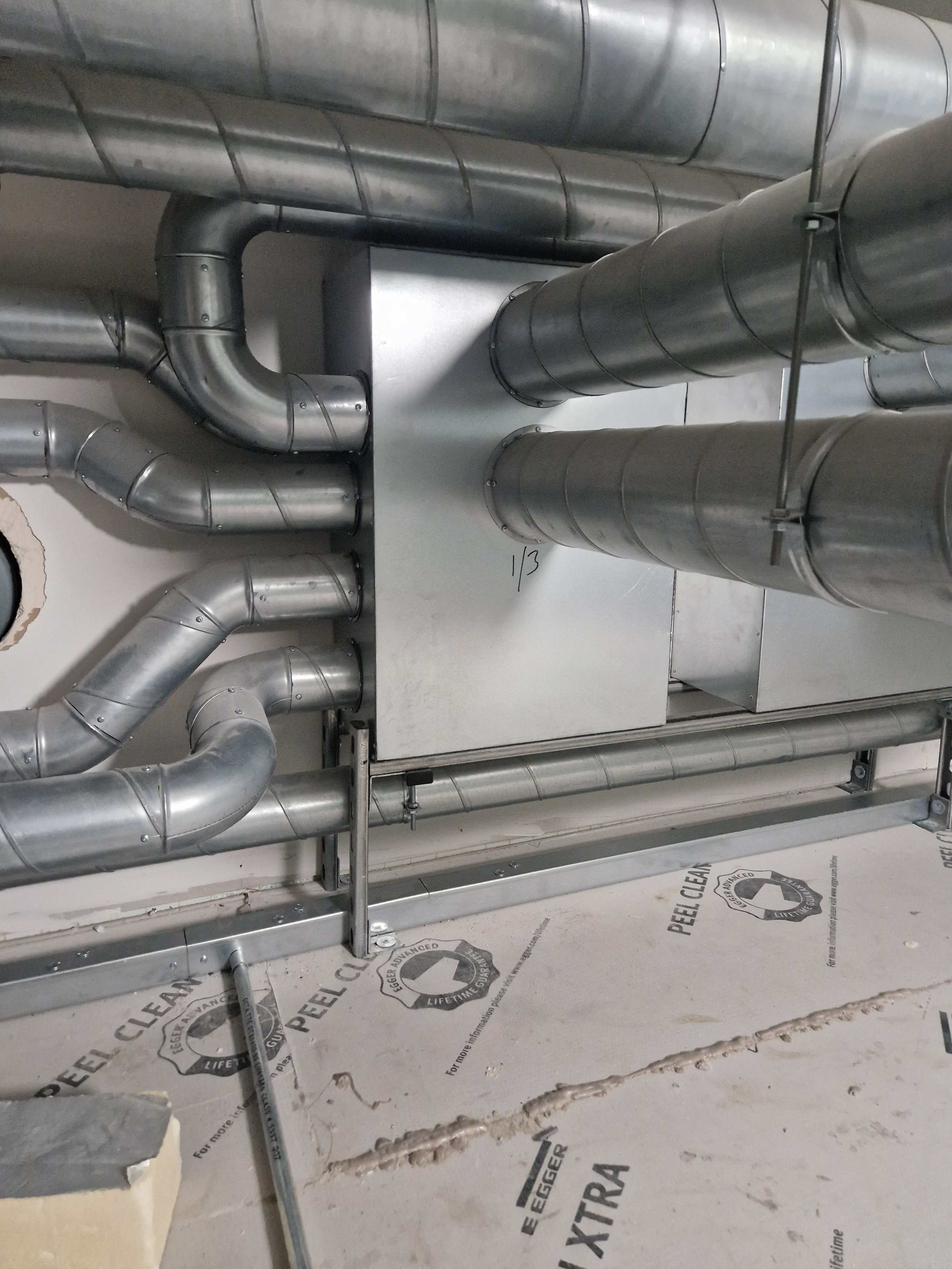

Wider angle...

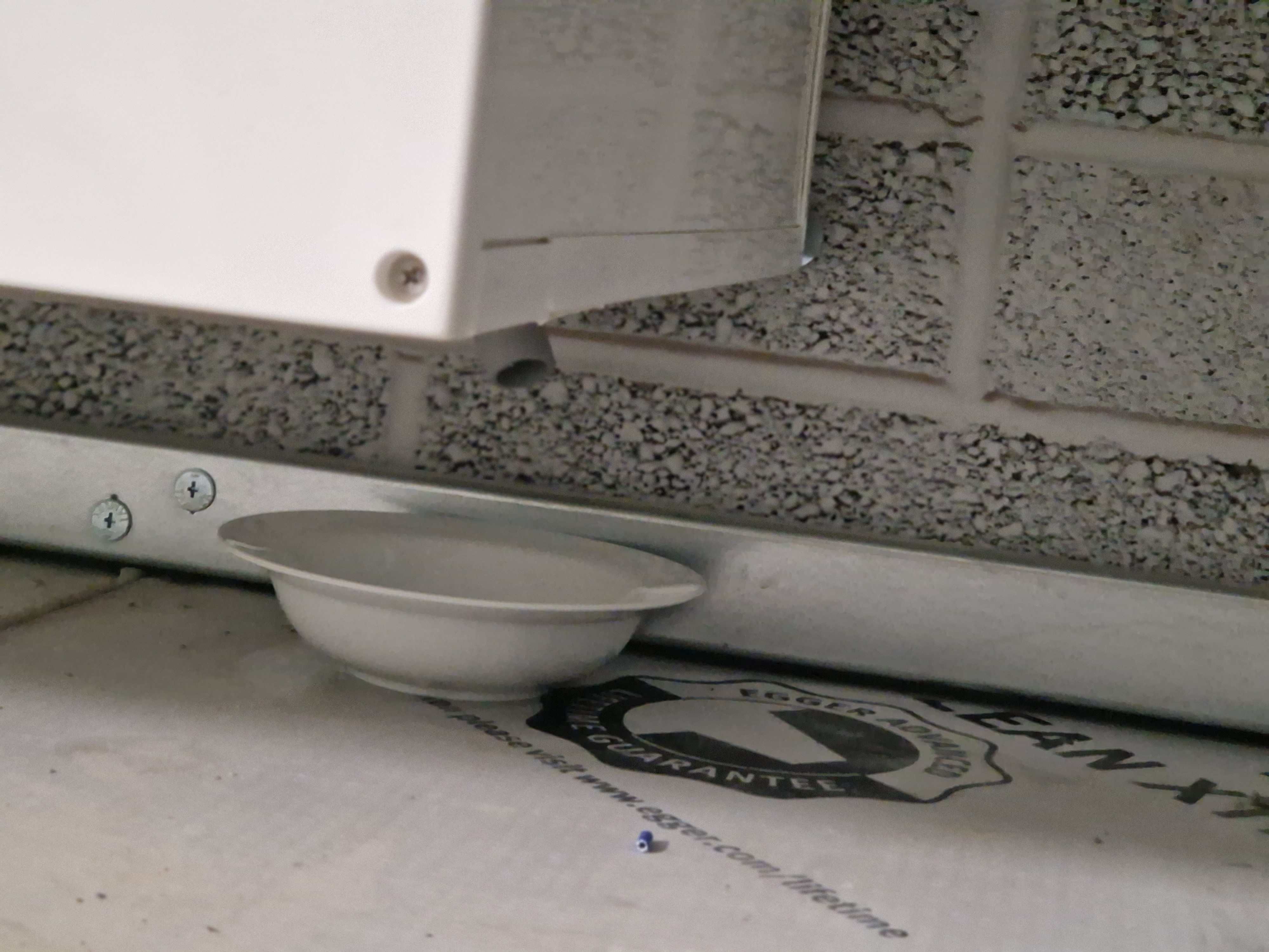

Right, I've investigated further. I've actually had it running with the condensate drain not attached to anything, just draining in to a bowl. There seems to be lots of air being sucked up the short length of corrugated pipe, and this seems to be causing the gurgling. If I put my finger over the end and then take it off, some water drains out. I did this a couple of times until no more came out and the gurgling stopped. It seems that the constant flow of air up the drain pipe was preventing water from draining effectively.
Is it normal for air to be sucked into the condensate pipe? I guess when I plumb the thing in, a ubend/trap would stop the air flow and the water would drain more freely?

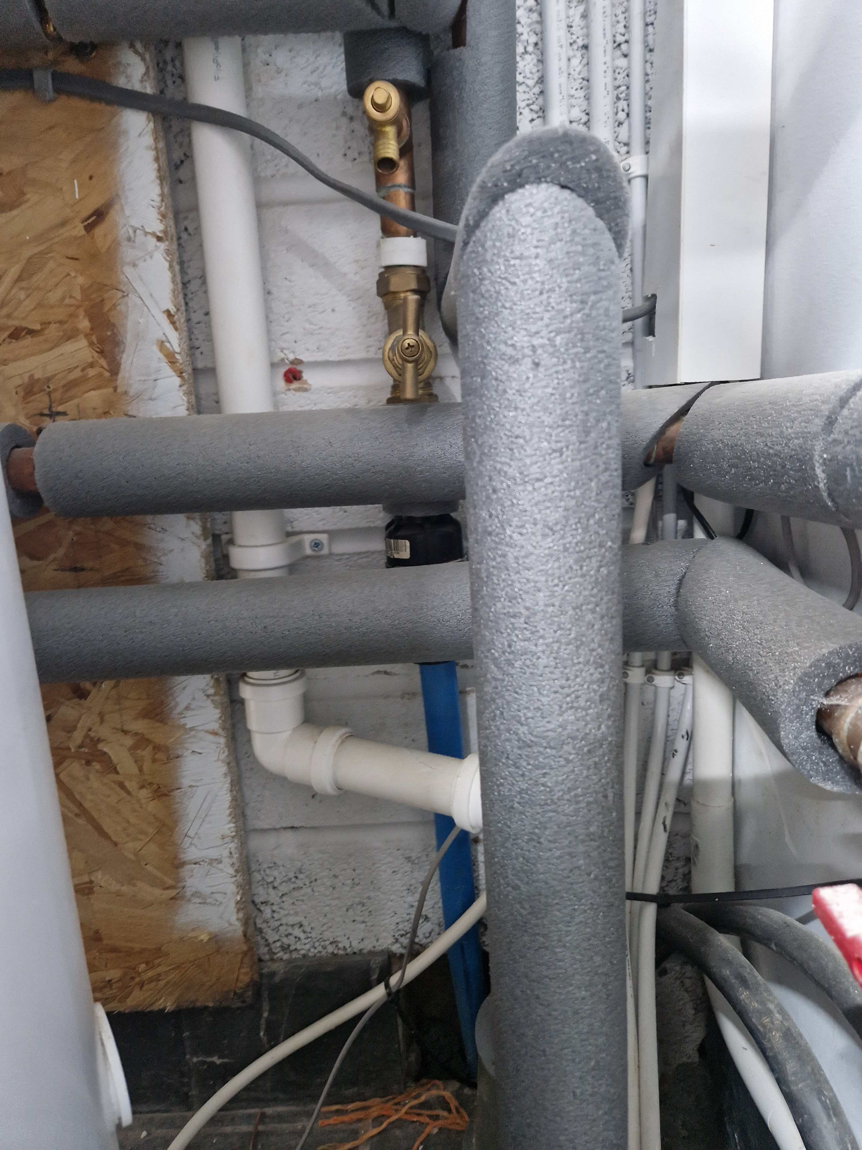

I need to plumb in the condensate properly I think. My plan is to attach a hose (essentially a washing machine hose) to the stub that comes out of the machine, run this along the floor, up and over some metal trunking and through a hole in the floor to the plant room below, then T into the pipe that takes the tundish from the UVC.
Does that sound reasonable?
Running the pipe up and over the trunking would effectively make a u-bend.
Stub pipe as it is now, gurgling and draining in to a bowl
T into this 32mm pipe, tundish just above

My idea above, with the hose running along the floor then up and over some metal trunking would effectively make a trap - and this is unavoidable as the metal trunking is between the unit and the hole the hose needs to go through. I could add a trap nearer the 32mm pipe I want to T in to, but there might be an issue with having two "traps" in series?

My idea above, with the hose running along the floor then up and over some metal trunking would effectively make a trap - and this unavoidable as the metal trunking is between the unit and the hole the hose needs to go through. I could add a trap nearer the 32mm pipe I want to T in to, but there might be an issue with having to "traps" in series?
You need a proper dry trap, like Hep2O ones, close to the unit. The pipe needs to fall away to a drain point, you can take it up and over. A hose on the floor, is a bodge, water will collect become stagnant and you are potentially breathing stuff in you shouldn't.
The unit is only ~100mm off the floor and I have a ~50mm high piece of trunking for the hose/pipe to go over before it can drop down in to the plant room, so not much wriggle room.

Not sure. Can you run a drain pipe upwards? Seems odd to me.
You will need to drill through the floor to find a way. You really don’t want stagnant water anywhere near this system.
