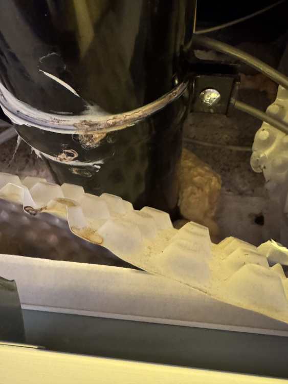

Pocster Posted 21 hours ago Author Share Posted 21 hours ago Filled up the sink . Let it all go in one ; so pump is busy . Ran round , up ladder - watched . Saw 1 drip - couldn’t see exactly where it came from . As this has been fine for 2 yrs I think it is the pump causing the pipe to vibrate / thud and hence weakening any seal . Could ( once I’ve smeared more tiger seal round the joint ) maybe clamp the white waste pipe to something to restrict any ‘bump’ movement Link to comment Share on other sites More sharing options...
joe90 Posted 19 hours ago Share Posted 19 hours ago Reducing vibration is a good idea anyway but the seal is obviously broken and IMO will only get worse. Preventative work (replace it) will give you peace of mind for the future and you can crack on with the millions of other jobs on your to do list. 😇 1 Link to comment Share on other sites More sharing options...

crispy_wafer Posted 18 hours ago Share Posted 18 hours ago I know you've got your fancy ceiling and you can get access to that joint whenever, but, surely that bit of waste and soil pipe will nag away at you until it's right? The only issue I forsee in fixing that is chamfering the 4" pipe all round if you wanted to use push connectors instead of solweld on the 4" pipe, unless you have one of those chamfering gadgets of course. 1 Link to comment Share on other sites More sharing options...

joe90 Posted 18 hours ago Share Posted 18 hours ago 14 minutes ago, crispy_wafer said: The only issue I forsee in fixing that is chamfering the 4" pipe all round if you wanted to use push connectors instead of solweld on the 4" pipe, No reason to remove the 4” pipe at all, that stays in place, it’s the strap on (no pocster, not that sort!!!!) boss that needs to be removed and replaced along with a short section of the 32mm pipe. 1 Link to comment Share on other sites More sharing options...
Onoff Posted 18 hours ago Share Posted 18 hours ago Solvent weld. You could use this as it's thicker than the normal "brush in the tin" type stuff. As in if the strap on doesn't quite fit tight around the pipe. https://www.amazon.co.uk/Polypipe-GFC100-FILLING-CEMENT-NATURAL/dp/B009NEC3IQ/ref=asc_df_B009NEC3IQ? 1 1 Link to comment Share on other sites More sharing options...
joe90 Posted 18 hours ago Share Posted 18 hours ago (edited) 2 minutes ago, Onoff said: Solvent weld. You could use this as it's thicker than the normal "brush in the tin" type stuff. As in if the strap on doesn't quite fit tight around the pipe. https://www.amazon.co.uk/Polypipe-GFC100-FILLING-CEMENT-NATURAL/dp/B009NEC3IQ/ref=asc_df_B009NEC3IQ? That sounds good, definite contender. Take note @Pocster Edited 18 hours ago by joe90 1 Link to comment Share on other sites More sharing options...
crispy_wafer Posted 18 hours ago Share Posted 18 hours ago 26 minutes ago, joe90 said: No reason to remove the 4” pipe at all, that stays in place, it’s the strap on (no pocster, not that sort!!!!) boss that needs to be removed and replaced along with a short section of the 32mm pipe. aah, i was under the impression that the boss was welded, which failed then covered with gunk to fix. Ok my mistake, cool. Link to comment Share on other sites More sharing options...
Pocster Posted 18 hours ago Author Share Posted 18 hours ago (edited) 5 minutes ago, crispy_wafer said: aah, i was under the impression that the boss was welded, which failed then covered with gunk to fix. Ok my mistake, cool. Hang on ! It was welded ( I think ) - then gunked . I might be wrong was some years ago … 🙄 If welded and gunked will it come off nicely ??? 🤔 Edited 18 hours ago by Pocster Link to comment Share on other sites More sharing options...

Pocster Posted 18 hours ago Author Share Posted 18 hours ago 16 minutes ago, Onoff said: Solvent weld. You could use this as it's thicker than the normal "brush in the tin" type stuff. As in if the strap on doesn't quite fit tight around the pipe. https://www.amazon.co.uk/Polypipe-GFC100-FILLING-CEMENT-NATURAL/dp/B009NEC3IQ/ref=asc_df_B009NEC3IQ? Does this dry in 7 seconds like normal solvent glue ? Link to comment Share on other sites More sharing options...
Thorfun Posted 17 hours ago Share Posted 17 hours ago 26 minutes ago, Pocster said: Hang on ! It was welded ( I think ) - then gunked . I might be wrong was some years ago … 🙄 If welded and gunked will it come off nicely ??? 🤔 I've been avoiding this thread up to now as I'm not sure I ever want to comment on @Pocster's strap-on but oh well..... I would've thought that if it the strap-on boss was welded previously then it won't come off, right? 1 Link to comment Share on other sites More sharing options...
Pocster Posted 17 hours ago Author Share Posted 17 hours ago 4 minutes ago, Thorfun said: I've been avoiding this thread up to now as I'm not sure I ever want to comment on @Pocster's strap-on but oh well..... I would've thought that if it the strap-on boss was welded previously then it won't come off, right? This is what I’m wondering . I can’t remember if welded and then tiger seal when it leaked OR just tiger seal ( so would come off ) Link to comment Share on other sites More sharing options...
Thorfun Posted 17 hours ago Share Posted 17 hours ago 2 minutes ago, Pocster said: This is what I’m wondering . I can’t remember if welded and then tiger seal when it leaked OR just tiger seal ( so would come off ) I'm pretty sure that you were the one who told me to grow a pair and solvent weld everything when I was going to use push fit as well 🤣. 1 Link to comment Share on other sites More sharing options...
Pocster Posted 17 hours ago Author Share Posted 17 hours ago 1 minute ago, Thorfun said: I'm pretty sure that you were the one who told me to grow a pair and solvent weld everything when I was going to use push fit as well 🤣. I probably used tiger seal because it gives me more than 7 seconds of play . I had problems before on other pipework where it was impossible to solvent weld conventionally - just can’t get it all in and lined up in those 7 seconds . Link to comment Share on other sites More sharing options...
Pocster Posted 17 hours ago Author Share Posted 17 hours ago 11 minutes ago, Thorfun said: I'm pretty sure that you were the one who told me to grow a pair and solvent weld everything when I was going to use push fit as well 🤣. Google suggests a multi tool and cut it out - then sand /file around the hole ( guess it would now have a good key ) . Often the cement as @Onoff mentioned gets used . Think that gives a better seal rather than runny thin glue . As the 2nd wrongly placed boss looks definitely like it’s been tiger sealed ; I’ll assume this one also . Link to comment Share on other sites More sharing options...
Thorfun Posted 16 hours ago Share Posted 16 hours ago 15 minutes ago, Pocster said: Google suggests a multi tool and cut it out - then sand /file around the hole ( guess it would now have a good key ) . Often the cement as @Onoff mentioned gets used . Think that gives a better seal rather than runny thin glue . As the 2nd wrongly placed boss looks definitely like it’s been tiger sealed ; I’ll assume this one also . good luck! 1 Link to comment Share on other sites More sharing options...
