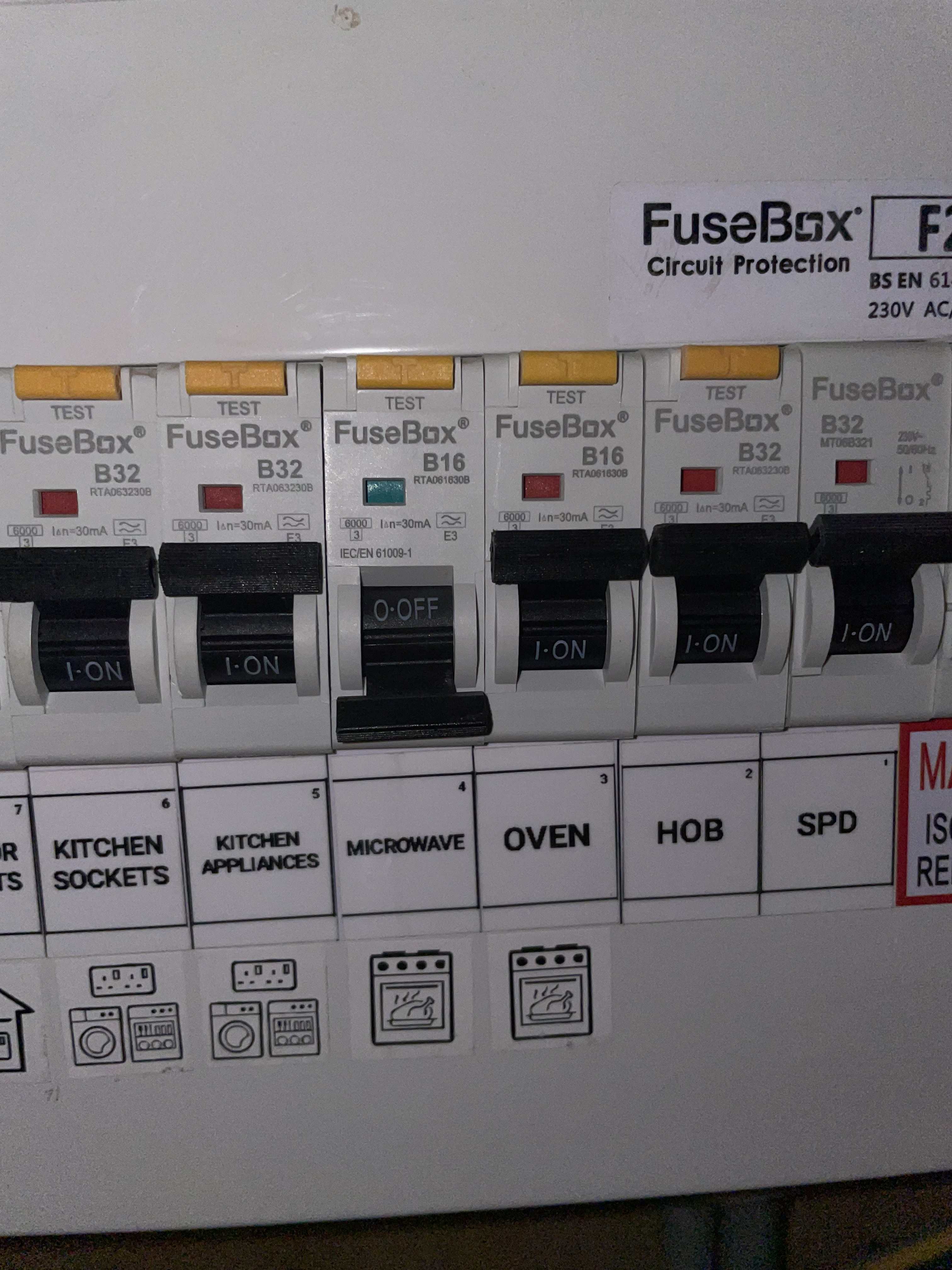

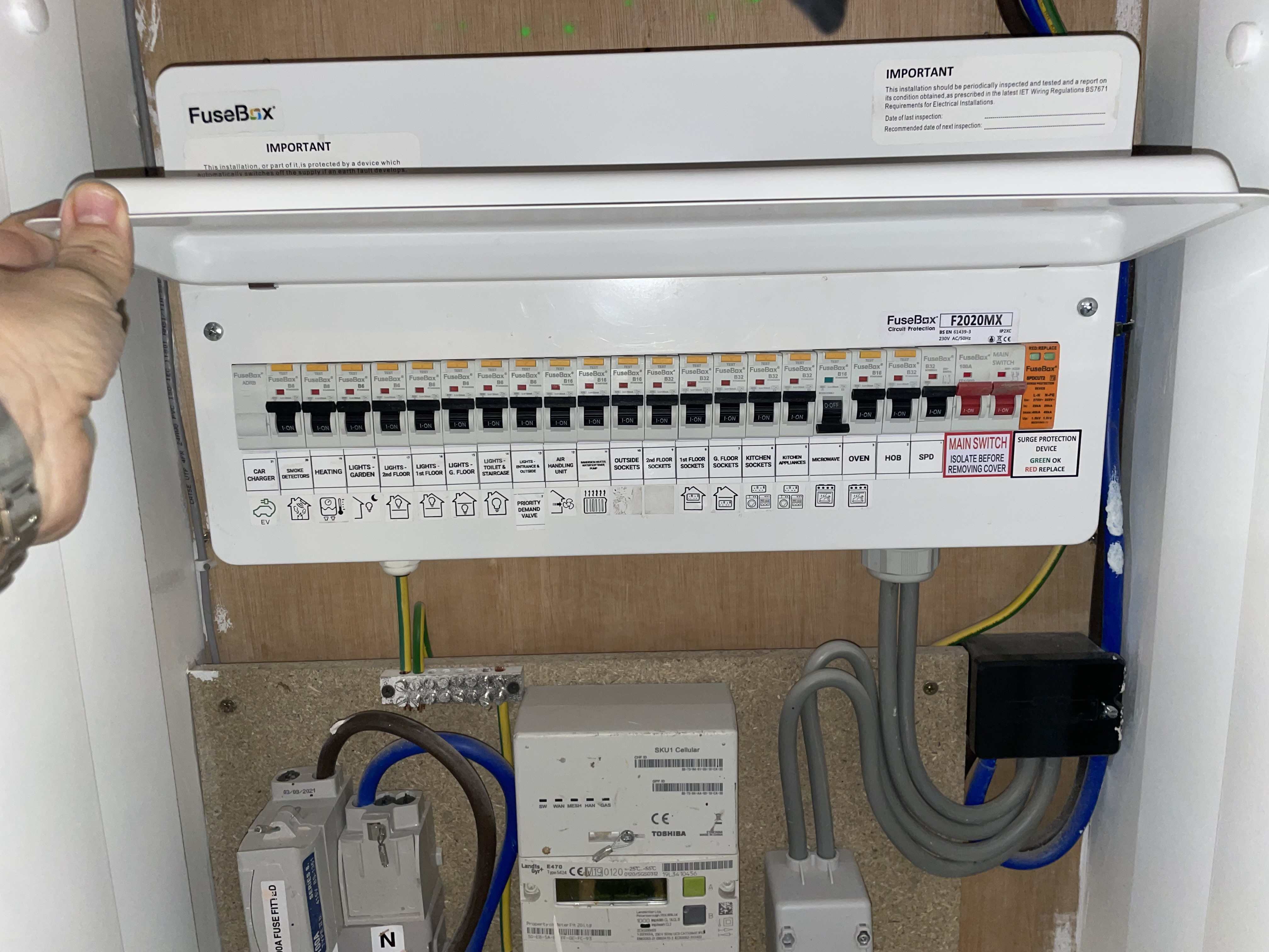

Adsibob Posted December 15, 2024 Posted December 15, 2024 We have a Zanussi ZVENM7K1 combination microwave/grill/oven. It was installed 3 years ago and we’ve been using it as a microwave oven for the last 2.5 years since we moved in. The max rating for the microwave is 1000W, and we have often used it at that setting. Last night we used it in oven mode, perhaps for the first time ever (I’m not sure) and it tripped the fuse. Trying to turn it back on we get a fault FH24 and then FO17 before it trips the fuse again. Given the oven is rated at 3kw, if it is actually the case that we’ve never used it as an oven, is it possible the electrician who installed it only provided a fuse for a 1kw Microwave. I notice that both the nearby isolator switch and the fuse on the mains consumer unit are labelled “microwave” so maybe he thought it was just a microwave and not an oven as well. If it is an installation error, is it straightforward to upgrade the fuses in the CU and in the isolator switch, or is the limiting factor going to be the type of cable used between the CU and the oven (which I estimate is about 12m to 15m long)?

Adsibob Posted December 15, 2024 Author Posted December 15, 2024 2 hours ago, SteamyTea said: I would have thought a technician would be good enough. A MCB is a modern fuse, a RCD is a safety device to stop electucution. Sometimes they are combined. Take a picture and post it up, someone is bound to know. Here are two photos, one showing the whole CU and the other a close up. I’m concerned given the labelling that the sparky has wired it for a microwave and not for a combination oven:

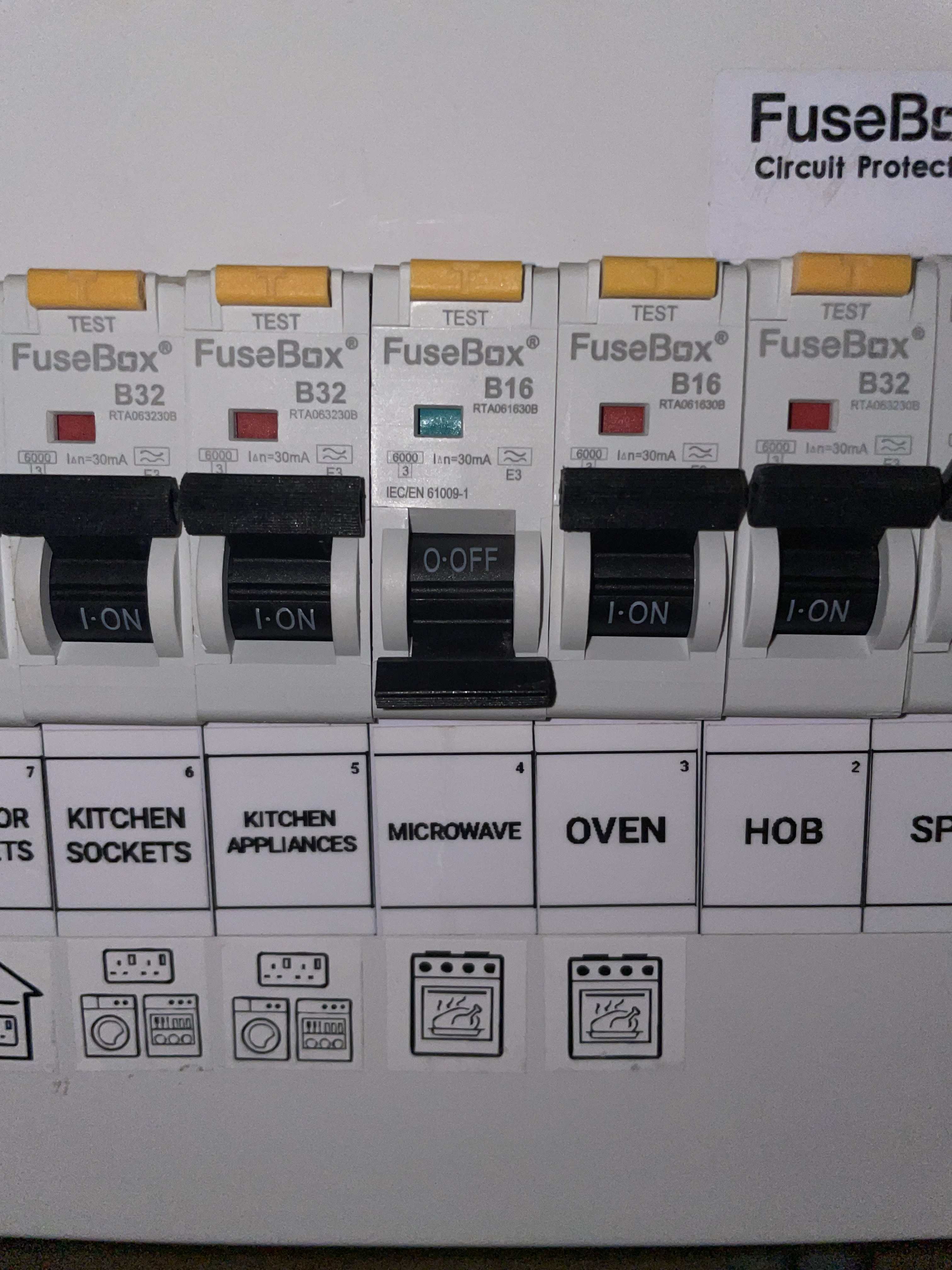

Adsibob Posted December 15, 2024 Author Posted December 15, 2024 This close up is in sharper focus k in case any of those font size 8 characters mean anything:
ProDave Posted December 15, 2024 Posted December 15, 2024 That's an rcbo so there is no way to find out if it is tripping due to over current or earth leakage. It's 16A it would have to be a very big oven for that not to be enough,
Adsibob Posted December 15, 2024 Author Posted December 15, 2024 10 minutes ago, ProDave said: It's 16A it would have to be a very big oven for that not to be enough, Thanks @ProDave so is that sufficient to serve an oven that has a “total electricity loading” of 3000W?
ProDave Posted December 15, 2024 Posted December 15, 2024 14 minutes ago, Adsibob said: Thanks @ProDave so is that sufficient to serve an oven that has a “total electricity loading” of 3000W? Yes the fault is with the oven. Persevere searching for the meaning of those fault codes. Is it still under any form of guarantee?
