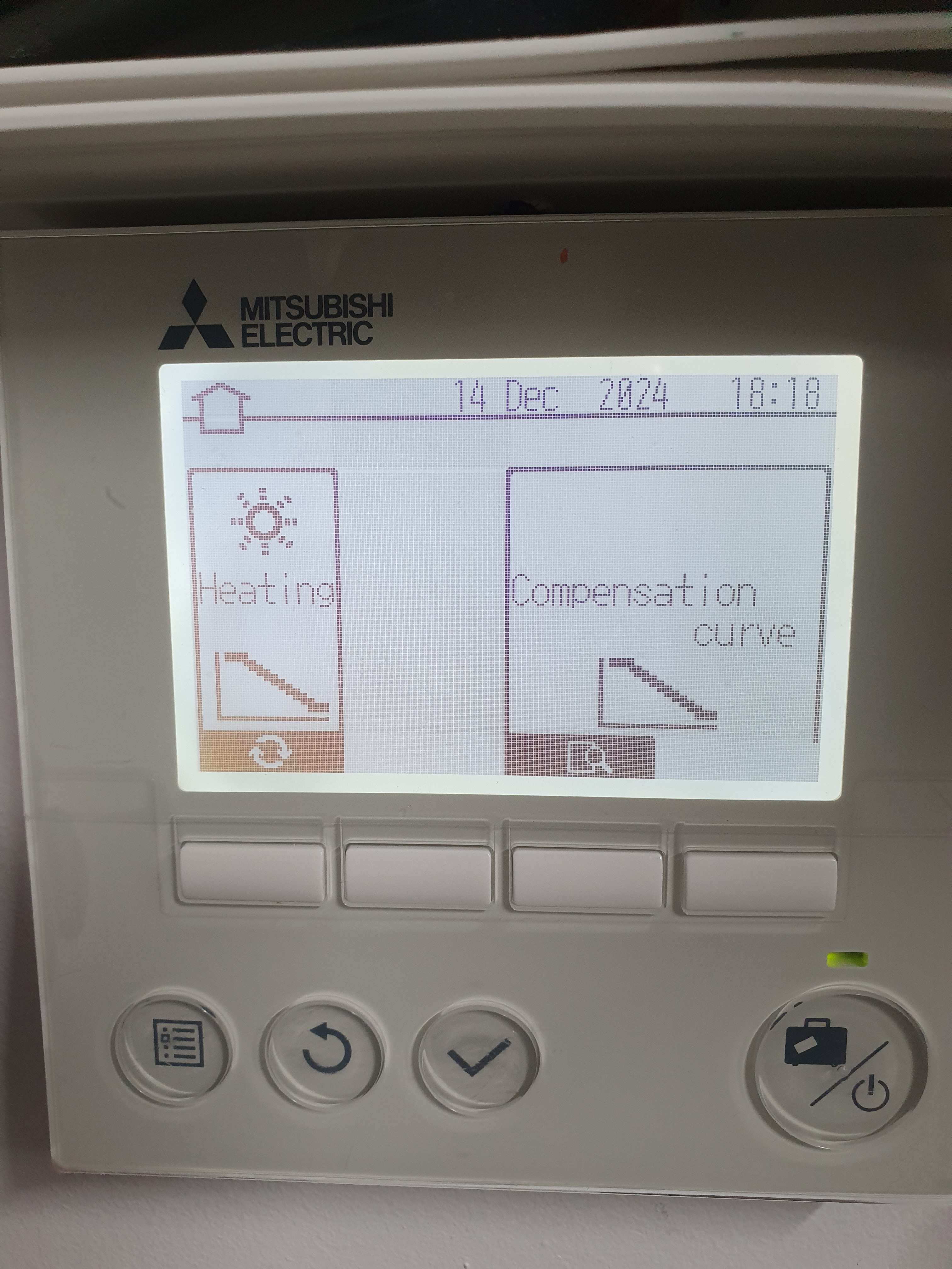

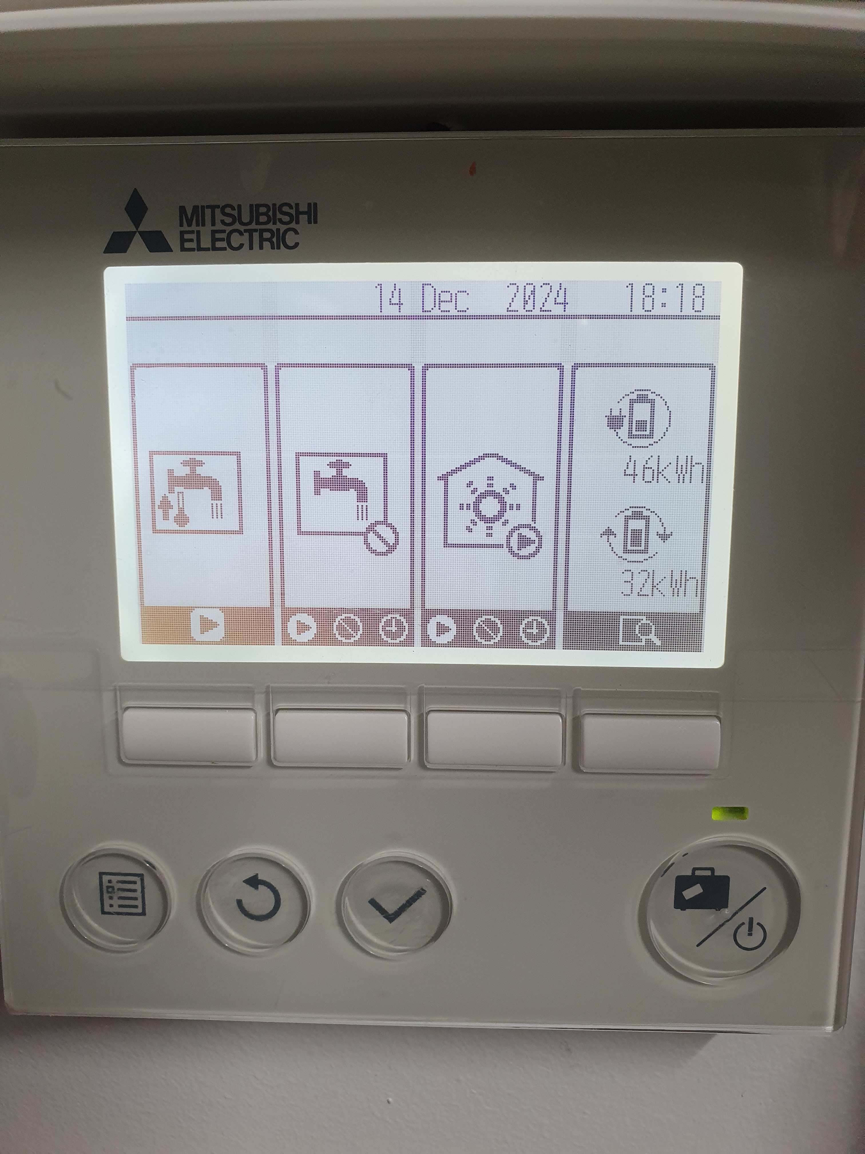

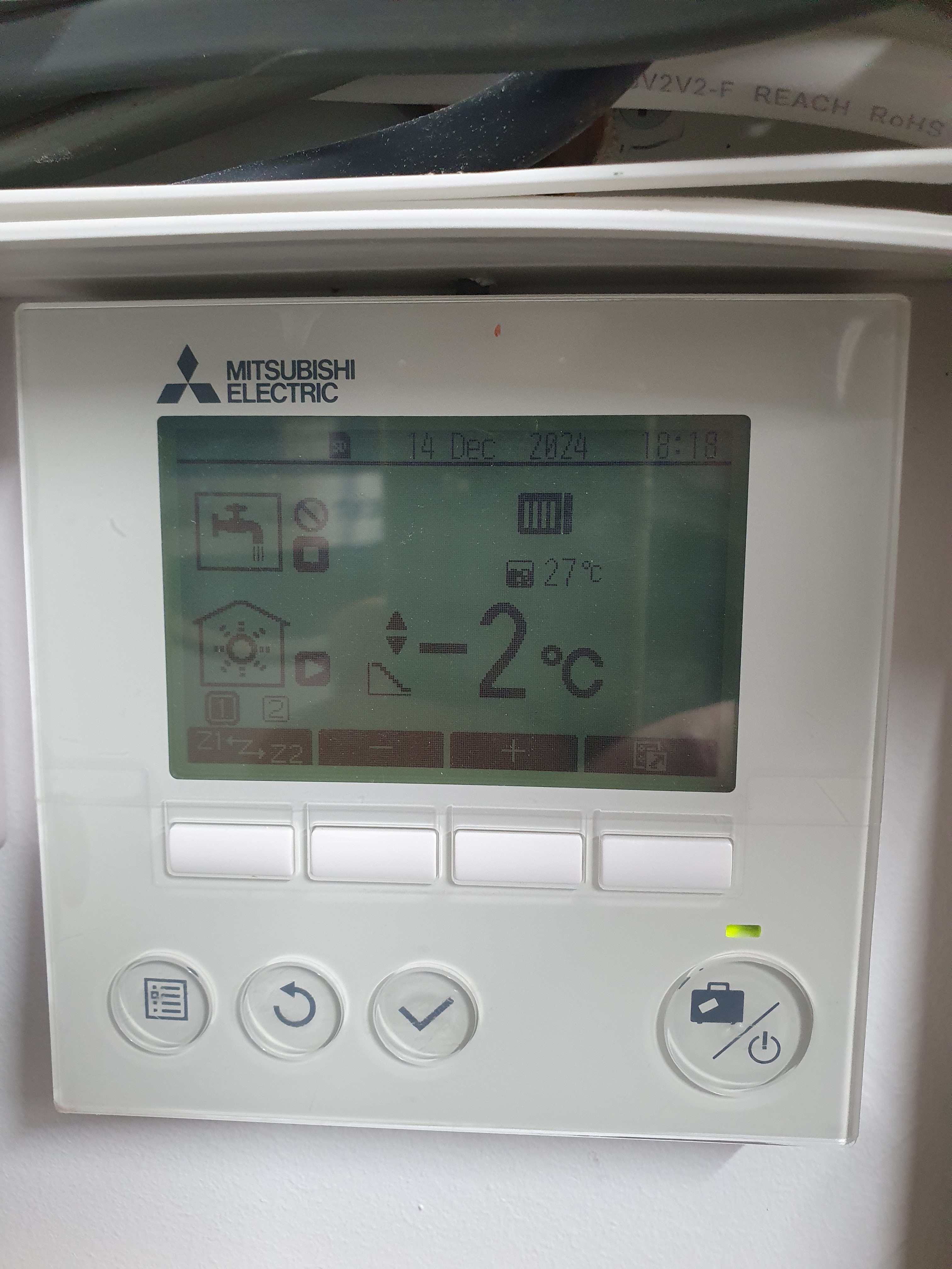

Tom Posted December 14, 2024 Share Posted December 14, 2024 Hi all, believe it or not we might actually be moving in tomorrow, so today I fired up the ecodan but struggling to get much heat out of it. For a start, the Wunda thermostats seem to randomly stop calling for heat and reset themselves to 10c, but I'm also struggling with the ecodan controller. It all seems.to switch on fine and the ASHP runs but the flow water temp to the manifolds hovers at around 15°. I've taken some pictures of the controller, any ideas? Link to comment Share on other sites More sharing options...

JohnMo Posted December 14, 2024 Share Posted December 14, 2024 Disconnect all the third party thermostats, you just don't need them. Tell.us more about the system, buffer no buffer, as much info as possible. Has the system been commissioned? Link to comment Share on other sites More sharing options...
Tom Posted December 14, 2024 Author Share Posted December 14, 2024 29 minutes ago, JohnMo said: Disconnect all the third party thermostats, you just don't need them. Yep, I know, but as its currently set up I need at least one to call for heat. 30 minutes ago, JohnMo said: Tell.us more about the system, buffer no buffer, as much info as possible. No buffer. Two 12 port manifolds, one thermostatic mixer on each fully open. 8.5kW ASHP 300l uvc, low loss header. Though tbh, irrespective of what the plumbing is downstream of the ashp, it's just not producing very how water - the pipe coming from it is barely warm. 33 minutes ago, JohnMo said: Has the system been commissioned? Yep. Link to comment Share on other sites More sharing options...

ReedRichards Posted December 15, 2024 Share Posted December 15, 2024 12 hours ago, JohnMo said: Disconnect all the third party thermostats, you just don't need them. Well if the system was set-up to operate with third party thermostats you most probably DO need them. You might ultimately be able to disconnect them when you have found your way around the controls but it's too ambitious to do this in the first instance. My advice would be to disable use of weather compensation and set a fixed water temperature near the high end of what your heat pump is capable of. This is not the most economical way of operating your heat pump but it removes a level of complexity and potential for error and therefore should give you a better chance of telling if there is a fundamental problem or not. 1 Link to comment Share on other sites More sharing options...
trialuser Posted December 15, 2024 Share Posted December 15, 2024 I found this video helpful when setting up my ftc5. It looks as if you have got your offset turned down 2 degrees from what the curve is set to which also wont help. You could also try changing it from comp curve to say fixed flow of say 35 degrees just to test if that works. Sorry I don't know anything about external controls. 1 Link to comment Share on other sites More sharing options...

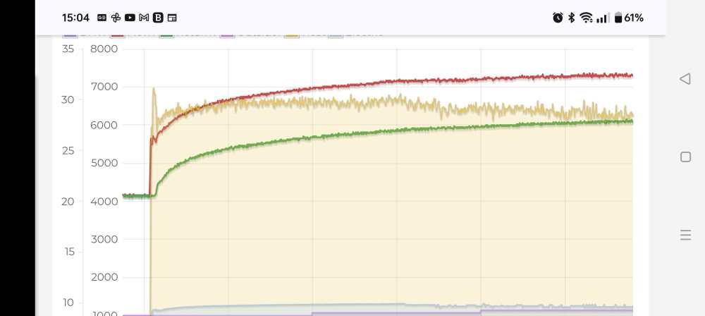

JohnMo Posted December 17, 2024 Share Posted December 17, 2024 So this is the first proper start/run. The way the heat works and it makes zero difference what the target temperature is initially. The heat pump starts, it monitors flow and return temperature. It tries to establish a steady return temp, and then sets flow temp to approximately the target dT (difference between flow and return temperature) above the return temp. It will not add more flow temperature until dT reduces. So if have many tonnes of house to get up temperature that has spent its whole life unheated it takes a while. This doesn't mean your settings are correct or even close, but the realities are houses when just built are very damp the water contents require loads of heat to start drying. 1 Link to comment Share on other sites More sharing options...

JohnMo Posted December 18, 2024 Share Posted December 18, 2024 7 minutes ago, ReedRichards said: But I don't have a big delta T, why should I? Not really comparing apples with apples. OP is starting system for first time on a new build. If I'm running WC, flow temp goes to target with a couple of mins. But not so when batch heating or doing a cold start of system. Takes a few hours to get there. 8 minutes ago, ReedRichards said: you'll have to explain the mechanism by which you could get such a large heat loss as to give you a big delta T. Cold house first time heating comes on (op case above), or first heating of the season with UFH. Even without cooling prior to heating season, floor is only around 19 to 20. In my case I have 100L plus of water, plus 56T of concrete to heat, so return temp stays low for a long time. Delta T is capped at the max allowed by flow rate and heating kW output. As return creeps up the dT stay constant and flow temp increases with return. Example from a batch charge from the other day, to show what I mean. Run started at 00:30 and was stopped to do DHW at 06:30. Window in image is 4 hrs. Link to comment Share on other sites More sharing options...
ReedRichards Posted December 18, 2024 Share Posted December 18, 2024 Okay, @JohnMo, you're specifically considering trying to heat up a cold floor with a huge thermal mass. But, I presume, enough thermal conductivity that all the floor remains at much the same temperature. Does concrete/screed have a high thermal conductivity? I've always assumed that it doesn't, like stone. But if it manages to extract a lot of heat from the pipes then I suppose it must. Sorry, I can't work out your picture as it has no labels. Link to comment Share on other sites More sharing options...
JohnMo Posted December 18, 2024 Share Posted December 18, 2024 (edited) 2 hours ago, ReedRichards said: Does concrete/screed have a high thermal conductivity? Yes - Normal concrete: Has a thermal conductivity of around 2.25 W m−1 K−1. The thermal conductivity of air is around 0.025 to 0.03 water is around 0.6 W/mK at 20°C 2 hours ago, ReedRichards said: Sorry, I can't work out your picture as it has no labels. Good point Red is flow temp, green is return temp, yellow is power Edited December 18, 2024 by JohnMo 1 Link to comment Share on other sites More sharing options...
