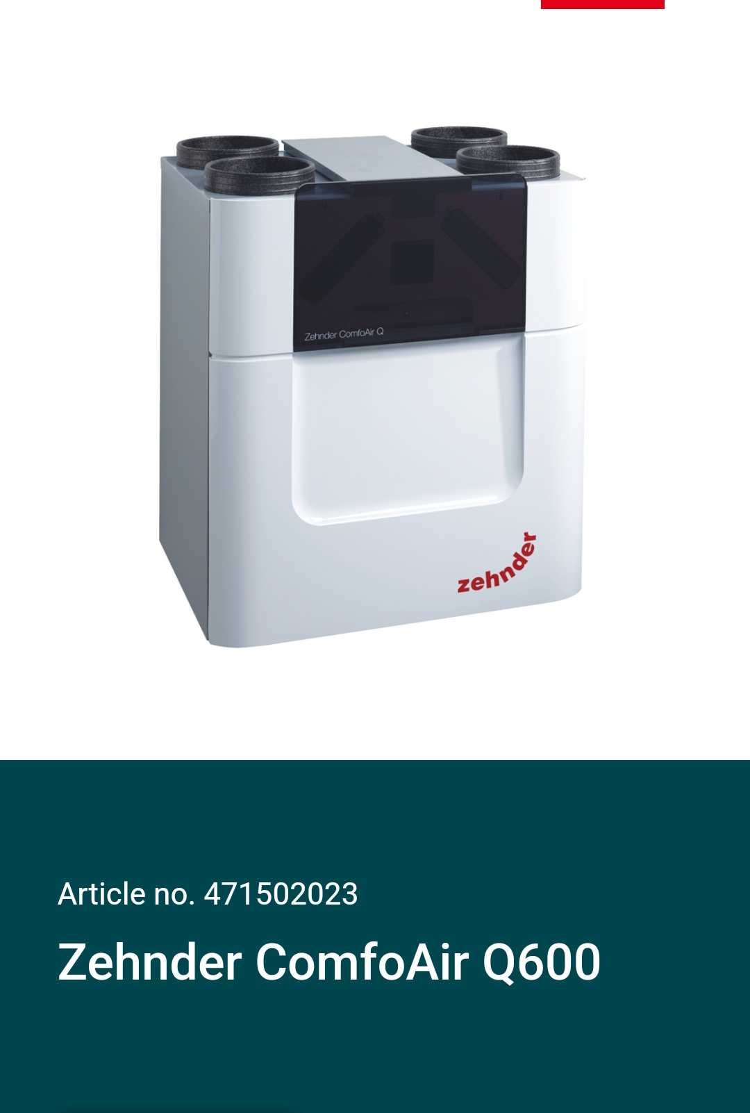

Nick Laslett Posted December 12, 2024 Share Posted December 12, 2024 2 hours ago, SBMS said: Currently looking at MVHR options for our build. Around 390m2 Over three floors (room in roof). I’ve not looked at this for a long time, so please take this comment with a degree of skepticism. The Zehnder ComfoAir Q600 is suitable for a house up to 350m2. Not sure how accurate your 390m2 measurement, but maybe 40m2 is not enough to really discount the Q600. My understanding from other posts on BuildHub, is that the Building Regs requirement for air supply is too high and after building controls signoff they dial back the MVHR settings. Link to comment Share on other sites More sharing options...

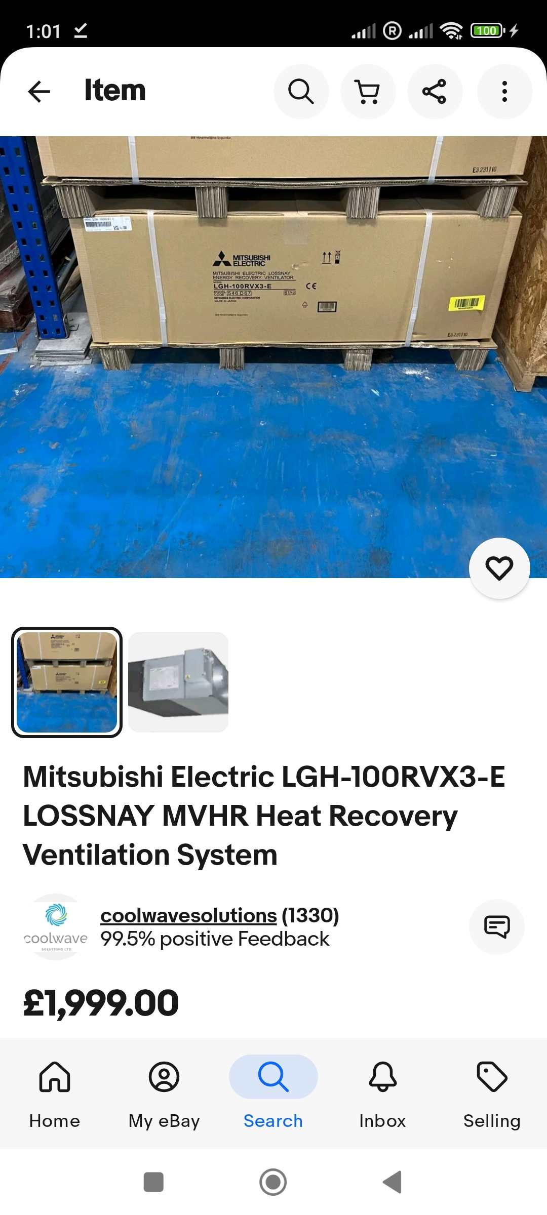

Iceverge Posted December 13, 2024 Share Posted December 13, 2024 Commercial units appear on eBay a lot cheaper. This one will do 1000m³/HR.. Beware through it does use 250mm ducting so will take up a big chunk of space. Link to comment Share on other sites More sharing options...
