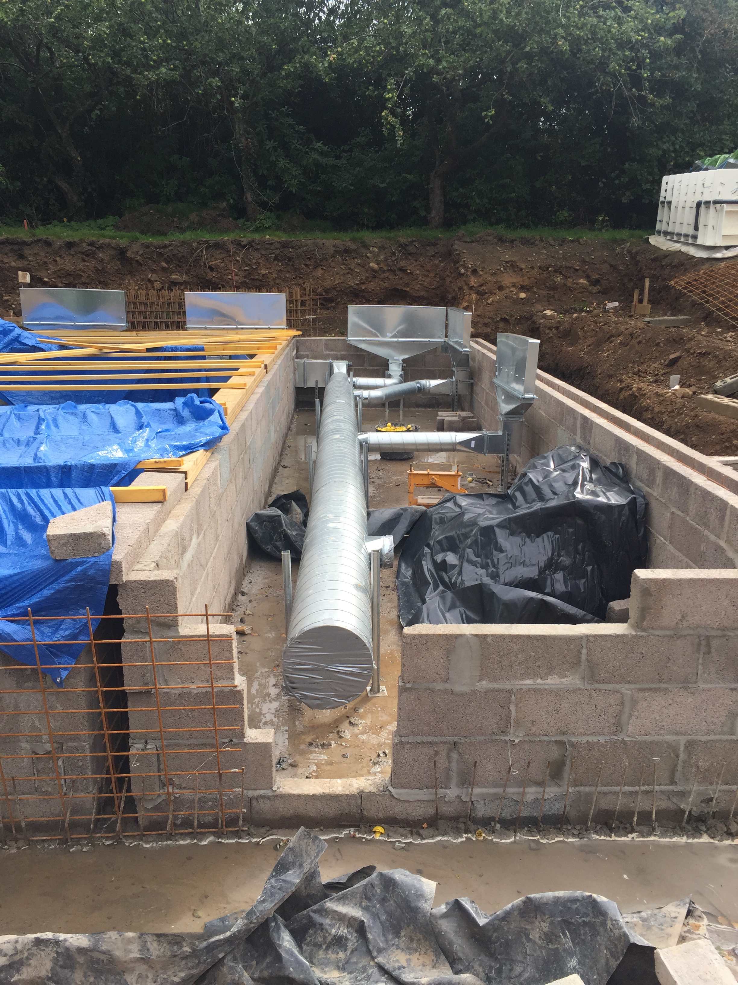

AliG Posted December 11, 2024 Posted December 11, 2024 Our pool is effectively in a small basement as described. The thing they are missing is it had to be tanked to stop water coming in and it has to be insulated. Otherwise you will lose heat to the ground. The pool costs the same to heat as a space that size would cost heated to 28C. It actually costs more to run the filter and dehumidifier. I have a Niveko pool which is made of polyurethane resin. It looks and feels a lot nicer than fibreglass but is a bit more expensive. Have they not mentioned air handling and dehumidifying in the costs. That was another 20k for mine. It heats the pool and extracts heat and moisture from the air. Also the filtration equipment looks quite minimal. I have a sand based filter, pump, centrifuge, uv disinfecting and automated pH regulation. There is literally nothing to do, the pool looks after itself. 1 1
SBMS Posted December 11, 2024 Author Posted December 11, 2024 (edited) On 11/12/2024 at 14:35, AliG said: Our pool is effectively in a small basement as described. The thing they are missing is it had to be tanked to stop water coming in and it has to be insulated. Otherwise you will lose heat to the ground. The pool costs the same to heat as a space that size would cost heated to 28C. It actually costs more to run the filter and dehumidifier. I have a Niveko pool which is made of polyurethane resin. It looks and feels a lot nicer than fibreglass but is a bit more expensive. Have they not mentioned air handling and dehumidifying in the costs. That was another 20k for mine. It heats the pool and extracts heat and moisture from the air. Also the filtration equipment looks quite minimal. I have a sand based filter, pump, centrifuge, uv disinfecting and automated pH regulation. There is literally nothing to do, the pool looks after itself. Expand Thanks - it’s all contained in the system itself as it’s effectively a swim spa. So filtration etc is done within the gubbins - like a massive hot tub. No separate pump room required. Heating is done via a supplied ASHP. Ventilation is not supplied and I need to look at a dehumidifier and vent system separately. Is that a single block wall basement that your pool was dropped into? how did you waterproof the basement area? Edited December 11, 2024 by SBMS
AliG Posted December 11, 2024 Posted December 11, 2024 I couldn’t find a better picture. The area you can see there with the pipework is underneath the pool room. I think it was just backfilled with gravel after the pipe work went in. The pool sits under where the blue tarpaulin sits. You can see the pool sitting up at the top right waiting to be lifted in. I think they used french drains around the outside and then they painted the walls with some kind of paint on tanking membrane. It wasn’t a big job at all. The pool itself had 50mm of EPS insulation all the way round. We laid another 100mm of insulation on the concrete base then sat the pool on top of that. I’d be asking if the pool needs any manual maintenance like checking pH levels which would be a pain. I have the guy come service ours every 8 or 9 months and really he just delivers extra chemicals that the system uses automatically. I just chuck a cleaning robot into the pool every few weeks. Our pool is a bit larger and our air handling may be overkill but 6 years in the pool room still looks like new. I went to a local pool to see how much space I needed to do lengths and we ended up just over 9m. I’d consider a very slightly longer pool and no swim spa which would make things a lot simpler. Our pool is I think 9.2x3.7x1.35. It should maybe have been 1.4 deep.
SteamyTea Posted December 11, 2024 Posted December 11, 2024 On 11/12/2024 at 15:10, AliG said: The pool itself had 50mm of EPS insulation all the way round. We laid another 100mm of insulation on the concrete base then sat the pool on top of that Expand There are evaporation losses as well. https://www.thermexcel.com/english/program/pool.htm
