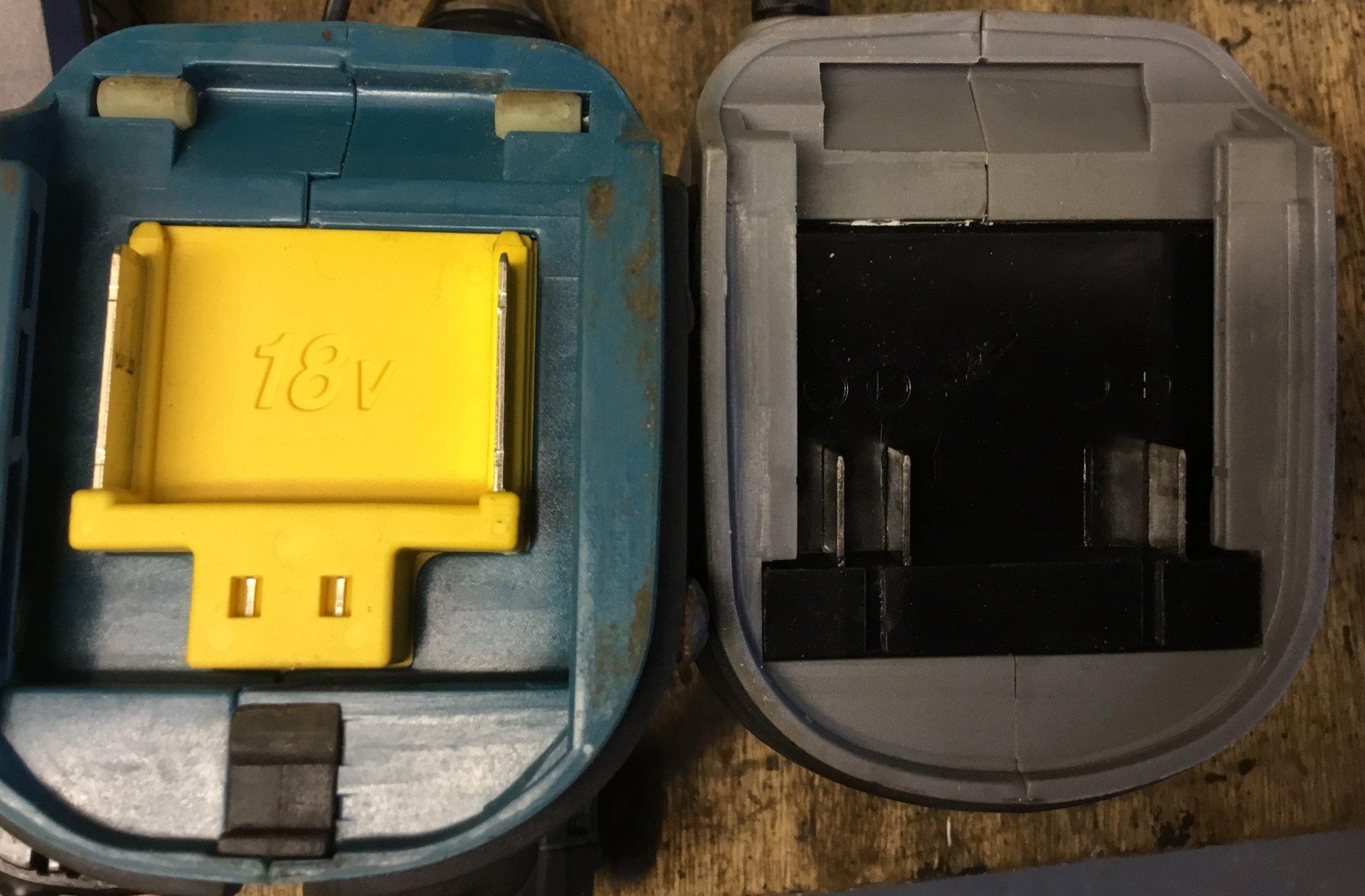

Onoff Posted April 2, 2019 Author Posted April 2, 2019 (edited) Figured carry on this thread: I have a number of perfectly serviceable 18V tools of various, dubious, here today gone tomorrow brands. All bought on a whim, dirt cheap or got as a present: Champion circular saw Rolson 4 1/2" grinder Performance Power hedge trimmer Jigsaw, can't remember make. These came with Nicads originally. There is some interchangeability between batteries though I think with the hedge trimmer the + & - are reversed. The grinder batteries fit but the wrong way round and with the aid of some tape. Some batteries fit and work but the holding clips are in the wrong place. Tbh I'd use them more if they had good batteries that lasted and the charge times weren't "3-5 hours" and you didn't need multiple chargers. (OK, the grinder is 1 hour). So here's the plan: I had considered 3D printing but found these Makita battery Stealth Mounts moulded from tough ABS at £15 for 4. Aim is to graft these onto the top of the various tool batteries, the section that slots in. Then a couple of down pointing tags to line up with the Makita batteries + & -: These are injection moulded rather than 3D printed btw. Watch this space but don't wait up! Edited April 2, 2019 by Onoff 1

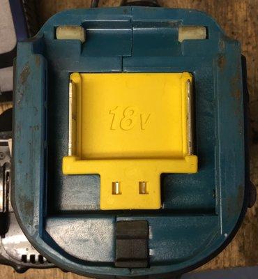

Onoff Posted April 2, 2019 Author Posted April 2, 2019 Stripping the grinder and it's battery down tonight: The battery lid: Inserted into the grinder: The stealth mount held against the battery lid: Tbh a rectangle of plastic (or timber?) a few mm thick screwed to the grinder base then the Stealth Mount on that should work. The grinder body plastic is really tough and would pass the "drop test" so would take a couple of self tappers: Hedge trimmer, the + & - reversed for a start: Lid moulding is quite complicated...So we'll ditch that: Stealth Mount balanced precariously: Again probably a rectangle of something to bring the base flush, deeper than for the grinder, then the Stealth Mount is the way forward I think: "Infill blocks" next then figure the battery connections. I think I'll open the tools up and hard wire the new battery connections direct to the switch etc to bypass the remnants of "tangs" that attach to the original battery.

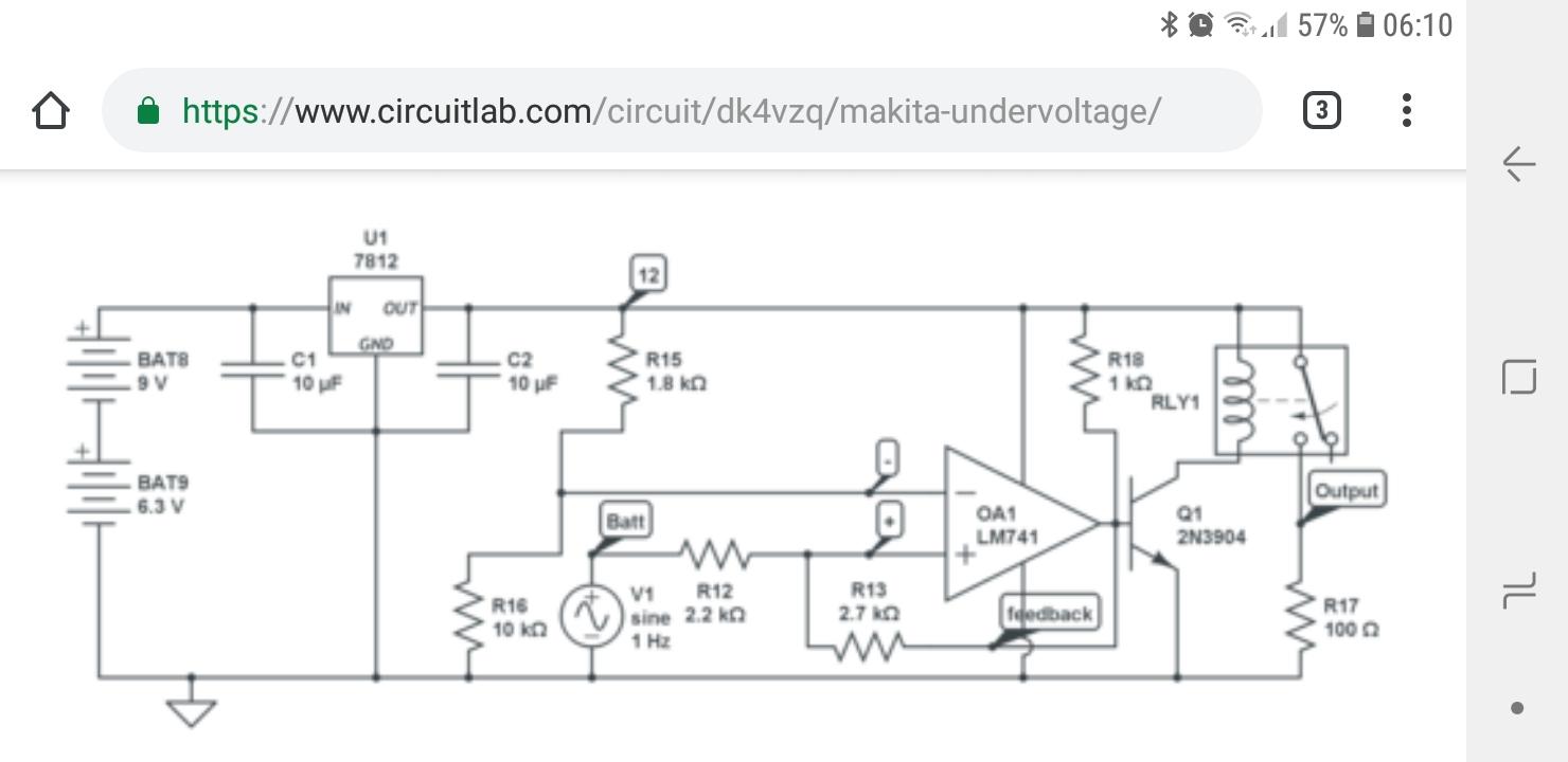

Onoff Posted April 3, 2019 Author Posted April 3, 2019 (edited) Came across this: http://bl1830-failureprevention.blogspot.com/2013/07/makita-radio-1-cause-of-battery-failure.html?m=1 His Advanced Solution #4 is for installing an undervoltage switch to protect from over discharge. Here's the circuit: https://www.circuitlab.com/circuit/dk4vzq/makita-undervoltage/ Can't say I understand the circuit...the cells on the left...are these the battery cells? Figuring this could easily be built into the space where the old battery slotted in? Edited April 4, 2019 by Onoff
Jeremy Harris Posted April 4, 2019 Posted April 4, 2019 One snag with that circuit is that the quiescent current of the 7812 and associated circuitry is high enough (~8 to 10mA) to discharge the pack when it's stored for any length of time, so you really need a way to disconnect the circuit from the battery pack. The existing monitoring circuit inside the pack only has a very small quiescent current (of the order of a few µA), yet that's enough to cause problems when packs are stored for any length of time without being charged first. 1
Onoff Posted April 4, 2019 Author Posted April 4, 2019 1 hour ago, JSHarris said: One snag with that circuit is that the quiescent current of the 7812 and associated circuitry is high enough (~8 to 10mA) to discharge the pack when it's stored for any length of time, so you really need a way to disconnect the circuit from the battery pack. The existing monitoring circuit inside the pack only has a very small quiescent current (of the order of a few µA), yet that's enough to cause problems when packs are stored for any length of time without being charged first. Thanks for that. So what are the 9 & 6.3V cells on the left? Is that the Li-Ion pack itself? Why not 18V if so? V1 is the drill motor?
Jeremy Harris Posted April 4, 2019 Posted April 4, 2019 19 minutes ago, Onoff said: Thanks for that. So what are the 9 & 6.3V cells on the left? Is that the Li-Ion pack itself? Why not 18V if so? V1 is the drill motor? I assumed that the badly drawn cells on the left were the battery pack. The pack is 2P, 5S, so has a two pairs of cells in parallel for each cell group, and five cell groups at a nominal 3.7 VDC in series, making 18.5 VDC. When fully charged the cell groups will be around 4.2 VDC, so the pack voltage will be around 21 VDC. The circuit shown looks odd, in as much as it's using an op amp that's over 50 years old now. I can remember building a voltage-controlled synthesiser in the early 1970's using 741s, and they were an old chip even then. I've no idea what the AC source V1 is, maybe it's related to whatever specific application this was designed for.
Onoff Posted April 4, 2019 Author Posted April 4, 2019 23 minutes ago, JSHarris said: I assumed that the badly drawn cells on the left were the battery pack. The pack is 2P, 5S, so has a two pairs of cells in parallel for each cell group, and five cell groups at a nominal 3.7 VDC in series, making 18.5 VDC. When fully charged the cell groups will be around 4.2 VDC, so the pack voltage will be around 21 VDC. The circuit shown looks odd, in as much as it's using an op amp that's over 50 years old now. I can remember building a voltage-controlled synthesiser in the early 1970's using 741s, and they were an old chip even then. I've no idea what the AC source V1 is, maybe it's related to whatever specific application this was designed for. Thanks. Yes I thought the 741 opamp was old/odd. Pretty sure I made an audio mixer years back eschewing the noisier 741 for a CA4032. Something from an R A Penfold book I think. Used to love him and F G Rayer. I was always building something as a kid.
Ed Davies Posted April 4, 2019 Posted April 4, 2019 That's a very weird circuit. In addition to what @JSHarris says, the lack of a resistor on the base of Q1 is cause for raised eyebrows, I think. Also, I'm not sure how it's intended to be used but I assume the idea is that the relay switches the radio off. Good luck finding a relay which can consistently switch more powerful devices like circular saws of a size that can reasonably be fitted in hand tools.

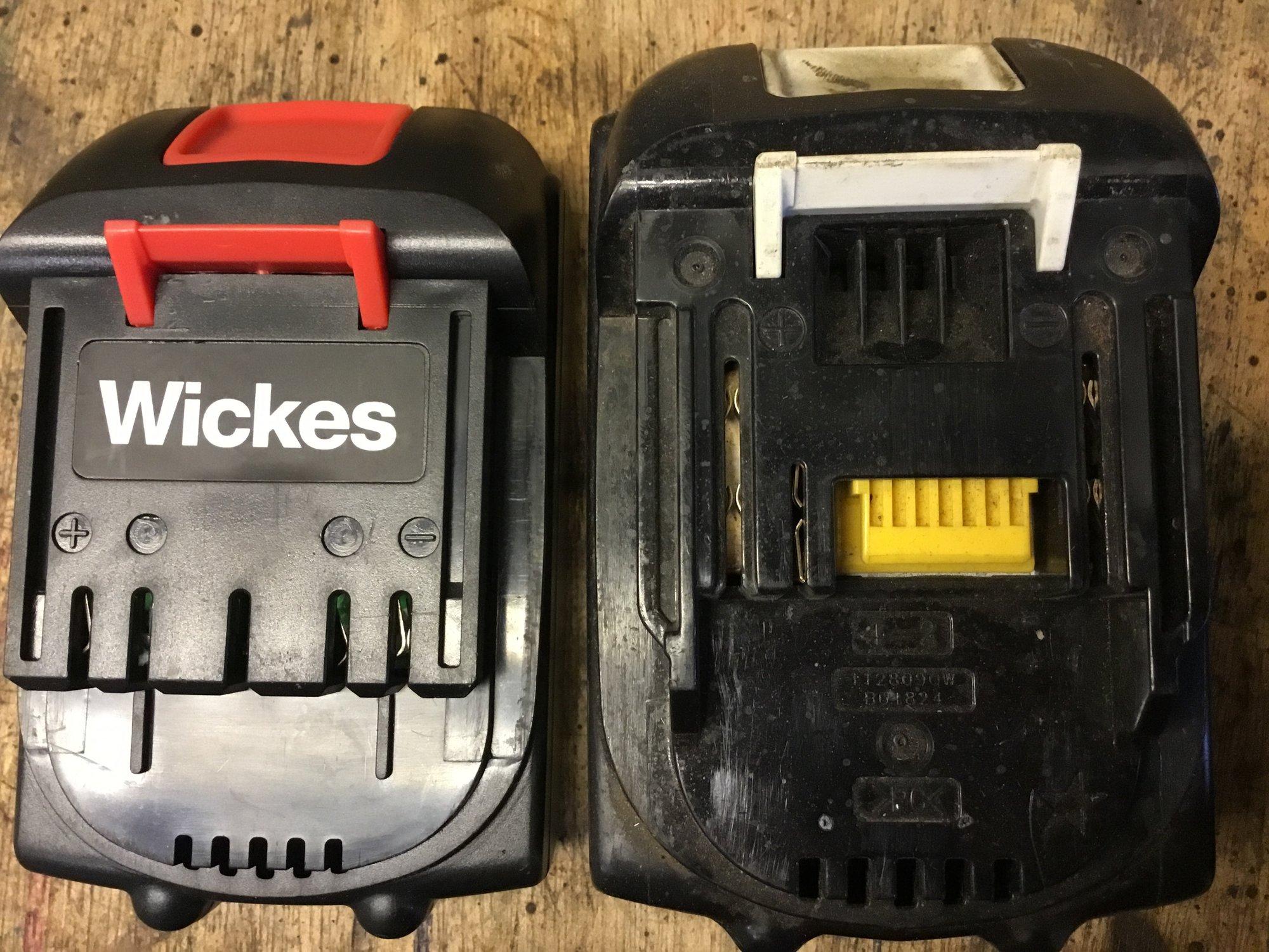

Onoff Posted April 5, 2019 Author Posted April 5, 2019 Interesting, found on another forum: "However, I notice that my Wickes el cheapo batteries almost fit. The prongs are the right width apart, the holding grooves interphase, just the metal prongs seem a bit too long and need 10mm trimming off. But they work when loosely wedged in.And the Makita only have two prongs/contacts, instead of three the Wickes has. It it almost like they were designed in the same factory then sent in different directions". He goes on: "Both batteries have three connections, the Makita tool has two connections, Wickes has three, but when I plug the Wickes battery into the Makita drill it works perfectly.I think I could trim the Wickes battery terminals 1/2” and resurrect my far superior Makita drill and driver. £50 Wickes set, versus £350 for the Makita combo.Not sure how much a couple of spare Wickes batteries would be".
PeterW Posted April 5, 2019 Posted April 5, 2019 56 minutes ago, Onoff said: It it almost like they were designed in the same factory then sent in different directions". Apologies if I’ve said this before but the Wickes and Makita 10v stuff is remarkably similar. They both use the same tri-lobe Samsung battery pack, and the mouldings are the same for the drill case. Only difference seems to be the colour and the rubber inserts on the handles. Makes me think that Wickes own brand is a contract mould and manufacture by Makita.
