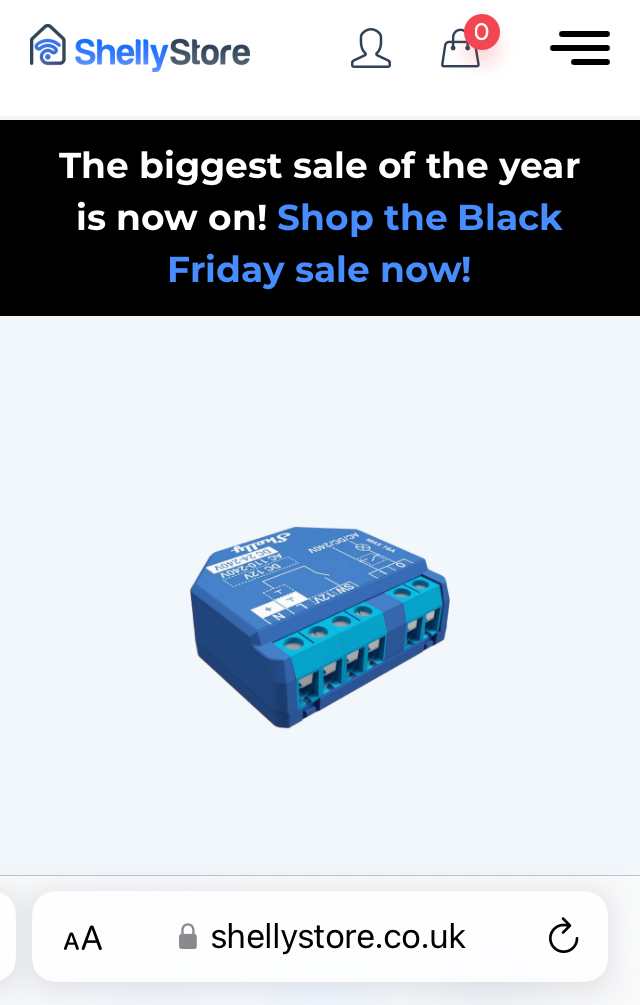

Posted
8 hours ago, G and J said:
li’d ike a few lights to be automated so they can come on and go off at set times.
A Shelly relay may be right up your street, sale on now.
  • Like 1
Posted
This would be a nice easy and cheap way to automate. Personally I’ve not had good experience with Shelly’s .
Posted
I’ve got all sorts of different Shelly stuff dotted around the house and I’ve never had any real problem with any of it which is a minor miracle as that sort of stuff is way out of my comfort zone.
  • Like 1
Posted
Yeah . I’ve seen plenty of photo of burnt out Shelly’s / capacitors blown . They claim they didn’t overload it .
My experience was a dimmer relay ( in a ceiling void so lots of airflow ) powering some lights ( max 20w - relay spec much higher than that ) . After 3 hours the Shelly shut down with overheat warning . Yet too see a zigbee or zwave device ‘panic’ over that . So I removed it . I only use Shelly’s for simple on/off ( so not on for long periods ) and where I have no choice I.e WiFi signal strong but zigbee weak .
Posted
I have pretty much every switch in my house running through Sonoff minis. So as well as potentially burning the house down im also sending everything I do to China.
However they haven't let me down, work perfectly, and my bank balance remains at £0 so I haven't been robbed yet.
  • Like 1
