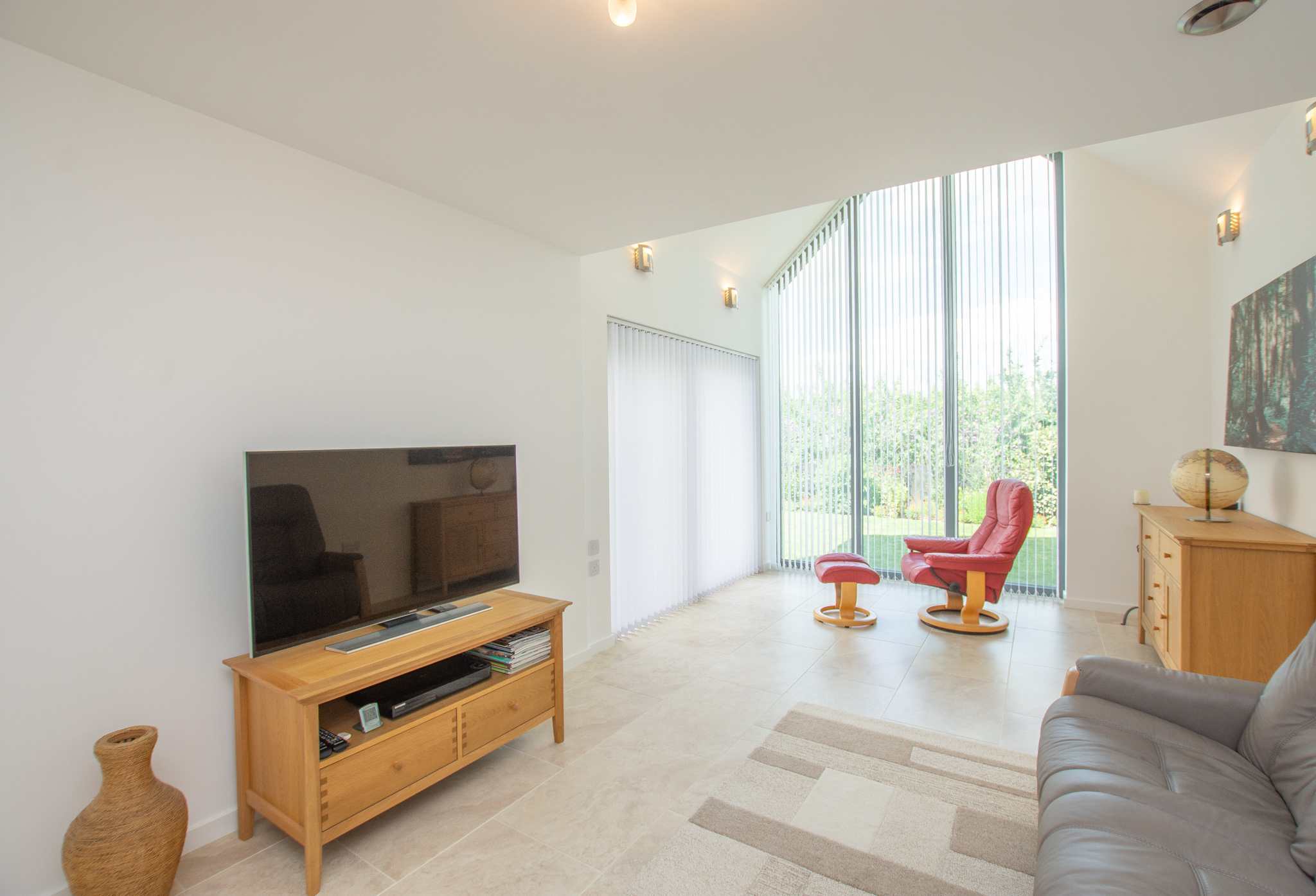

fatgus Posted November 18, 2024 Posted November 18, 2024 (edited) We're looking for a supplier that can do tall windows (roughly 5m tall x 1.0m wide) as single units. The companies we've approached to date would need to split into two units. The best solution so far, which is pretty good to be fair, would give us a 90mm-ish horizontal join. If we can find a supplier that could do them as single units, we'd consider sourcing them separately to the rest of the windows. Any suggestions gratefully received! Edited November 18, 2024 by fatgus
Redbeard Posted November 18, 2024 Posted November 18, 2024 I feel there must be too much risk of distortion with 5m 'unrestrained' (except by the glass, and that does not really want to be a stressed member, I feel). I wondered about making it as 2 units, one with a 'transom' at 2.5m and the side members sailing past that transom by say 300mm. The 2nd section has only bottom member and the 2 side members. Cut stopped pegged scarf joints on each (very easy to say...). With very accurate joinery it would look lovely, and the transom can be a 'spindly' as you like, as long as it can accommodate 2 rebates, so perhaps 60 as against the 90 mentioned by @fatgus 1
fatgus Posted November 18, 2024 Author Posted November 18, 2024 1 hour ago, Oz07 said: Does glass even come in 5m lengths? I believe it can, but of course it could be cost prohibitive... 😬 1 hour ago, Redbeard said: I feel there must be too much risk of distortion with 5m 'unrestrained' (except by the glass, and that does not really want to be a stressed member, I feel). That's a good point. I think with the companies I've approached, the frame seems to be the limiting factor. Most don't seem to go over 3.5m. I don't really want to push any supplier to their limits as that seems to be when problems arise, but if there's any way to achieve the unbroken 5m, we'd like to look into it...

JohnMo Posted November 18, 2024 Posted November 18, 2024 We are at about 5m split into 2x2.5m tall. Even then there was special lifting gear involved. Couple issues with the design Bigger means thicker, which in turn means heavy. Our triple glazed 2.5m tall are already 3 x 5.8mm thick panes and at design wind loads have a nearly 16mm deflection. Once over 2m tall you really don't notice the join as its above your eye line. Doing it again I would just stop the glazing at the 2.5m level and have well insulated above that. 1

craig Posted November 19, 2024 Posted November 19, 2024 Truth be told, you'll struggle to get someone to do this for you, most will stop at 1m width, 3.5m height or 3.5m width and 1m height others can achieve slightly more and some will achieve a little more. In diagram below, this is max height/width triple glazed as standard 3.92m. You also have to take into account the maximum weight that the system can take, timber frames might only be able to take 400Kg 1
fatgus Posted November 19, 2024 Author Posted November 19, 2024 4 hours ago, craig said: Truth be told, you'll struggle to get someone to do this for you, most will stop at 1m width, 3.5m height or 3.5m width and 1m height others can achieve slightly more and some will achieve a little more. In diagram below, this is max height/width triple glazed as standard 3.92m. You also have to take into account the maximum weight that the system can take, timber frames might only be able to take 400Kg Thanks @craig. That’s pretty much what we’ve found from the suppliers we’ve contacted…. Thought it worth investigating, but we’re happy to split into two units. I’m going to speak to a couple of the oversize glazing suppliers but not hopeful that it won’t be unnecessarily expensive. Next deliberation will be where to split…
craig Posted November 19, 2024 Posted November 19, 2024 (edited) No problem, I can most likely do this in an aluminum only system but it would be very expensive. The risks involved in logistics, lifting, transportation, installation are astronomical. Edited November 19, 2024 by craig 1
saveasteading Posted November 20, 2024 Posted November 20, 2024 Another possibility is to fit a beam at mid height, a hollow section probably, inside the building. The window sections fix to that and so the sections are spanning half the distance and can very much smaller. From outside the glazing is more elegant. Inside you have a steel, which can look great or not, acc to context. 1
