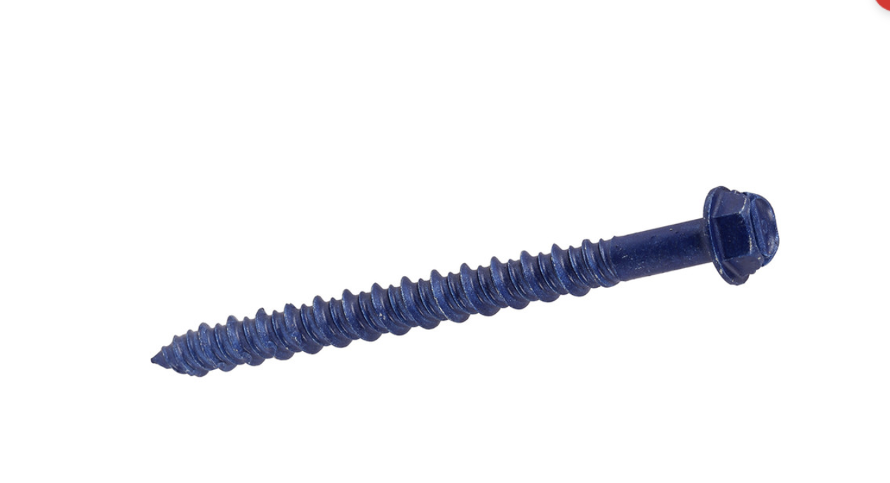

nod Posted November 18, 2024 Share Posted November 18, 2024 42 minutes ago, Thorfun said: Found this on Google https://www.fastco.co.uk/blog/what-are-tek-screws/ but it suggests that they’re used to screw in to metal. @nod how do these work in to blocks? If you use Tek screws You need Blues Threaded to the point Don’t use anything with plastic on them Nails are no good to the underside Unless you can fire hangers into the sides Something like Trapazoids Link to comment Share on other sites More sharing options...

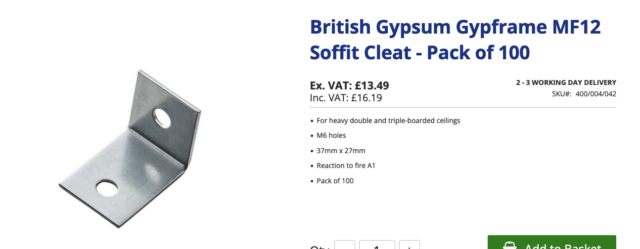

Thorfun Posted November 18, 2024 Author Share Posted November 18, 2024 also, i'm going to use MF12 soffit cleats (https://www.buildingmaterials.co.uk/british-gypsum-gypframe-mf12-soffit-cleat-box-of-100?mh_keyword=&mh_matchtype=&mh_adgroupid=&mh_network=x&utm_term=&utm_campaign=pMAX:AllChannels|CatchAll&mh_campaignid=18789495083&gad_source=1&gclid=EAIaIQobChMI-_33sZnmiQMVGqRQBh3JeAMpEAQYASABEgIN-PD_BwE) i think trying to accurately nail through the hole is going to be fraught with danger! i'm really thinking a nice safe drill and concrete screw will be better for me as a DIYer. it's just needing to translate @nod and his blue tip tek screws. 😉 Link to comment Share on other sites More sharing options...

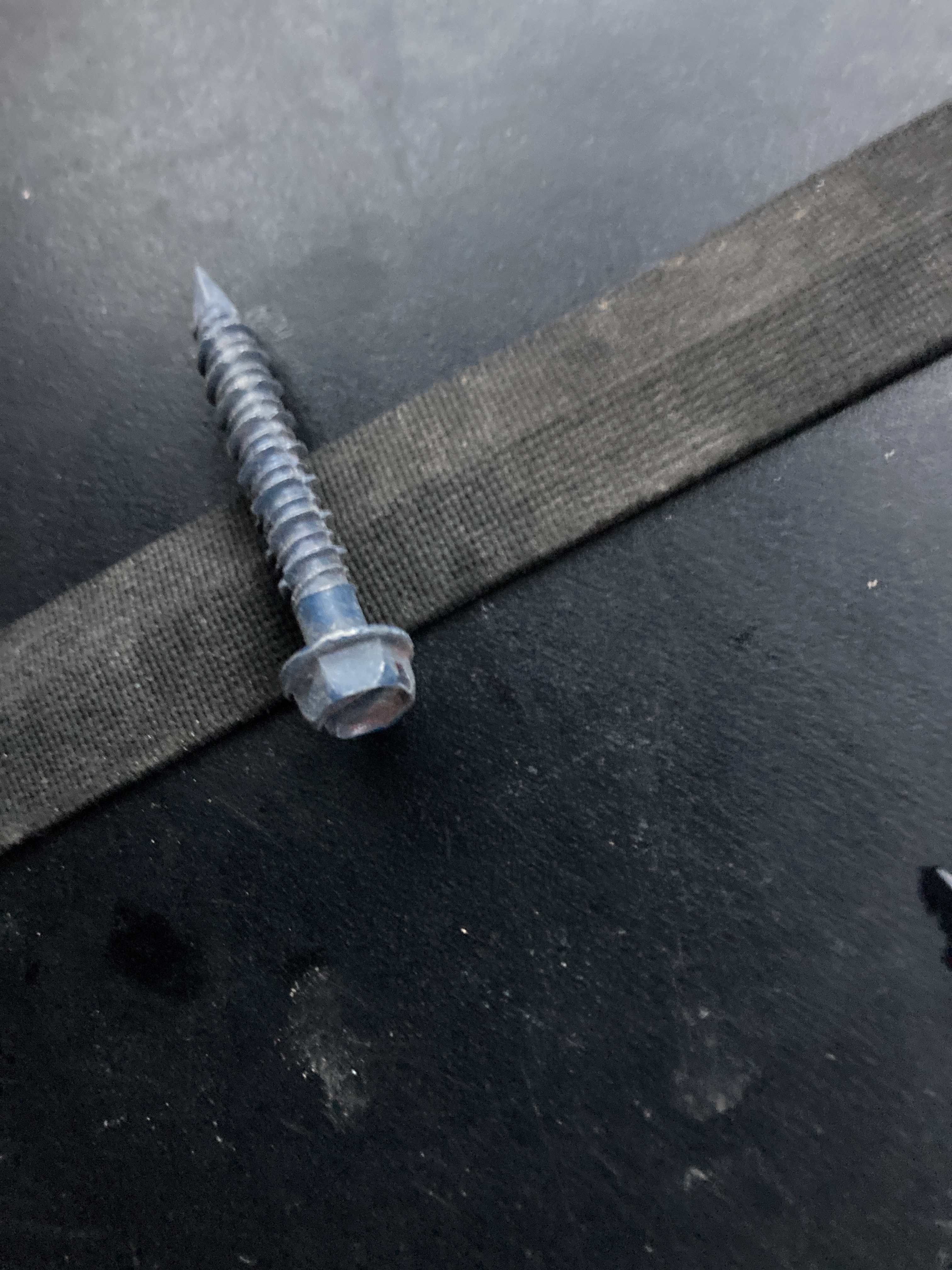

nod Posted November 18, 2024 Share Posted November 18, 2024 1 Link to comment Share on other sites More sharing options...
Thorfun Posted November 18, 2024 Author Share Posted November 18, 2024 9 minutes ago, nod said: thanks. that looks like a rather sharp point on that thing! much sharper than the other concrete screws i've seen. but, regardless, definitely looks like a concrete screw so those blue ones i linked before should do the trick. drill a hole and screw in, right? if i go for 50mm screws is that excessive? the photo of yours looks shorter than that. Link to comment Share on other sites More sharing options...
Gone West Posted November 18, 2024 Share Posted November 18, 2024 2 hours ago, Thorfun said: I know they say self-tapping but surely that's not in to concrete, right? Product Details One-piece self-tapping concrete screw with ICC-ES Approval. For use in a variety of base materials including wood. Coated in a corrosion resistant Perma-Seal coating with an optimised thread design for low installation torque. Also incorporates a gimlet drill point for wood, no pre-drilling required. Link to comment Share on other sites More sharing options...
Thorfun Posted November 18, 2024 Author Share Posted November 18, 2024 15 minutes ago, Gone West said: Product Details One-piece self-tapping concrete screw with ICC-ES Approval. For use in a variety of base materials including wood. Coated in a corrosion resistant Perma-Seal coating with an optimised thread design for low installation torque. Also incorporates a gimlet drill point for wood, no pre-drilling required. struggling to believe that a screw can self-tap in to concrete! i guess i'll have to buy some and give it a go. Link to comment Share on other sites More sharing options...
Gone West Posted November 18, 2024 Share Posted November 18, 2024 1 minute ago, Thorfun said: struggling to believe that a screw can self-tap in to concrete! i guess i'll have to buy some and give it a go. Last year I used concrete screws to fix some timber to a concrete block wall. They are very sensitive to the hole being exactly the right size. Link to comment Share on other sites More sharing options...
Thorfun Posted November 18, 2024 Author Share Posted November 18, 2024 1 minute ago, Gone West said: Last year I used concrete screws to fix some timber to a concrete block wall. They are very sensitive to the hole being exactly the right size. yes. exactly, right? you drilled a hole and then screwed the concrete screw in? that's what i've done before as well. i guess i'm completely misunderstanding the meaning of "self-tapping". i thought it means you don't have to drill a hole but that's not true is it? you drill the hole and then the self-tapping screw creates the thread that holds it in to the hole, right? i'm such a twonk sometimes. 🤦♂️ Link to comment Share on other sites More sharing options...
