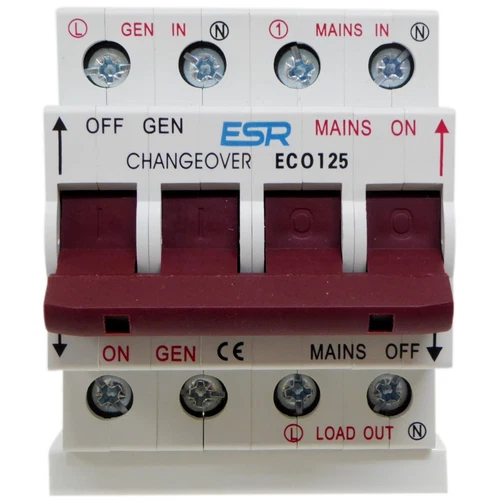

G and J Posted November 10 Share Posted November 10 53 minutes ago, ProDave said: Please tell me you are not using a widow maker lead? What’s the correct way of connecting in a generator (I’m not thinking of getting one, but I am curious)? Link to comment Share on other sites More sharing options...
Roger440 Posted November 10 Share Posted November 10 45 minutes ago, FuerteStu said: Probably got a sticker on one end that says [plug in this end first] to make it safe... Its 15 mins work to fit an isolater. Though you do still need to remember to isolate the incoming before you turn it on. Link to comment Share on other sites More sharing options...
ProDave Posted November 10 Author Share Posted November 10 Just now, G and J said: What’s the correct way of connecting in a generator (I’m not thinking of getting one, but I am curious)? A changeover switch Mounted in a suitable enclosure with the generator in connected to a suitable INLET connector rated for the generator output. 1 Link to comment Share on other sites More sharing options...
G and J Posted November 10 Share Posted November 10 5 minutes ago, ProDave said: A changeover switch Mounted in a suitable enclosure with the generator in connected to a suitable INLET connector rated for the generator output. Thank you. Presumably the left hand bottom two connectors are redundant? Link to comment Share on other sites More sharing options...
ProDave Posted November 10 Author Share Posted November 10 2 minutes ago, G and J said: Thank you. Presumably the left hand bottom two connectors are redundant? Yes. If you look at the detail that is 2 double pole switches bolted together one normally open the other normally closed and that is a 2 pole busbar jumper across the bottom and the left hand terminals are only for connecting that busbar. Link to comment Share on other sites More sharing options...
G and J Posted November 10 Share Posted November 10 3 minutes ago, ProDave said: Yes. If you look at the detail that is 2 double pole switches bolted together one normally open the other normally closed and that is a 2 pole busbar jumper across the bottom and the left hand terminals are only for connecting that busbar. Understood. I didn’t realise that was a busbar. Makes perfect sense. Link to comment Share on other sites More sharing options...

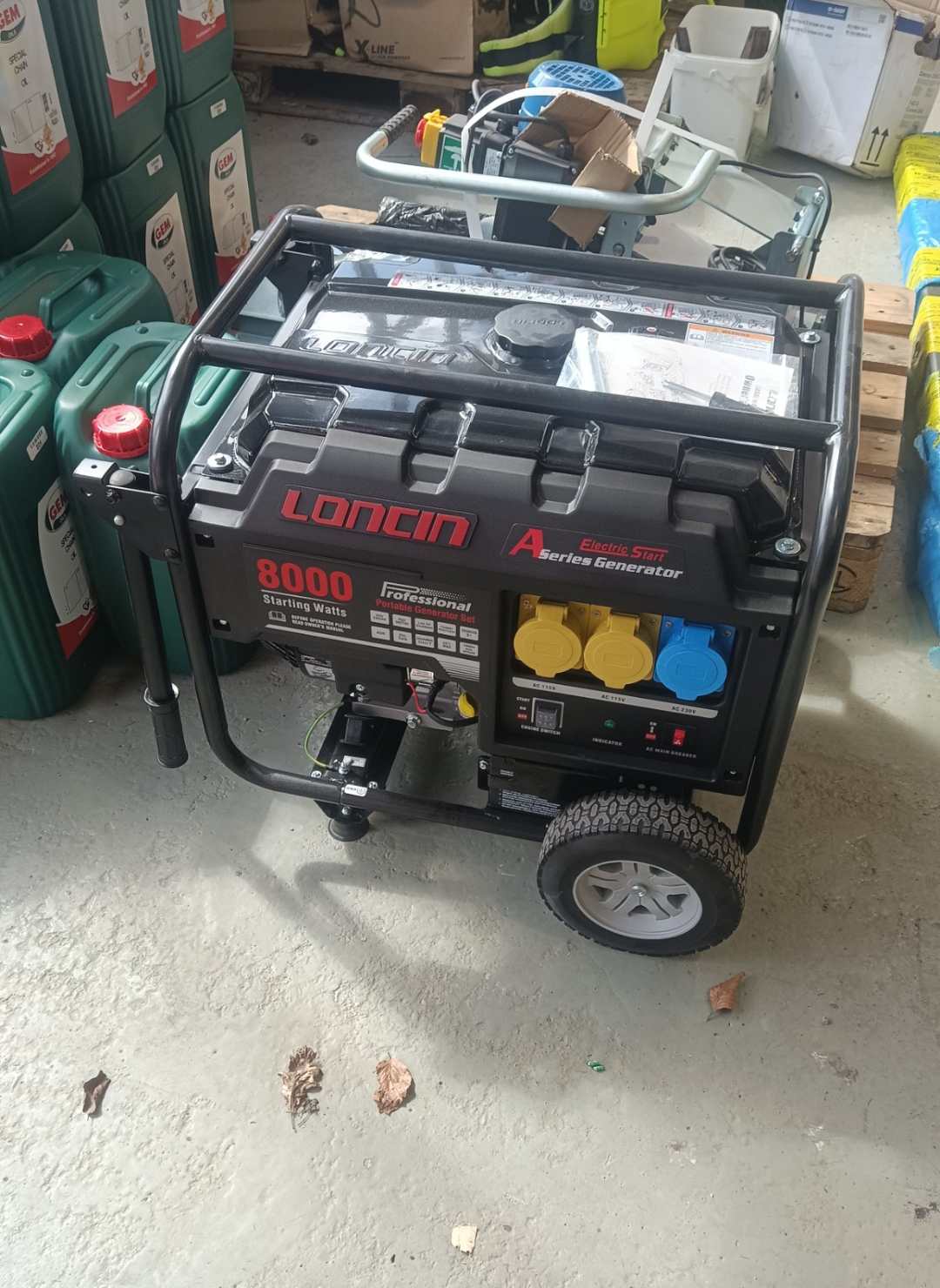

saveasteading Posted November 10 Share Posted November 10 It's a good morning for lessons from Prof. @ProDave. If we wanted the generator just for hunkering down in a corner for a couple of days, then what size of genny would suffice? Freezer, kettle, a few lights, battery chargers, tele, maybe an air fryer can cook everything. Not all on at once. Does a running genny need a minimum load? Link to comment Share on other sites More sharing options...
ProDave Posted November 10 Author Share Posted November 10 As soon as you mention air fryer or kettle that's 3kW minimum and then only one at a time. There shouldn't be a minimum load requirement, but they will be less efficient at small loads. 1 Link to comment Share on other sites More sharing options...
Iceverge Posted November 10 Share Posted November 10 1 hour ago, saveasteading said: It's a good morning for lessons from Prof. @ProDave. If we wanted the generator just for hunkering down in a corner for a couple of days, then what size of genny would suffice? Freezer, kettle, a few lights, battery chargers, tele, maybe an air fryer can cook everything. Not all on at once. Does a running genny need a minimum load? I bought a Keystart loncin 8000 about a year ago. Haven't had cause to use it yet but in a trial it boiled kettles etc just fine. I started it after dry 9 months of no use a week ago to see if it would still operate and it fired straight up on 12 month old petrol. The one tip the man in the shop gave me was to not switch it off with the ignition but rather close the fuel tap on the tank, and let the carburettor run completely dry. 1 Link to comment Share on other sites More sharing options...
