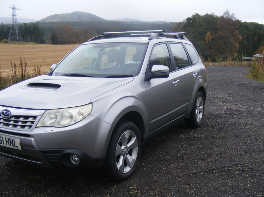

ProDave Posted November 8, 2024 Posted November 8, 2024 Take a look at this picture No we are not looking at that trusty reliable subaru (that happens to be for sale) We are looking at the road planings it is parked on. That was constructed as a temporary loading bay for log lorries for some planned tree extraction (that has not yet happened) As far as I could tell from what I saw of it's construction is it is just a load of crushed stone of some sort laid and compacted and topped by quite a thick layer of road planings, probably laid and compacted in layers. It certainly feels solid and does not appear to move as you drive or walk on it.
saveasteading Posted November 8, 2024 Posted November 8, 2024 Road planings are a favourite material. It is a highly controlled product as if type 1 with added sticky. So if it is well broken up into being like a load of stone, and is well spread and compacted, it will be very strong. I can't remember the bitumen content but it is a small %. About 3% maybe? ie lots of good stone. Then you get a hot summer and it adjusts and sticks even better. BUT make sure you aren't getting footpath surfacing. It is not strong and not a good surface for traffic. The only downside of planings is that it used to be cheap but now is popular. And quite rightly it can now be recycled for roads...it used to be designated as waste.
saveasteading Posted November 8, 2024 Posted November 8, 2024 26 minutes ago, scottishjohn said: how thick can you lay them so they will not move about with traffic Best put courser cheaper stone down first. Then 50mm minimum 100 better.
