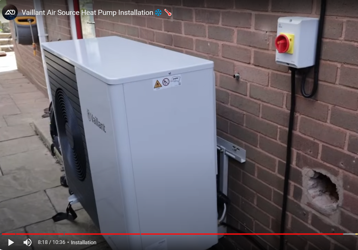

Tony L Posted November 6, 2024 Share Posted November 6, 2024 Good point, ProDave, but is this something that ever needs to be done? I suppose you could have the underground pipes passing through one of those cheap plastic inspection chambers if you're concerned you may need to bleed, in future. To answer Joe's question (although it was directed at Nic - sorry, Nic): I'd planned to put my ASHP against the wall on the south side of my house, which would mean it would be a prominent feature in my small patio + back garden area, but these things are so ugly (& there's the noise & cold draught to consider as well), I'm thinking it may be well worth be worth the additional installation, running & maintenance costs to put it out of the way, against the boundary hedge to the east. That would put it about 4m away from the house. This would mean the pipes would have to go underground, & if they're underground they may as well come up into the house through the block & beam floor. Please have a go at dissuading me. While I'm on the subject, I'll just ask, do I have to have one of these electric isolator switches, as shown in the picture, below? Does it have to be outside, near the unit or can it be in the house? The electrician who made this video explains it must be at least 200mm away, but he didn't mention a max. distance. 1 Link to comment Share on other sites More sharing options...

sharpener Posted November 15, 2024 Share Posted November 15, 2024 (edited) On 06/11/2024 at 16:03, Tony L said: While I'm on the subject, I'll just ask, do I have to have one of these electric isolator switches, as shown in the picture, below? Does it have to be outside, near the unit or can it be in the house? The electrician who made this video explains it must be at least 200mm away, but he didn't mention a max. distance. They are mandatory or nearly so i.e. electricians will want to fit them citing MCS rules. They need to be outside the prohibited envelope for a R290 (propane) HP which is why in the pic it is just above the top of the HP. The theory is they are needed so they can be visibly padlocked off for operative safety during maintenance. I don't know why a padlockable isolator, rcd or two-pole mcb indoors is not thought to be adequate, as it is for other appliances. To my mind they mean un-necessary connections requiring an extra outdoor enclosure which is ugly and an extra expense. If they are truly necessary they should be designed neatly into the HP enclosure itself. There is an alternative school of thought that says they need to be next to the HP so it can quickly be switched off in case of fire or other emergency, I believe this is an urban myth. Mine is padlocked on as it is sited right on the path to the house and near a public highway. Mainly as a deterrent, it would be easy enough to break/cut through the plastic to turn it off in a genuine emergency. Edited November 15, 2024 by sharpener Link to comment Share on other sites More sharing options...
Tony L Posted November 18, 2024 Share Posted November 18, 2024 Thanks. Something to ask about before I accept a quote then. I have these switches outside my office, for my a/c, & some kids turned them off a few times. I didn't realise I may be able to lock them. Link to comment Share on other sites More sharing options...
