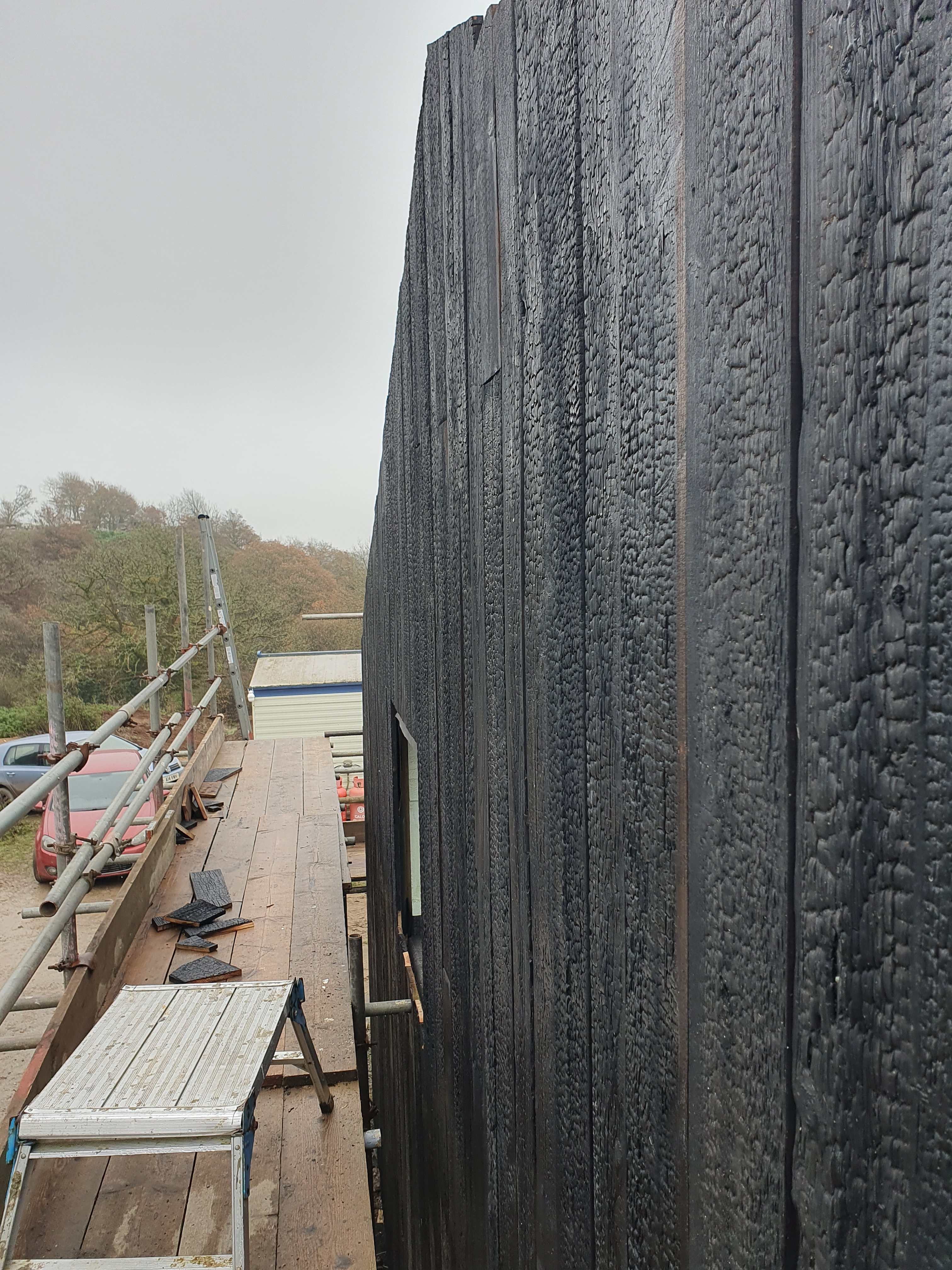

Thorfun Posted November 5, 2024 Share Posted November 5, 2024 Not cheap but we went for Shou Sugi Ban (charred timber). Looks amazing and no maintenance at all. With the benefit of being fireproof, insect proof, weather proof. Link to comment Share on other sites More sharing options...

Onoff Posted November 5, 2024 Share Posted November 5, 2024 1 hour ago, Thorfun said: Not cheap but we went for Shou Sugi Ban (charred timber). Looks amazing and no maintenance at all. With the benefit of being fireproof, insect proof, weather proof. Do you have to do all faces & edges? Link to comment Share on other sites More sharing options...
Thorfun Posted November 5, 2024 Share Posted November 5, 2024 17 minutes ago, Onoff said: Do you have to do all faces & edges? Not sure what you mean? Link to comment Share on other sites More sharing options...
Onoff Posted November 5, 2024 Share Posted November 5, 2024 6 minutes ago, Thorfun said: Not sure what you mean? Do you have to char all faces & edges? Link to comment Share on other sites More sharing options...
Thorfun Posted November 5, 2024 Share Posted November 5, 2024 Oh right! We bought ours ready charred. Edges are fully charred and the back was also blackened but not charred to the same extent as the front. might be worth asking @Tom if he did his all around as he said he did his himself. Link to comment Share on other sites More sharing options...

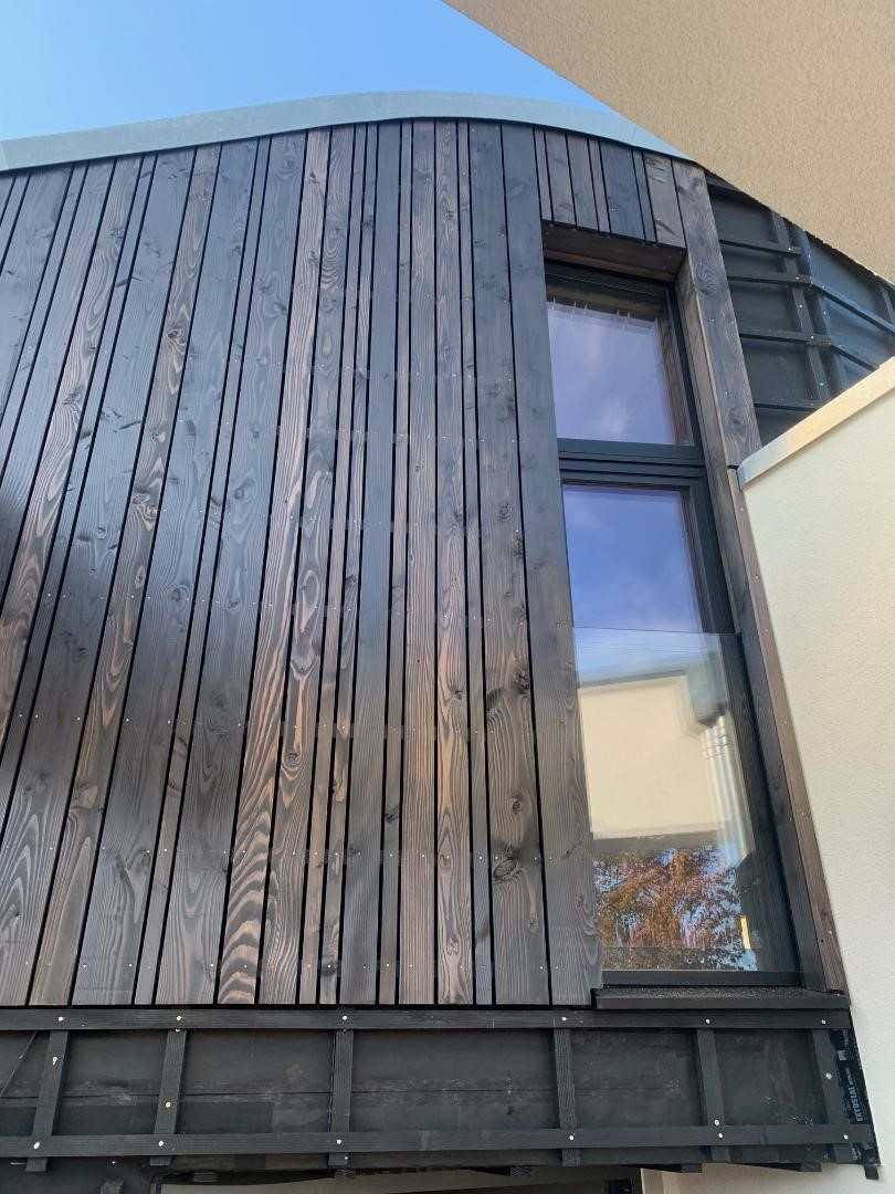

markharro Posted November 5, 2024 Share Posted November 5, 2024 This is ours as work in progress. We used a black stain from Treatex on Douglas Fir 1 Link to comment Share on other sites More sharing options...
Firsttimer Posted November 5, 2024 Share Posted November 5, 2024 We Shou sugi banned our cladding also, which saved a sweet 10k. Terribly boring, but only about took us about 50 man hours from what I remember. 1 Link to comment Share on other sites More sharing options...
Firsttimer Posted November 5, 2024 Share Posted November 5, 2024 47 minutes ago, Onoff said: Do you have to do all faces & edges? We just charred the front and edges. Link to comment Share on other sites More sharing options...
