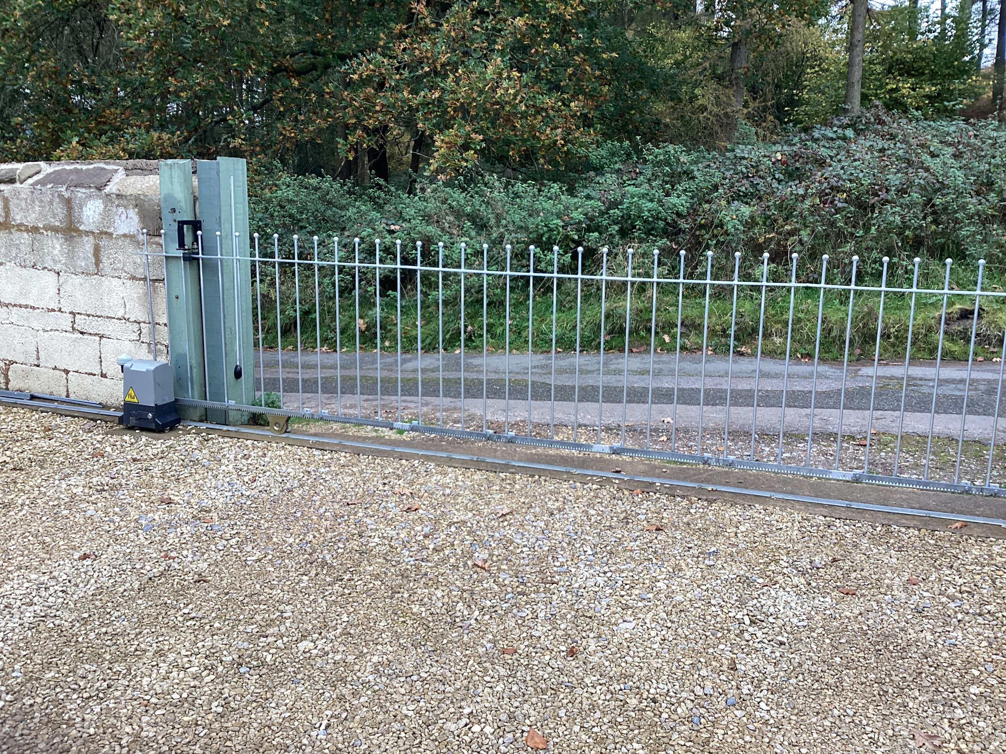

Onoff Posted October 30, 2024 Share Posted October 30, 2024 My brick pillars have a 4" box up the middle. The (sliding) gate loads go onto that, not the pillars. I put a buff coloured, silicone joint around the box section gate post so the loads don't transmit to the brick: Link to comment Share on other sites More sharing options...

joe90 Posted October 30, 2024 Share Posted October 30, 2024 (edited) @Andehh have you room for sliding gates? On offs and mine are sliding so very little weight on the pillars. Mine also is on a slight slope and the motor copes easily for that rise. I made mine from standard fence panels welded together. Edited October 30, 2024 by joe90 Link to comment Share on other sites More sharing options...
