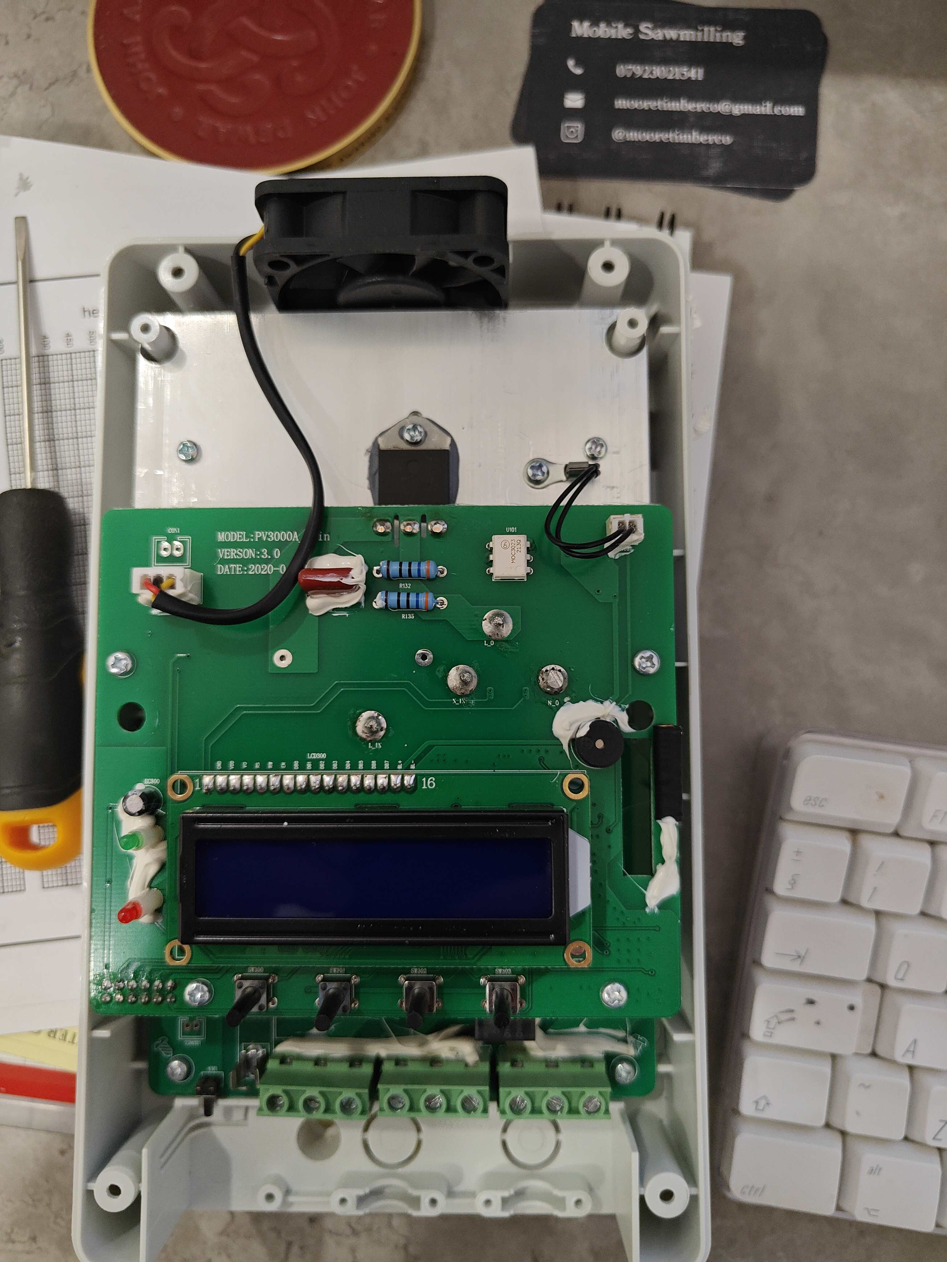

JohnMo Posted October 26, 2024 Share Posted October 26, 2024 My second PV diverter has now given up. Coming to the conclusion the multiple switching isn't good for their health and they are cheap rubbish. Not willing to part anymore cash on them. So looking to go basic but smart enabled. Control scheme will be something like x kW being generated, battery state of charge is higher than x%, run full 3kW into immersion for 30 min recheck and run again etc Can do the control via Shelly and home assistant - have both already. But need a relay that is happy switching 3kW reliably - anyone got a recommendation? Not sure I would trust a Shelly do that directly Does the control sound feasibly? Link to comment Share on other sites More sharing options...

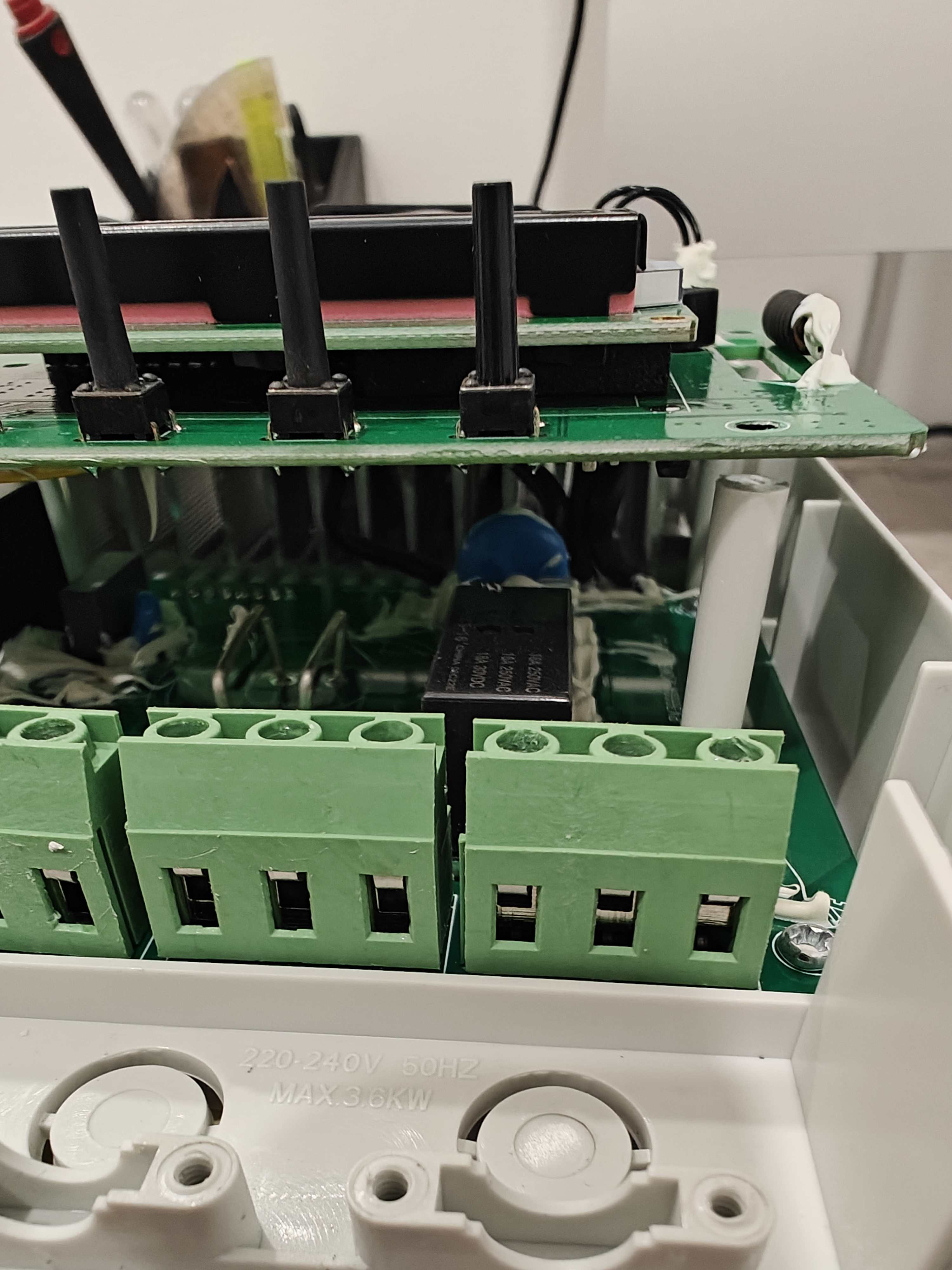

Alan Ambrose Posted October 26, 2024 Share Posted October 26, 2024 Probably just the relay - you can probably change it easy enough if you can do basic electrical soldering. It'll be marked with it's part number. Link to comment Share on other sites More sharing options...
ProDave Posted October 26, 2024 Share Posted October 26, 2024 Open up the failed ones and post pictures inside. I bet they can be repaired and improved. I fixed one for a friend where the wiring uses was totally inadequate, rewired it with thicker wire etc and it has lasted years since. Likewise a cheap Chinese inverter failed due to insufficient heatsink compound. 2 new transistors properly mounted with enough compound and that is still working years later. Link to comment Share on other sites More sharing options...
JohnMo Posted October 26, 2024 Author Share Posted October 26, 2024 Opened up the box, and found the fuse blown. So first job replaced fuse and check over the wiring to the box. Other than that without desoldering it cannot be taken apart easily. Big heat sink and fan at the top Link to comment Share on other sites More sharing options...

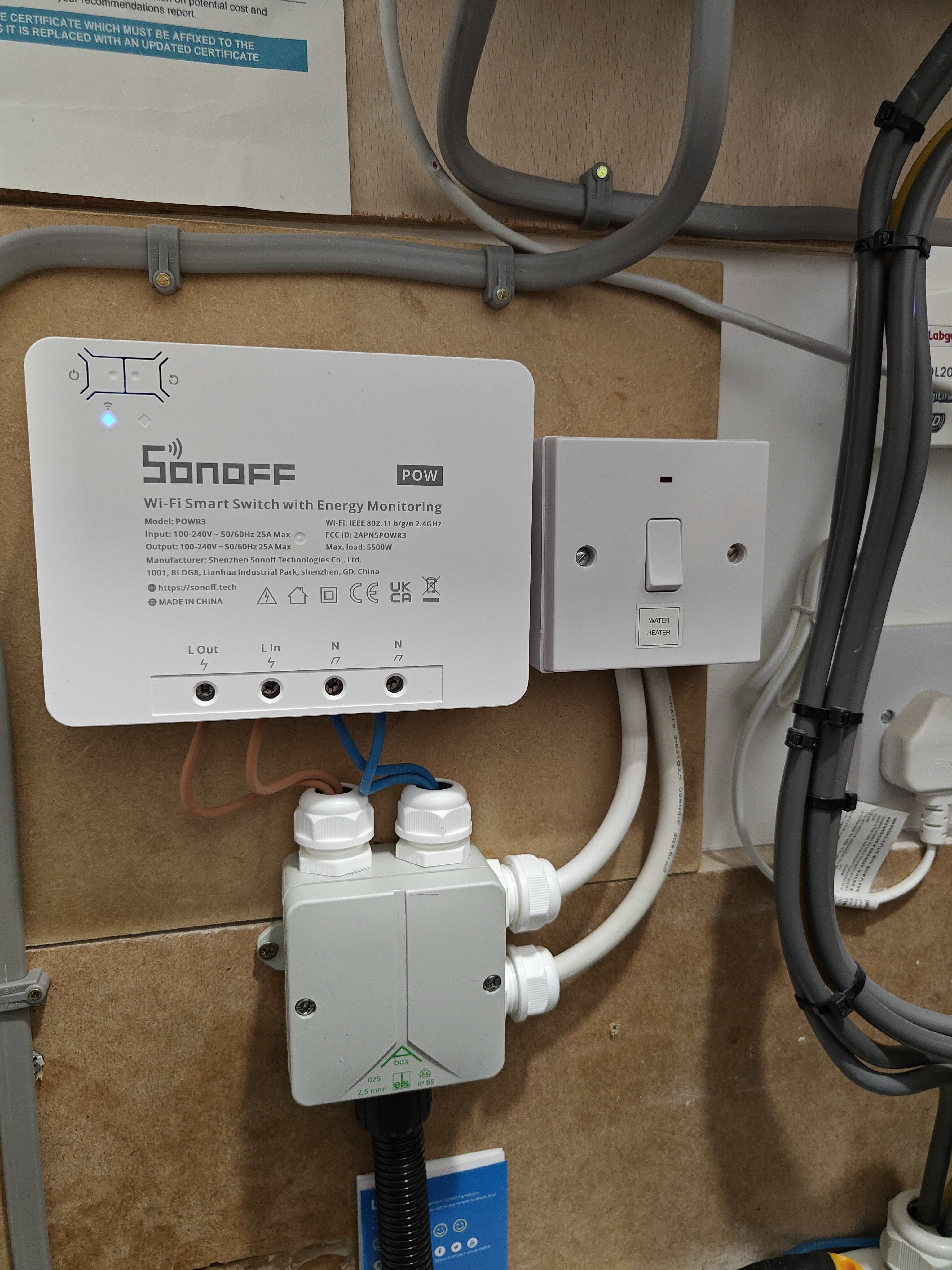

JohnMo Posted October 28, 2024 Author Share Posted October 28, 2024 Well that was all pretty simple Sonoff POWR3, £30 from Amazon An indication 20A switch for immersion heaters, a small JB and surface mount 1G box and 2 packs of glands £15 from Screwfix. So £45 all materials. 1 hour research on adding Sonoff to Home Assistant - Added Sonoff app to phone for pairing, same app added in Home Assistant plus SonoffLAN. Simple automation, trigger - PV generation above 500W, condition battery above 98%, run immersion for 10 mins, restart automation if condition remains true. Sends me a notification. Also records energy usage so added that to home screen. Wired in parallel, so switch can trigger the immersion manually. Indication light on switch comes on when relay is triggered. 1 Link to comment Share on other sites More sharing options...
ProDave Posted October 28, 2024 Share Posted October 28, 2024 7 minutes ago, JohnMo said: Simple automation, trigger - PV generation above 500W, condition battery above 98%, run immersion for 10 mins, restart automation if condition remains true. That is vastly different to a "normal" PV diverter. Your example appears to be turning on the immersion with a relay and leaving it on for a time and re evaluating. A "normal" PV diverter measures PV generation and house consumption (in my case every half second) and adjusts the power being sent to the immersion by burst firing the immersion using a solid state relay. I guess in your case you are using the immersion as a "excess power dump load" so it only needs to be a coarse on or off, with the battery controller soaking up the rest and doing the detailed work. 1 Link to comment Share on other sites More sharing options...
JohnMo Posted October 28, 2024 Author Share Posted October 28, 2024 4 minutes ago, ProDave said: That is vastly different to a "normal" PV diverter. Your example appears to be turning on the immersion with a relay and leaving it on for a time and re evaluating. A "normal" PV diverter measures PV generation and house consumption (in my case every half second) and adjusts the power being sent to the immersion by burst firing the immersion using a solid state relay. I guess in your case you are using the immersion as a "excess power dump load" so it only needs to be a coarse on or off, with the battery controller soaking up the rest and doing the detailed work. Advantage of the battery in the system is use case becomes simple. Took me a while for that realisation, keep it simple. Think the "normal" diverter and battery control may fight each other a little and you certainly get electric slipping past to the grid. Link to comment Share on other sites More sharing options...

sgt_woulds Posted November 5, 2024 Share Posted November 5, 2024 Are those single-insulated tails? (Blue and Brown cables) If so, they need additional mechanical protection to comply with wiring regs. Diverters are prone to failure after a few years - they are normally fitted in airing cupboards without airflow - heat soaking of components is probably a factor in the failure rates. The most robust units we fitted were the Solic 200 (Designed by an ex-MOD engineer - bulletproof) without bells and whistles or 'smart stuff' going on. From your description, once the battery tops up, and the underfloor is up to temperature, the immersion kicks in at full whack. If PV is not producing enough to supply the full rated power of the immersion, (and other loads in the house) the battery kicks in to supply the rest? If this situation continues for a period of time then battery drops below 95%, immersion switches off and goes back to charging the battery. In this scenario, the battery is discharging and recharging a lot at the top end of its capacity. Have you discussed this with the manufacturer and are they happy to maintain the warranty in this scenario? The last 20% of charging on Lithium cells creates heat and internal resistance - depending on the chemistry this will put a lot of stress on the cells and shorten the life expectancy. When we were running a fleet of 4 Nissan E-NV 200, half the vehicles were charged to 100% regularly but then discharged, (driven!) until at least 20% before a full recharge cycle. After 2 years battery health was very good, with no loss of range (140 miles indicated on the GoM but 100 miles max in RW use with load - 80 miles average per day with at least 400 kg in the back). The other vans never dropped below 75% SOC and were constantly topped back up to 95-100%, (short infrequent road trips with same loading). After 2 years the range had reduced in RW use to 80 miles max. I realise the chemistry, scenario and stress is different for a vehicle compared to a static battery but I'd be surprised if you'll achieve maximum life expectancy with this regime - which could cost a lot more in the long run than replacing diverters. Please keep us updated - it would be useful to know how this works after a couple of years as it is an interesting setup. Link to comment Share on other sites More sharing options...

Mattg4321 Posted November 9, 2024 Share Posted November 9, 2024 (edited) Not that impressed with the design of that Sonoff kit. Makes it awkward to comply with the regulations. Exposed basic insulation (brown and blue). Needs mechanical protection as above. Also, those exposed live terminal screws are a potential danger. Edit: upon further investigation, that’s designed to be fitted inside an enclosure with a DIN rail Edited November 9, 2024 by Mattg4321 Link to comment Share on other sites More sharing options...
