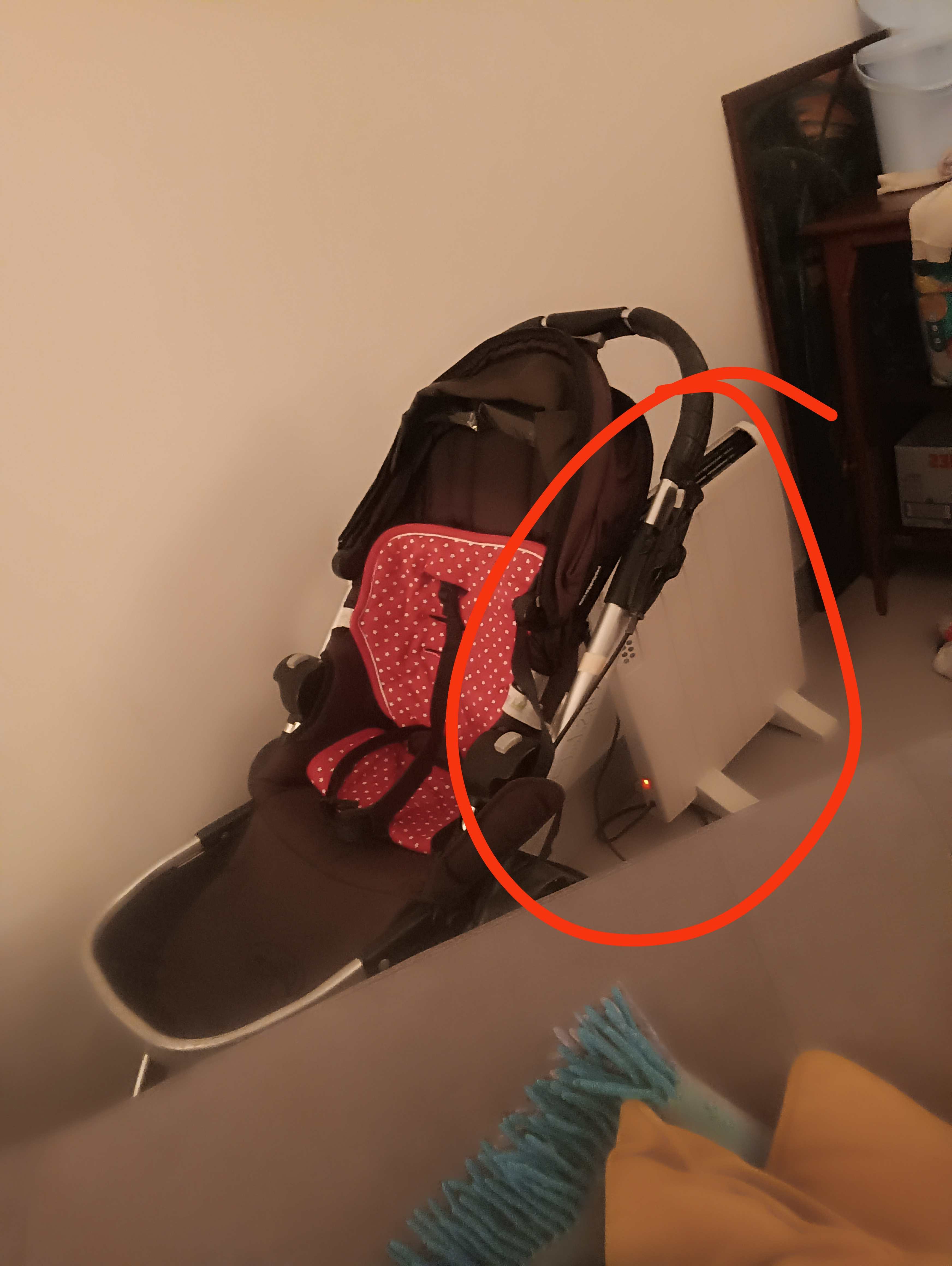

Iceverge Posted October 23, 2024 Share Posted October 23, 2024 (edited) 2 hours ago, SteamyTea said: So how do you size the thermal emitters? And take into account differing window sizes. Get you fabric right and anything/anywhere will heat the house. My Mrs just flicked the switch on that 900w thermostatic electric rad. It will tick over from now until morning on cheap leccy. The whole place stays at about 20-21 Deg. It makes little difference where you put the rad downstairs. I'm waiting on my heat pump mate to do the gas connection on the A2A in the hallway. That's only going in to save €500/annum on electricity though. Otherwise I really appreciate the simplicity of direct electric. Edited October 23, 2024 by Iceverge Link to comment Share on other sites More sharing options...
