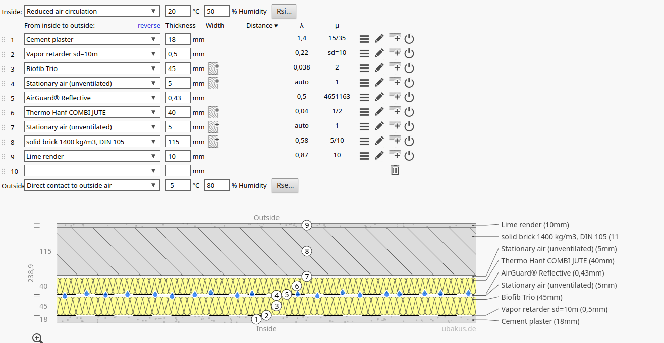

Garald Posted October 18, 2024 Share Posted October 18, 2024 (Quick summary: this is a north-facing masonry wall that has already been insulated from the inside (with a combination of reflective insulation and 45mm of BioFib Trio; both "breathe"). I am considering insulating from the outside as well because - I am concerned that there may be condensation problems in the long term (Ubakus thinks there will be) - the reflective insulation underperforms, or so a thermal camera tells me. Of course I'd need the outside insulation to also be breathable, i.e., permeable to water vapor.) Two options that have been mentioned by possible installers are polystyrene (this seems very standard; must make sure the installation is breathable) and rock wool. Today, an installer (who will come visit in a couple of days) proposed wood fibre. In brief, he said - in terms of cost: wood fibre > rockwool > polystyrene - the R per cm of wood fibre is very nearly as good as that of rockwool. - he doesn't see the point of rockwool, as wood fibre has much greater thermal mass, and that is helpful during the summer. (OTOH, this is a northern wall, so sun exposure is not a big issue.) - he said wood fibre gives excellent - He also says rockwool has much greater environmental costs than wood fibre. Is this true? How does the environmental impact of rockwool vs. polystyrene help? - He waved away my concerns about the use of flammable materials, saying there are no rules from the fire code about that (this is basically a house, not a tall building). I'd still rather not burn. Is the flammability of wood fibre or polystyrene a real issue? Link to comment Share on other sites More sharing options...
Iceverge Posted October 18, 2024 Share Posted October 18, 2024 57 minutes ago, Garald said: am concerned that there may be condensation problems in the long term (Ubakus thinks there will be) Post a snapshot. I'm curious to have a look. 58 minutes ago, Garald said: the reflective insulation underperforms, or so a thermal camera tells me. More detail again, what product did you use. Any thermal pics would be interesting. 58 minutes ago, Garald said: Of course I'd need the outside insulation to also be breathable, i.e., permeable to water vapor.) It depends..... I believe you are in Paris, near other buildings. I would probably rule out EPS for the fire reasons you mentioned there. Rockwool and woodfiber would both be fine. My preference would be rockwool as it's more flexible and can conform to any imperfections better. Link to comment Share on other sites More sharing options...

Garald Posted October 19, 2024 Author Share Posted October 19, 2024 6 hours ago, Iceverge said: Post a snapshot. I'm curious to have a look. The exact (?) data on the insulation is here: (The diagram there is not from Ubakus - it's from the pdf given to me by the fake architect. Long story - a real lawyer is now taking care of that.) I have tried to reproduce this on Ubakus, with the following approximations: (a) I couldn't find ATI PRO MULTI HPV there, so I've chosen "AirGuard Reflective"; (b) I've keyed in both layers of air as unventilated (since I do not see how the one next to the masonry is supposed to be ventilated) and (c) I have used '1952 solid brick, 1400 kg/m3' (a medium density within the list) instead of my unknown masonry from the early 30s. Here is what I get: Link to comment Share on other sites More sharing options...

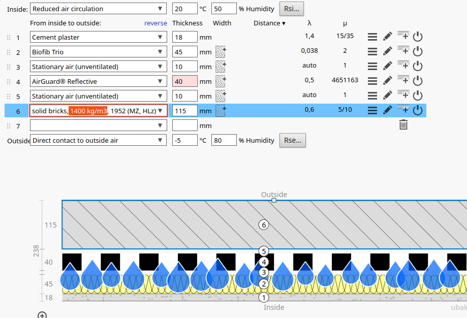

Garald Posted October 19, 2024 Author Share Posted October 19, 2024 7 hours ago, Iceverge said: Post a snapshot. I'm curious to have a look. Here is a second attempt - again, approximate, but maybe more realistic. What I have done here: - ATI PRO MULTI HPV is 40mm thick - the reflective insulation is a combination of linen and some sort of wadding ("ouate"): It's supposed to have an intrinsic R of 1.96, which doesn't sound very believable for 4cm. I've keyed it in as a reflective insulation layer + 4cm worth of a hemp-jute product that Ubakus has on file. - I've included a vapor barrier (which is the plans; I hope it's really there - I saw it on other walls when the insulation was being installed). As you can see from the diagram, Ubakus still predicts some condensation (nothing as dramatic as before). FT_ati_pro.pdf Link to comment Share on other sites More sharing options...

Iceverge Posted October 19, 2024 Share Posted October 19, 2024 What an experience with your designer. I hope it gets resolved. I assume you didn't tackle the airtighess yourself and didn't blowerdoor test it or fastidiously supervise the workmanship? The reason I ask is that that multi foil layers depend very highly on stationary air to give meaning insulative value. Try playing with Ubakus to see what happens if you put ventilated air in there instead. It'll collapse the U Value. What you've effectively ended up with is 50mm of Hemp insulation between battens,decoupled from the solid wall, giving I would estimate a U Value of about 1 W/m²K. It's lightly there's some wind washing behind the insulation too. Could you describe in words the exact build up for clarity please. EG 300mm solid wall 20mm render Link to comment Share on other sites More sharing options...

Garald Posted October 19, 2024 Author Share Posted October 19, 2024 PS. Is the insulation guy right about the upsides of increasing thermal mass and hence thermal phase (by means of wood fibre)? Ubakus tells me that the phase shift is already 13 hours in the current setup (assuming 24cm of solid wall, which seems like a safe assumption - this is construction from the early 1930s; also, notice the pictures above - sideways bricks mean "solid wall", no?). With any kind of outside insulation (rock wool or wood fibre; oddly enough, Ubakus tells me that rock wool gives a greater phase) we'd be looking at a 20-21h phase. Isn't a phase closer to 12h better (day->night)? Also, it's odd that Ubakus gives a greater phase (21h total) for rockwool than for wood fibre (20h total). Doesn't wood fibre have a much greater thermal mass (2.3 J/g K) than rock wool (0.8 J/g K)? Link to comment Share on other sites More sharing options...
SteamyTea Posted October 19, 2024 Share Posted October 19, 2024 59 minutes ago, Garald said: Is the insulation guy right about the upsides of increasing thermal mass and hence thermal phase No he is not right. It is too small a difference to notice. It is thermal inertia, not thermal mass. The k-value becomes the over riding property, not the mass or heat capacity. Link to comment Share on other sites More sharing options...
Iceverge Posted October 19, 2024 Share Posted October 19, 2024 As a general rule anyone who says "thermal mass" doesn't know what they are talking about. Link to comment Share on other sites More sharing options...
Iceverge Posted October 19, 2024 Share Posted October 19, 2024 Ok. I'm going to take a leap here and say that there was no proper Airtightness measures taken with the buildup. The comment about the deliberate weakness in the envelope doesn't bode particularly well for the rest of the gig. Airtighess is vital in ensuring a building remains healthy, comfortable and economical. The thermal bridging demonstrated by the metal studs isn't particularly good either. External insulation I think is a good idea. I'm assuming you don't live in an area of much driven rain. Rockwool gets my vote as it's fire resistant, flexible and can conform to wall imperfections, resistance to rot and insect damage and knits together with a joining boards on install. Link to comment Share on other sites More sharing options...
SteamyTea Posted October 19, 2024 Share Posted October 19, 2024 What always amazes me is that people seem to think that it needs to be about 12 hours so that daytime and nigh time equal. How many days a year does that happen in the UK, 2. Link to comment Share on other sites More sharing options...

SteamyTea Posted October 19, 2024 Share Posted October 19, 2024 2 minutes ago, Garald said: What should one aim for, then? The best thermal conductivity you can get i.e. the lowest U-Value. Link to comment Share on other sites More sharing options...
Iceverge Posted October 19, 2024 Share Posted October 19, 2024 Phase shift or decrement delay for some reason ends up far higher on people's list than it should do. I think a lot of it is because they misappropriate the effects of over glazing and poor ventilation, Airtightness and poor insulation. Link to comment Share on other sites More sharing options...
