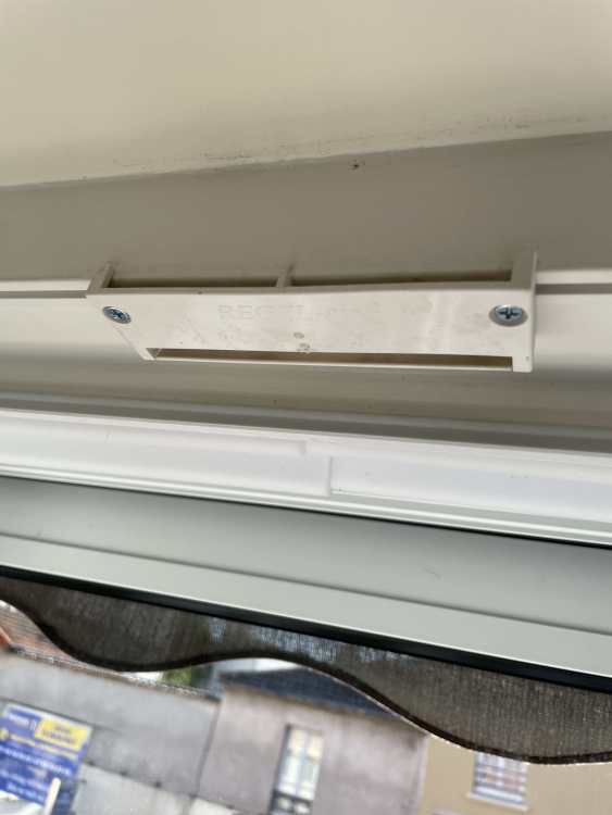

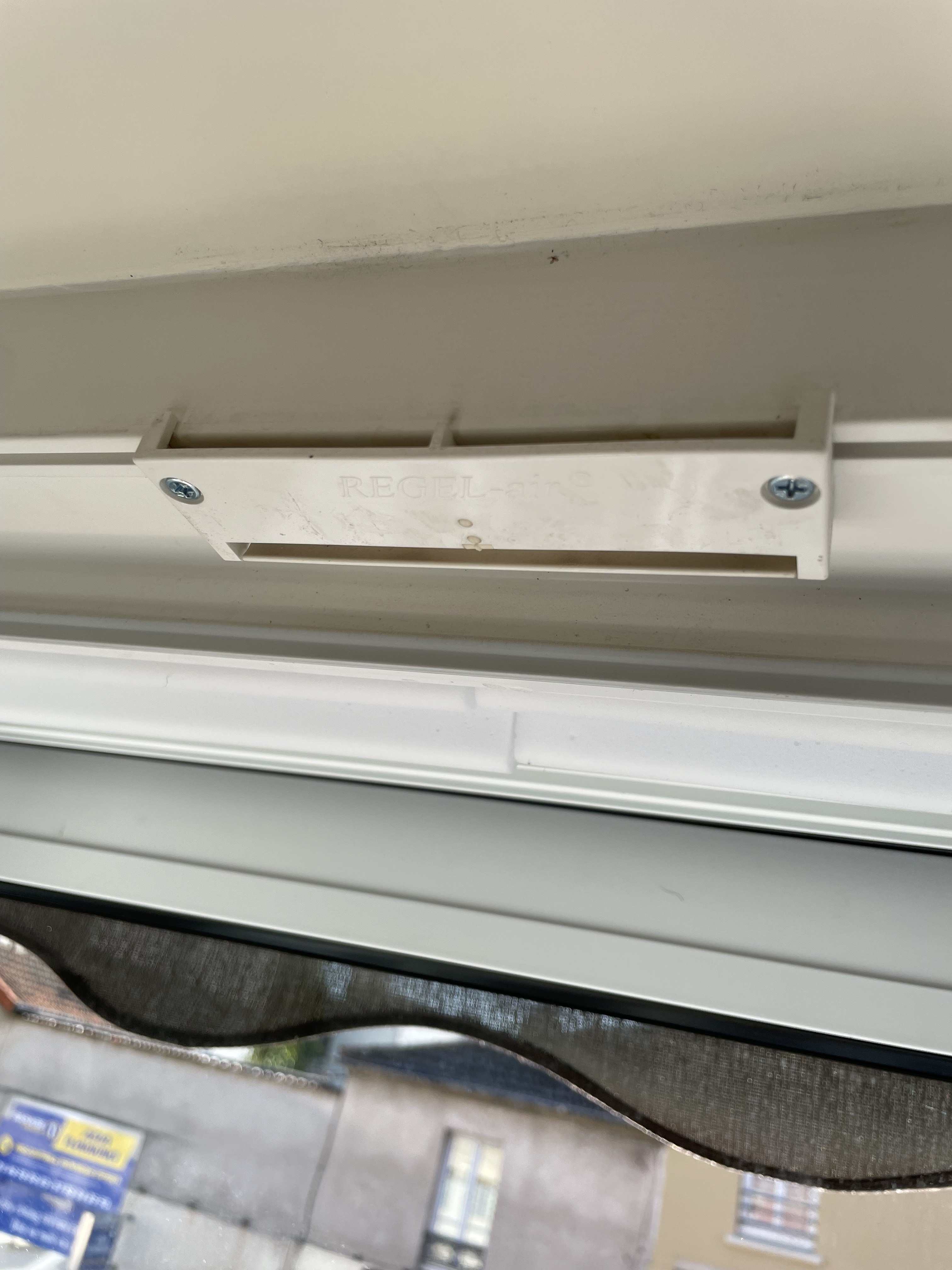

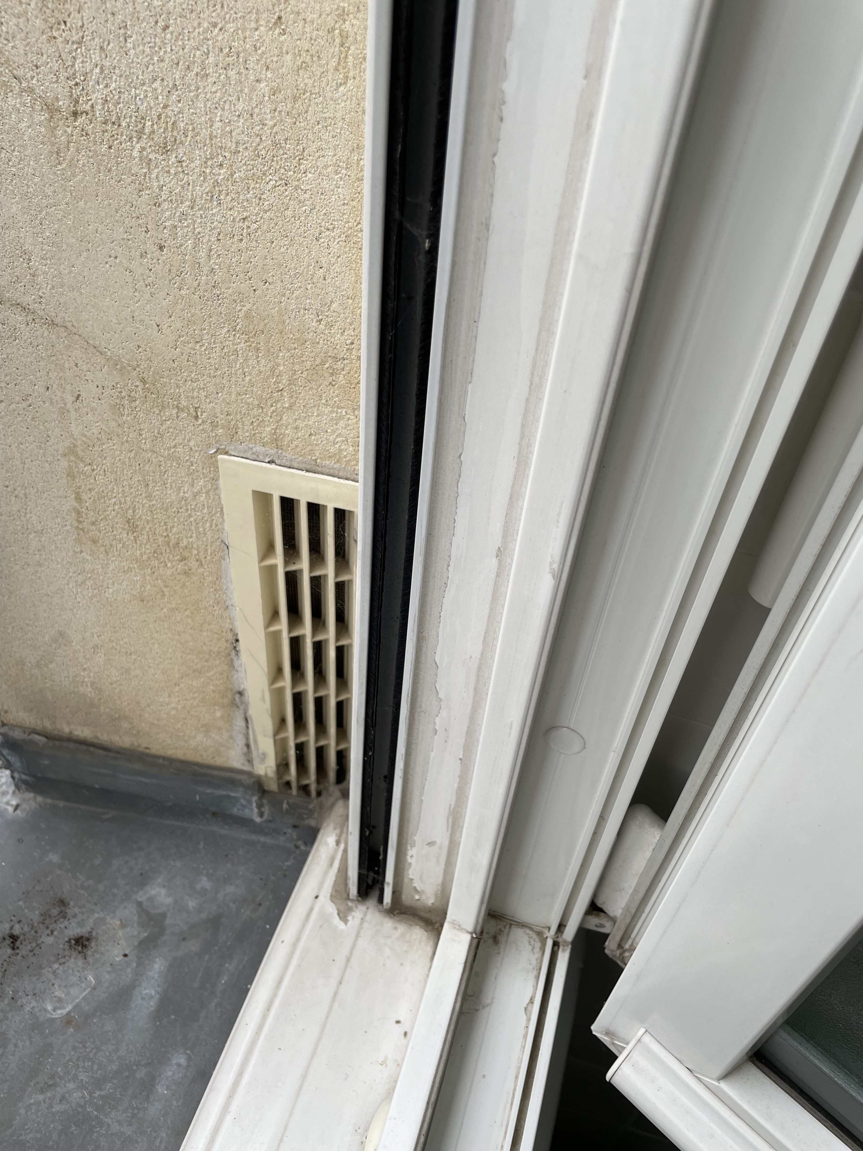

I have PIV (positive-input ventilation). What I keep calling 'outlets' is what I would have expected to look like "window trickle vents", except I cannot find any! The air being gently pumped into the building has to leave *somewhere*.
Edited by Garald
You may not have any.
We also have 'air bricks', usually under a floor, for ventilation.

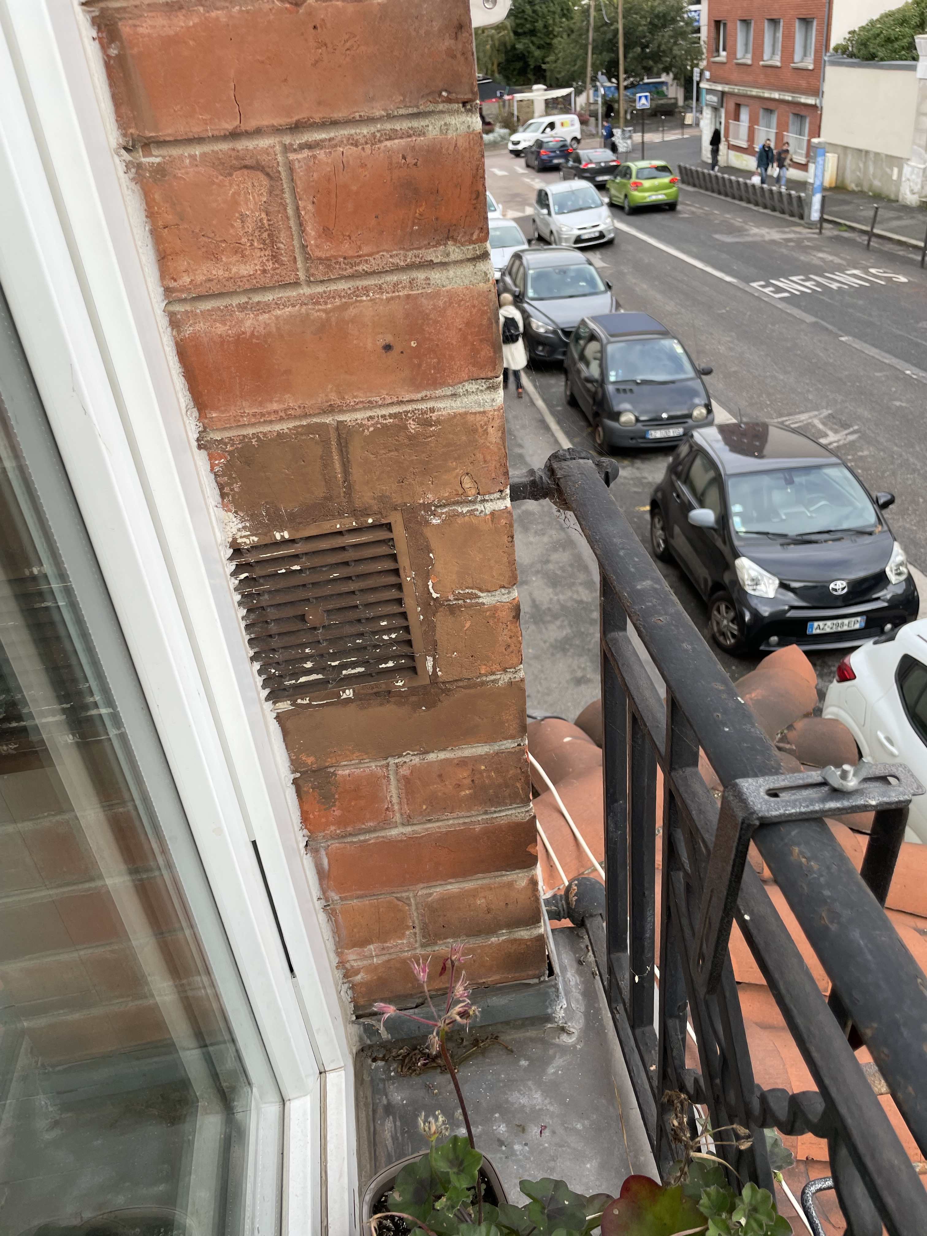

Here is what one can find outside the kitchen window and a bathroom window (and nowhere else AFAIK). I think these vents were already there before the renovations. I have no idea if whether they are still active or of how they would work.
A visiting ventilation guy couldn't find the ventilation exits, but, after talking in the phone with the old contractor, I found the exits in the new windows - they are well hidden at the top:
As for the windows installed ten years ago by the previous owners - I'm not sure. Perhaps these little indentations at the top and bottom are it? There shouldn't be cobwebs, though.
Apparently I'm supposed to keep the handles of the skylights down so that there's a ventilation exit there too. Not sure what would happen during heavy rains. Also, noise comes in that way...

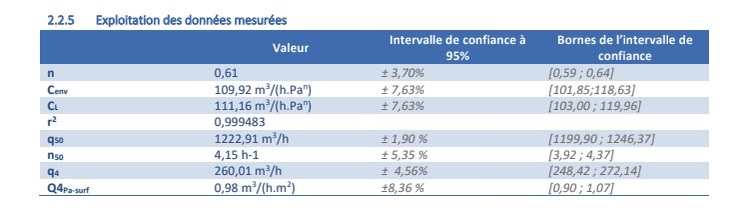

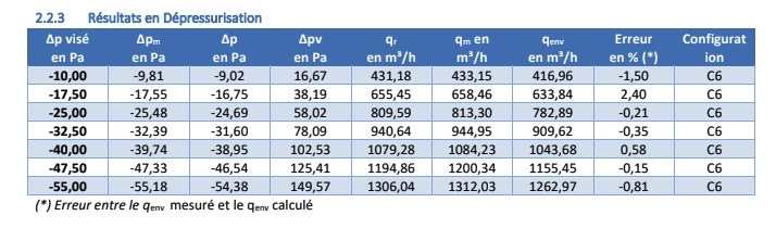

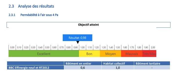

All right - the airtightness people came today with a big fan.
The overall airtightness was much better than expected (here) - right in the middle of the acceptable range for *new build*, I was told. Apparently the house scored 0.5 or 0.6... something? At however many pascals? I'll get the diagnostics soon (today I'd hope - I mean, I just sent them the second half of the payment) and post them in a new thread.

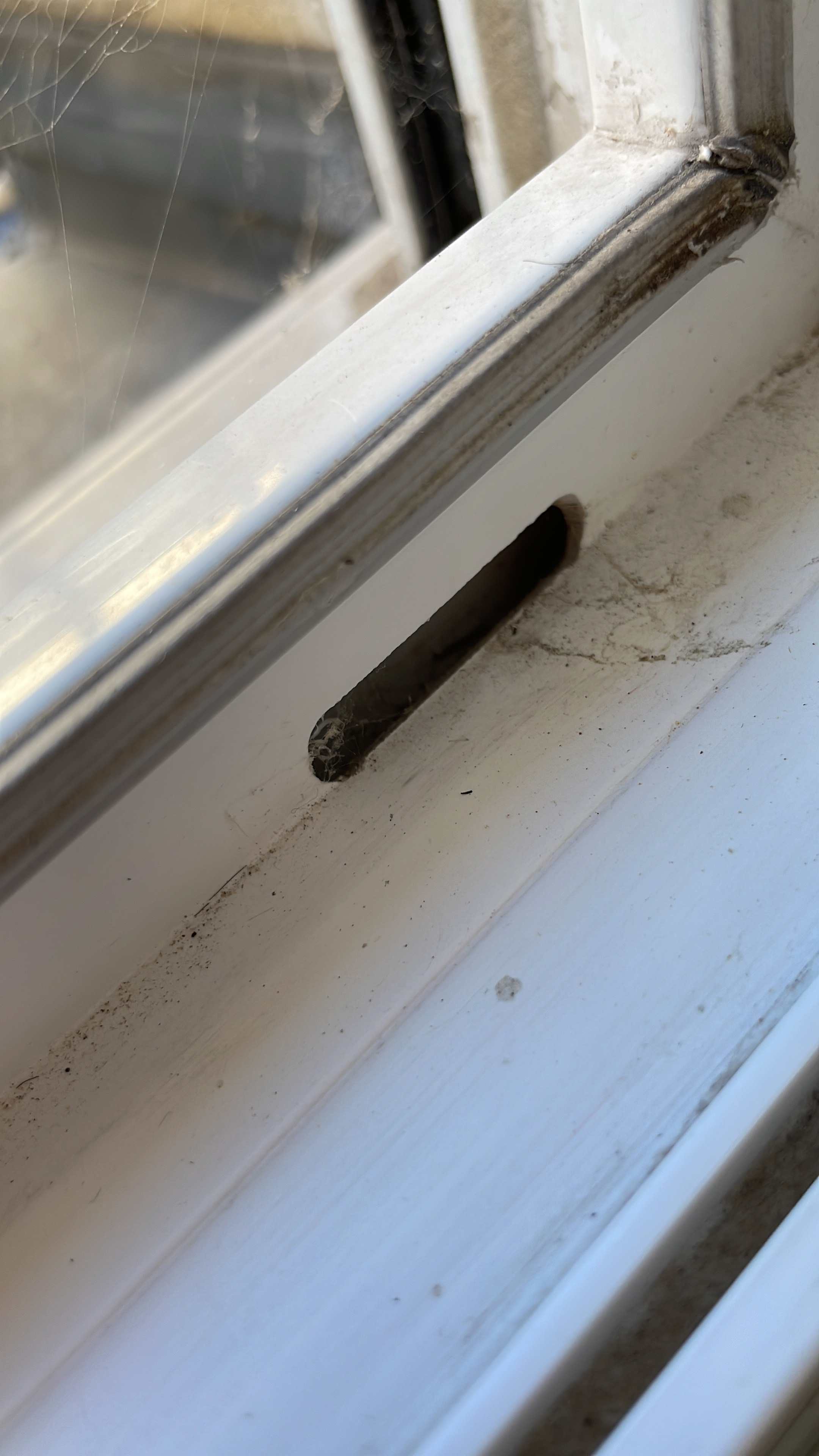

The most serious leakage come from a bedroom window that doesn't close tightly at the top (I was told to call a carpenter). There was also leakage in some odd places here and there:

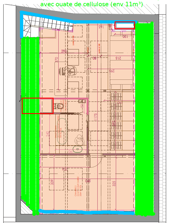

 * (this frightened me a bit) there is a small surface in the attic ceiling, hidden behind two beams, where the insulation is *completely exposed*; thank goodness it's rockwool and not fibreglass or something nastier; I'll need to cover this ASAP for many reasons;

Oh, I also was told that the attic ceiling insulation (which dates back to the former owners for the most part; I didn't have it redone completely - some rotten parts aroudn the new velux was changed by new rockwool) was thermically good but had no air barrier, and so there's airflow within the ceiling; I should be ok by sealing the weak points around joints so that doesn't leak air inside the house. The guys doing the test said that redoing the ceiling insulation up to today's standards, with an air barrier, would come at a significant cost (I knew that) and was not indispensable. I had already decided I would postpone that to the indefinite future when I do some structural work on the roof (raising it, say).
If that is the @50Pa score, it is unbelievably good for an old place.

The French new-build standard (q4) requires  ≤ 0.6 m3/h.m² at 4pa. The area used is also different from the UK test; in the UK the full area of the heated envelope is used, the French version excludes the ground floor - presumably because it's expected to be solid & non-leaking. Ignoring the difference in area and using the LABC cheat-sheet (https://www.labc.co.uk/news/dont-feel-pressurised-air-permeability-testing) that would be in the region of  2.77 to 3.28 @ 50pa. Which is still not bad, considering no particular attention was paid to the topic.
I’ve forgotten how many Pascals it was, but I was told that the leakage was half the maximum required for new build. So it sounds like it was better than the above. Hopefully I’ll get everything in writing and post.
