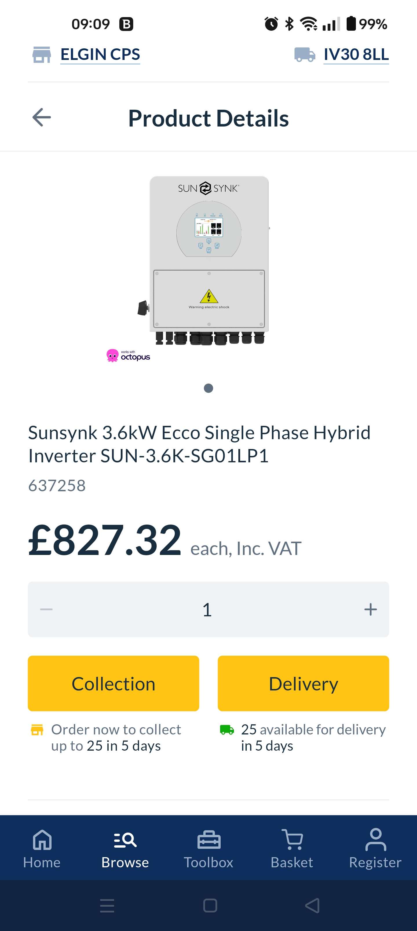

JohnMo Posted December 1, 2024 Share Posted December 1, 2024 16 minutes ago, G and J said: inverter Something like this allows just battery or battery and solar and or generator etc. so pretty flexible. That's from City Plumbing, many other similar units available depending on size you want. You would need cables etc and they would be pretty chunky. Link to comment Share on other sites More sharing options...
G and J Posted December 1, 2024 Share Posted December 1, 2024 Just now, JohnMo said: Something like this allows just battery or battery and solar and or generator etc. so pretty flexible. That's from City Plumbing, many other similar units available depending on size you want. You would need cables etc and they would be pretty chunky. So £3k (exc. vat as I’m building a new build and can claim it back) all in with battery rated at 3,500 cycles, which means it is likely it would be good for more than that, a lot more if you are lucky. Using the Nirvana figures above £3k is equivalent to 20,000kWh at 15p saving per kWh. At 16kWh per day payback that’s a ~3.5 year break even. Getting warmer. Link to comment Share on other sites More sharing options...
