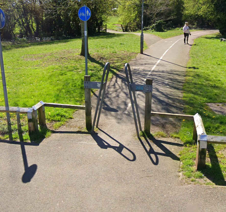

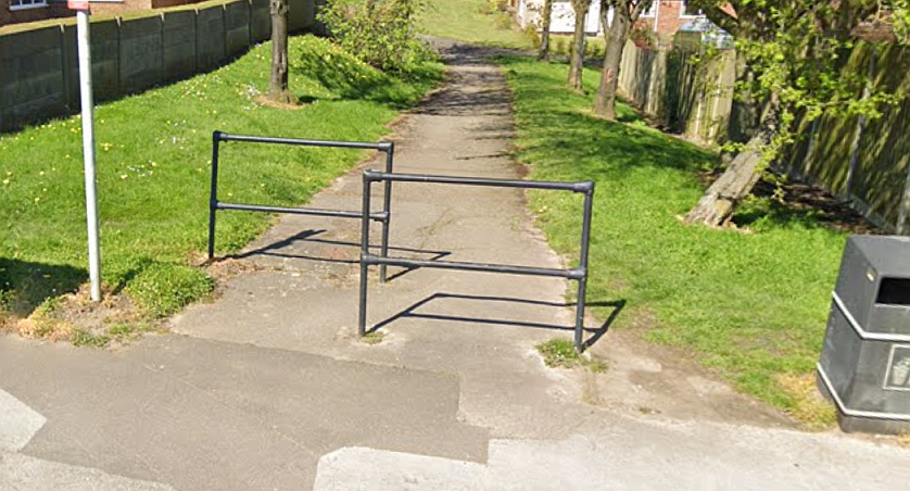

Ferdinand Posted 18 hours ago Share Posted 18 hours ago What is the best way to cut off a pipe sticking out of a surface cleanly? (Actually these are is 30 or 50 year old 2" hollow railing sticking out of the asphalt). This is what I may want to cut - a pipe constructed anti-wheelchair barrier on a local footpath. These are illegal under several areas of law, but if I put in a complaint most Councils in the country would say "yeh, we'll get onto it", then take 6 months or 5 years to schedule in the 60 minutes of work it would take. So if a competent volunteer offered to do it, what would be the best tool - clearly it needs to be cut off within a few mm of the ground - perhaps 5mm max, based on the official specifications for maximum accessible height for a drop kerb before it becomes a hazard. What is the appropriate tool and can anybody point me to one? I'm thinking either a pipe cutter, or a battery powered multitool. Cheers Ferdinand Link to comment Share on other sites More sharing options...
joe90 Posted 17 hours ago Share Posted 17 hours ago Battery angle grinder with a cutting disc (metal) and grinding disk to make flush with the ground. 1 Link to comment Share on other sites More sharing options...

Ferdinand Posted 17 hours ago Author Share Posted 17 hours ago 35 minutes ago, joe90 said: Battery angle grinder with a cutting disc (metal) and grinding disk to make flush with the ground. I'm not sure how close an angle grinder will cut to the ground; I can't risk leaving a trip hazard. I'm quite drawn to the drill bit cutting wheel type thing, like this: Link to comment Share on other sites More sharing options...

SteamyTea Posted 17 hours ago Share Posted 17 hours ago 1 minute ago, Ferdinand said: not sure how close an angle grinder will cut to the ground; I can't risk leaving a trip hazard It can cut it off at below ground level if you want. Can always take a sanding disk with you to grind it flush. 1 Link to comment Share on other sites More sharing options...
joe90 Posted 16 hours ago Share Posted 16 hours ago A 4inch angle grinder(at an angle) will cut it off within 10mm, then grinding disk to remove till flush. i sm not sure the above drill attachment will have the grunt, angle grinders spin far faster and are made for cutting hard stuff. 1 Link to comment Share on other sites More sharing options...
SteamyTea Posted 16 hours ago Share Posted 16 hours ago (edited) 12 minutes ago, joe90 said: cutting hard stuff Only with the correct disk. Make sure it is a metal cutting one, a stone one will just make a lot of noise. It is illegal to damage others properly, and I doubt that any council would give permission for this to happen. Letter to local MP and get the local TV involved. They are desperate for local news, they even filmed us at work recently. Edited 16 hours ago by SteamyTea 1 Link to comment Share on other sites More sharing options...

Mr Punter Posted 15 hours ago Share Posted 15 hours ago Without consent from the Council you risk prosecution for criminal damage. The top photo looks like a wheelchair could get through. With the bottom one it may be better to just remove the timber rail from the left side. 1 Link to comment Share on other sites More sharing options...
Super_Paulie Posted 15 hours ago Share Posted 15 hours ago while i dont condone criminal damage, a battery reciprocator with a new long metal bit would cut that flush as the blades are supper bendy. Just sayin. 1 Link to comment Share on other sites More sharing options...

Mr Punter Posted 12 hours ago Share Posted 12 hours ago 3 hours ago, Super_Paulie said: while i dont condone criminal damage, a battery reciprocator with a new long metal bit would cut that flush as the blades are supper bendy. Just sayin. I use one for "adjusting" scaffold. Link to comment Share on other sites More sharing options...

torre Posted 11 hours ago Share Posted 11 hours ago Your first example looks like it's to protect anyone, esp children, coming from that path against running/riding straight into what is probably a road where the picture is taken from. I've plenty of sympathy for the issue of accessibility but please don't cut down something that's intended to prevent a serious accident. 1 Link to comment Share on other sites More sharing options...
